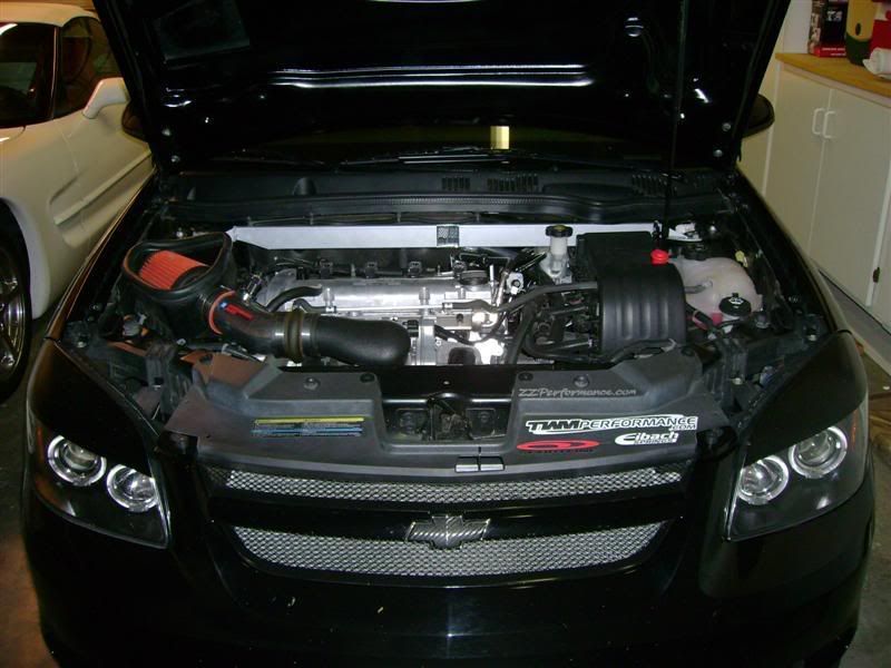

First off i would like to thank Ethan, Thurman, Dave, Chris, Crystal, Jim, Pat, Rebel Autoworx, Senior Brown and Dan for their help with the install, information and tuning of this monster
Here's a bunch of videos including idle, revving, boosting, flybys, exhaust tone etc.
I apologize for the quality, these videos were shot on my digital camera which isnt the best. If you have any questions feel free to ask.
I've recently added the LSJ throttle body onto the supercharger. With a bit of wiring swapping we were able to get the LSJ TB to work on the 2.4. Here's some videos. Enjoy!
p.s. one of the video shows a check engine light, its due to a little issue we're having on cold startups, other than that everything runs great.
42# injectors at 80% duty (at redline) on a stock sized pulley running 9psi. Mods include Fujita Intake, Supercharger, Motor and tranny mounts, Cobra heat Exchanger, XTC Header, ZZP Downpipe, Magnaflow Catback, shortshifter, springs, strut bar, drilled and slotted rotors, etc etc etc.
here's a before and after shot of the engine
And here's some videos
