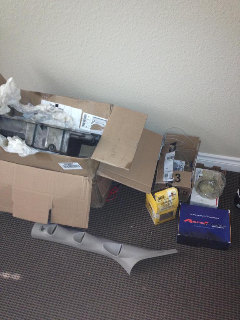

finally getting a good amount of parts accumulating

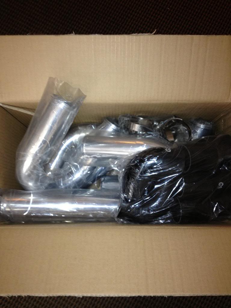

ebay/godspeed charge piping kit

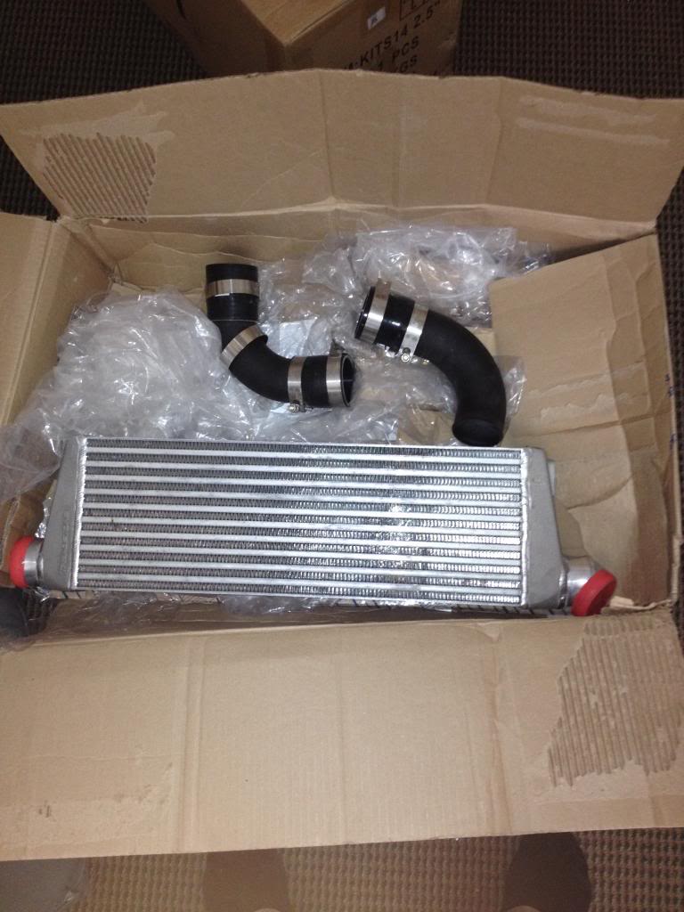

I know the couplers and t bolt clamps aren't the best quality but at 8 psi I think I'll be fine. I plan on welding most of it together so I should only be using one or two of these at the max
treadstone TR8 intercooler
picked it up for a great price and it's in almost brand new condition, came with pipes, couplers, t bolts and mounting brackets!

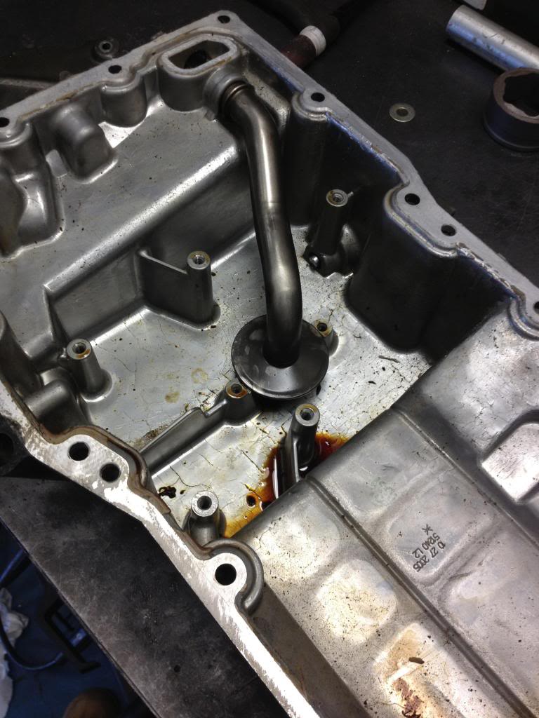

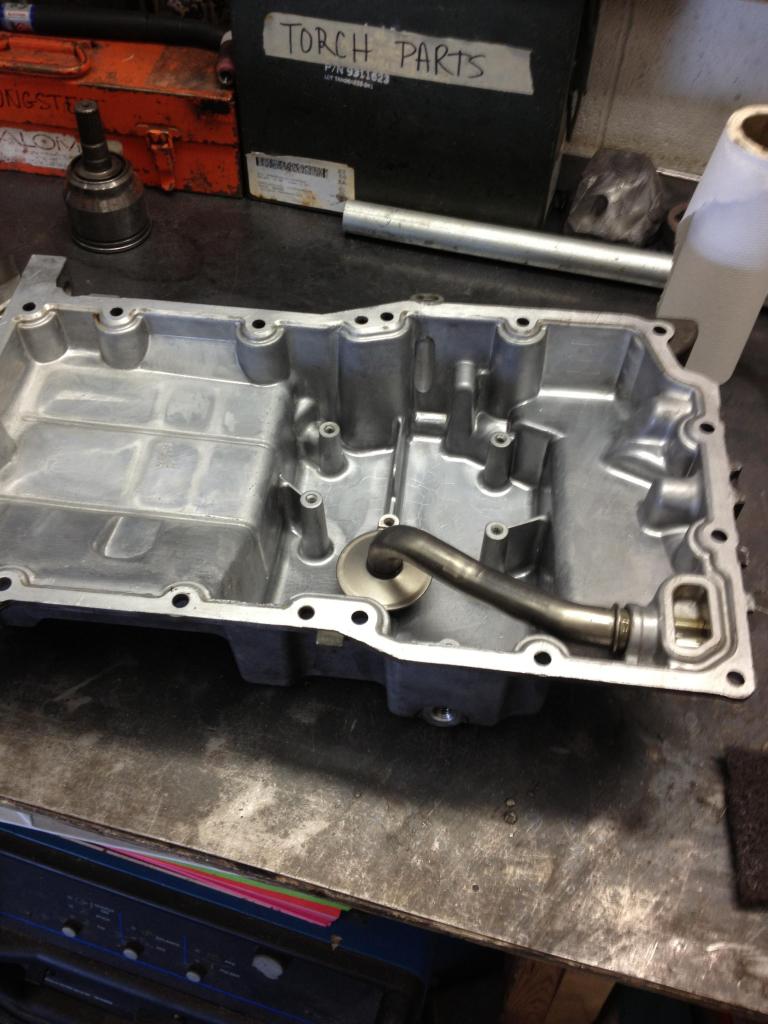

cleaned up the oil pan today, once I get my order from ZZP i'm set to weld on the oil drain bung
before
after
and this little guy came today!
matches my valve cover lol

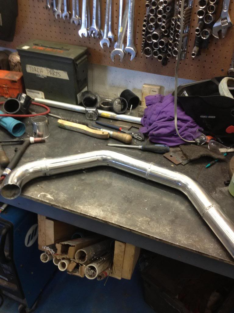

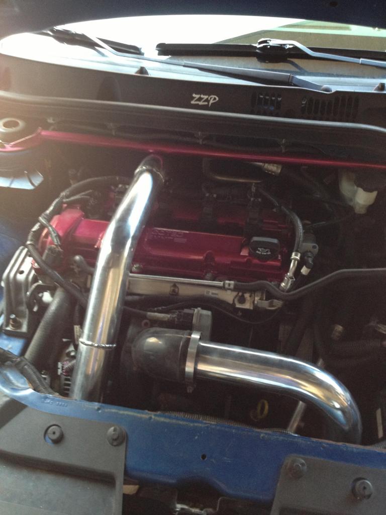

slowly getting stuff done!
did the hotside chargepipe today, just needs the turbo end finished once I know exactly where the turbo sits
waiting on the 3" for the MAF to do the cold side, just put that 2.5 there to show what it'll look like
