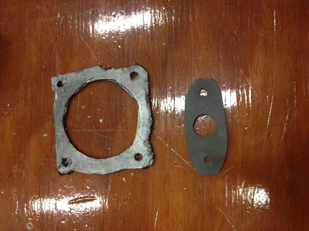

gaskets I made for turbo drain flange and vband adapter until I get my new turbine housing

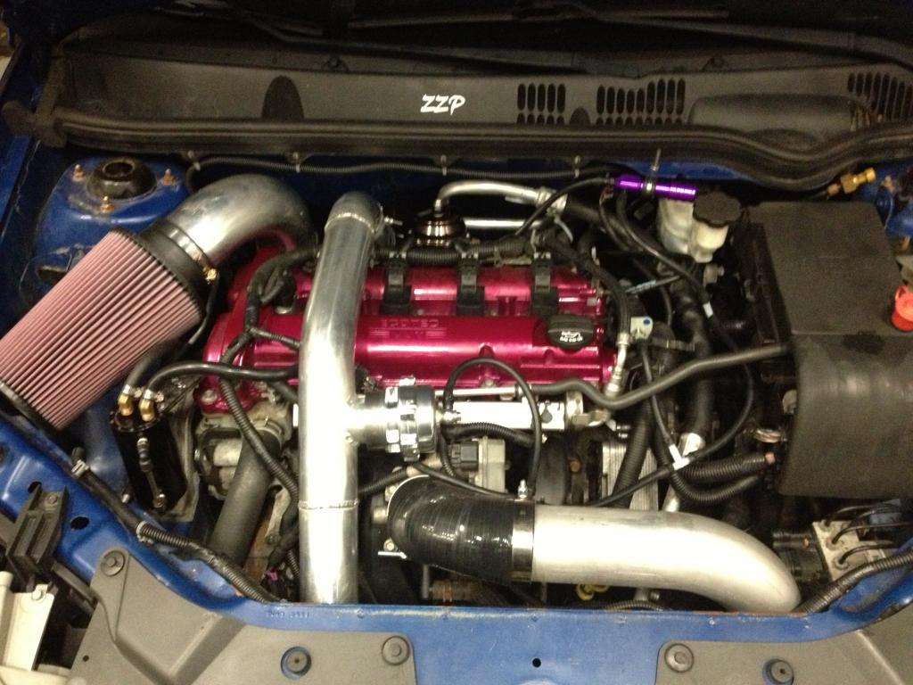

and here's what it looks like now
waiting on a gasket before I put the saab lk9 on, gonna swap the ky stage 3 in sometime over the next couple weeks and have a new turbine housing in the mail then it's officially done.......for a little while
