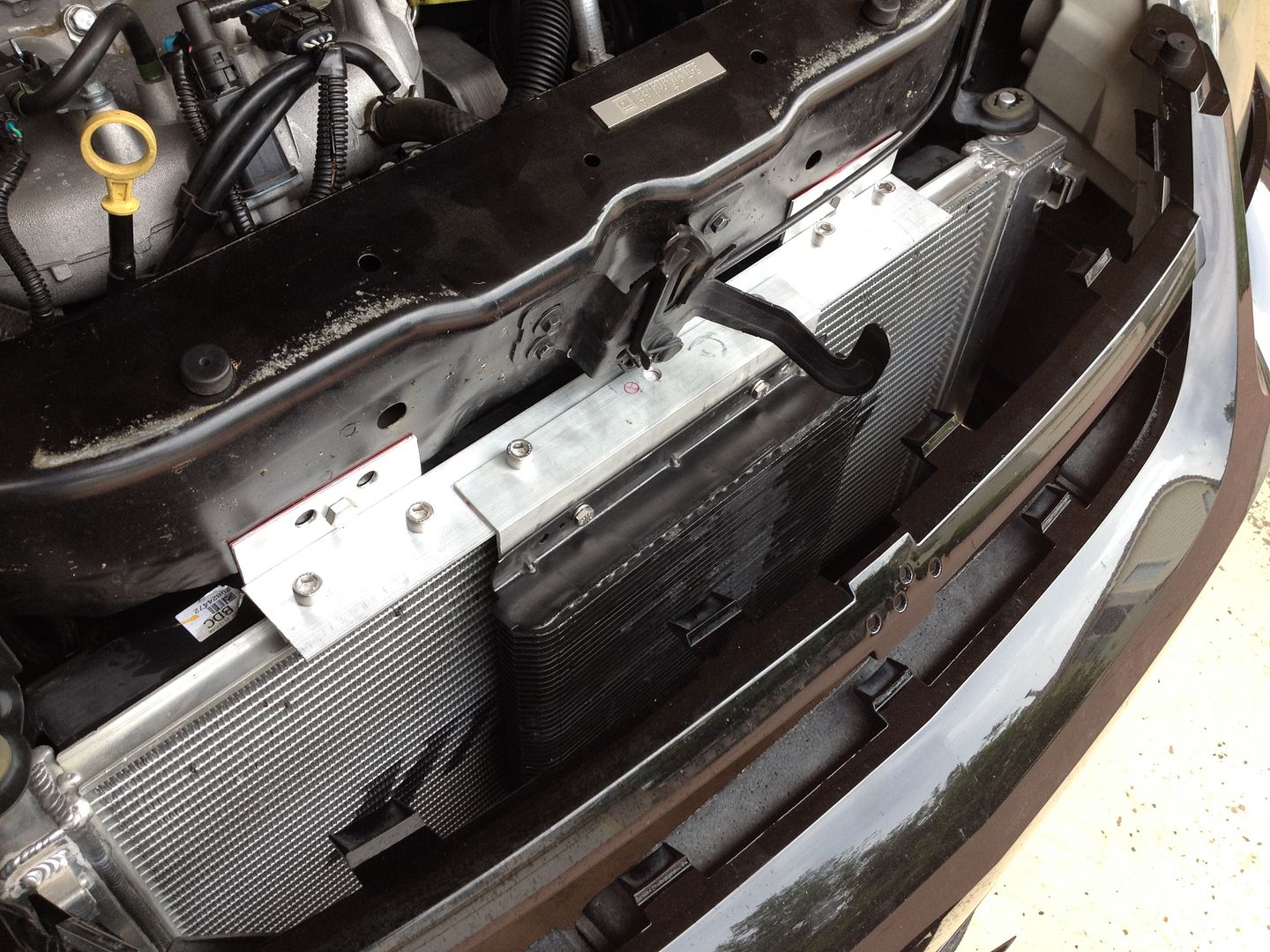

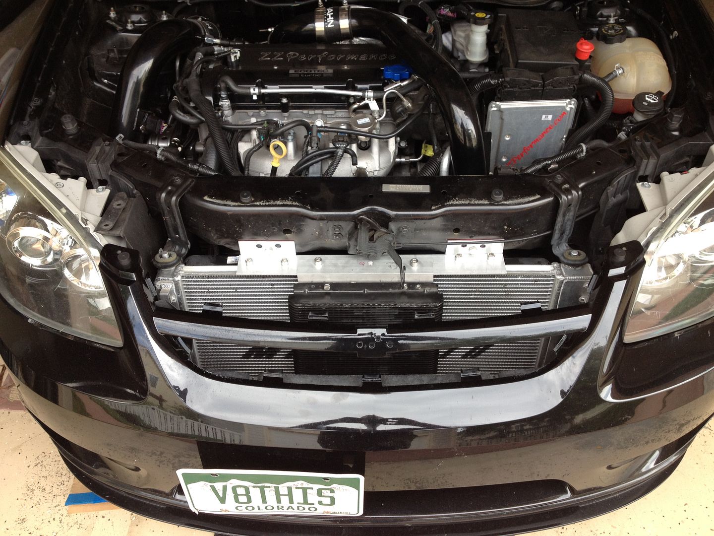

This project has been dormant for a while but we made some good progress today. The oil cooler is on the car, and a test drive to check movement and clearances with the GoPro went very well. Planning on completing the project next weekend by running the lines and installing Mr. B's flange.

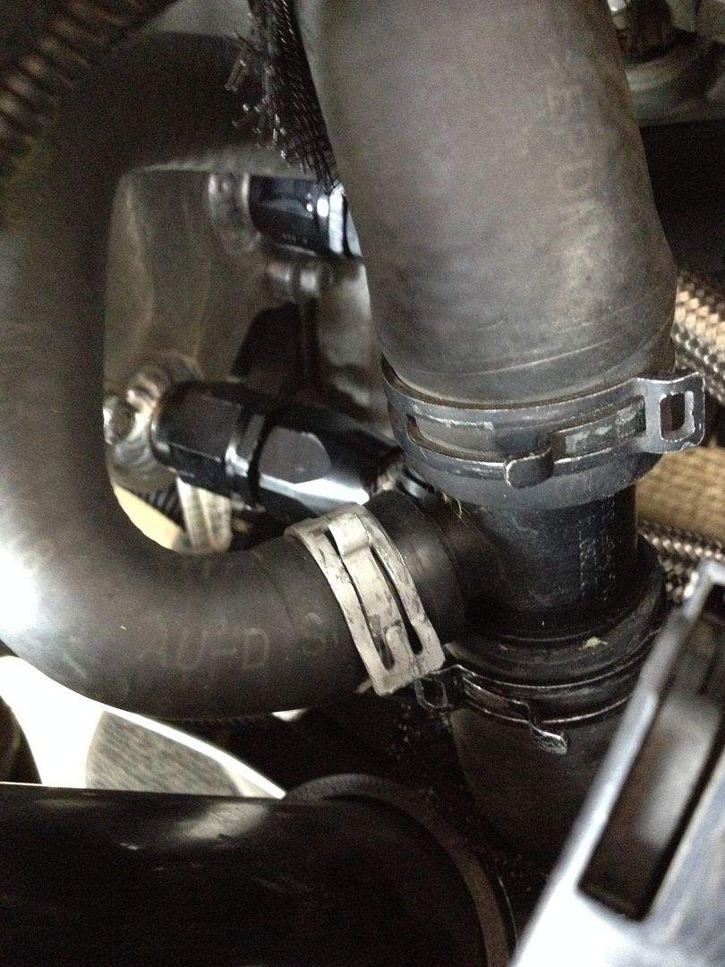

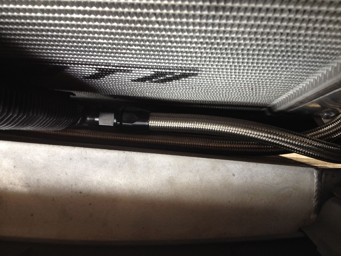

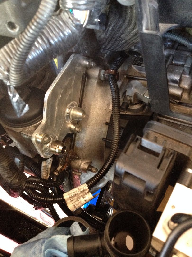

Finished up the oil cooler today!
Besides some mild and moderate driving to check for leaks or other issues we haven't really been able to do any testing on its cooling capabilities yet.

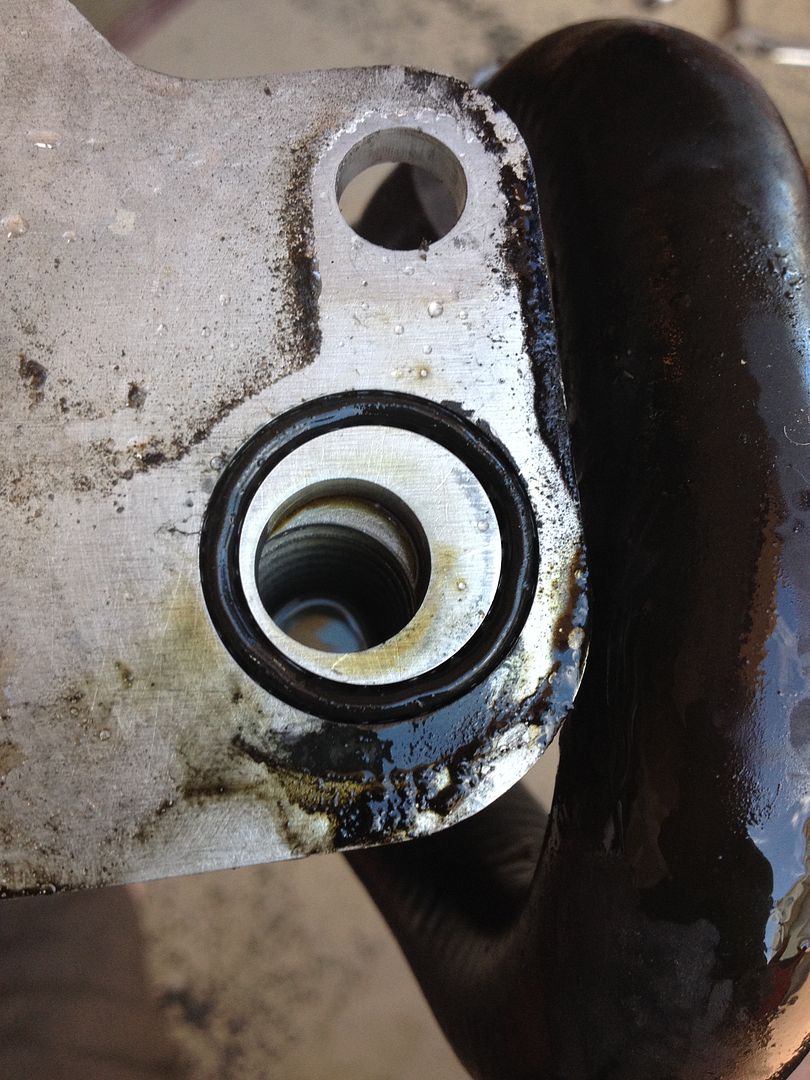

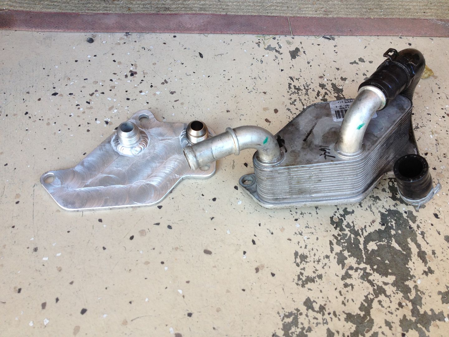

Stock oil cooler/heat exchanger vs. Mr B custom flange:
Oil ports of the stock oil cooler. GM tolerances: "close enough". Can we get a recall on that? lol
Looks so clean with the custom flange installed! And so much space! I can actually see my 4.45 tranny now
The hoses really firmed up the position of the cooler. Where it wobbled a bit at the bottom before, it is rock solid now. Doesn't hit the radiator nor the intercooler. Fits perfectly!
The AN lines coming out of the custom flange. It looks stock!
I'll report about results once I get a chance to really heat 'er up at the track.
Special thanks goes to ECaulk for his tireless custom fabbing mounting brackets and AN lines and sacrificing several weekend days to this project, and to Mr. Belvedere for supplying the awesome custom flange that made this all possible. You guys make me look good

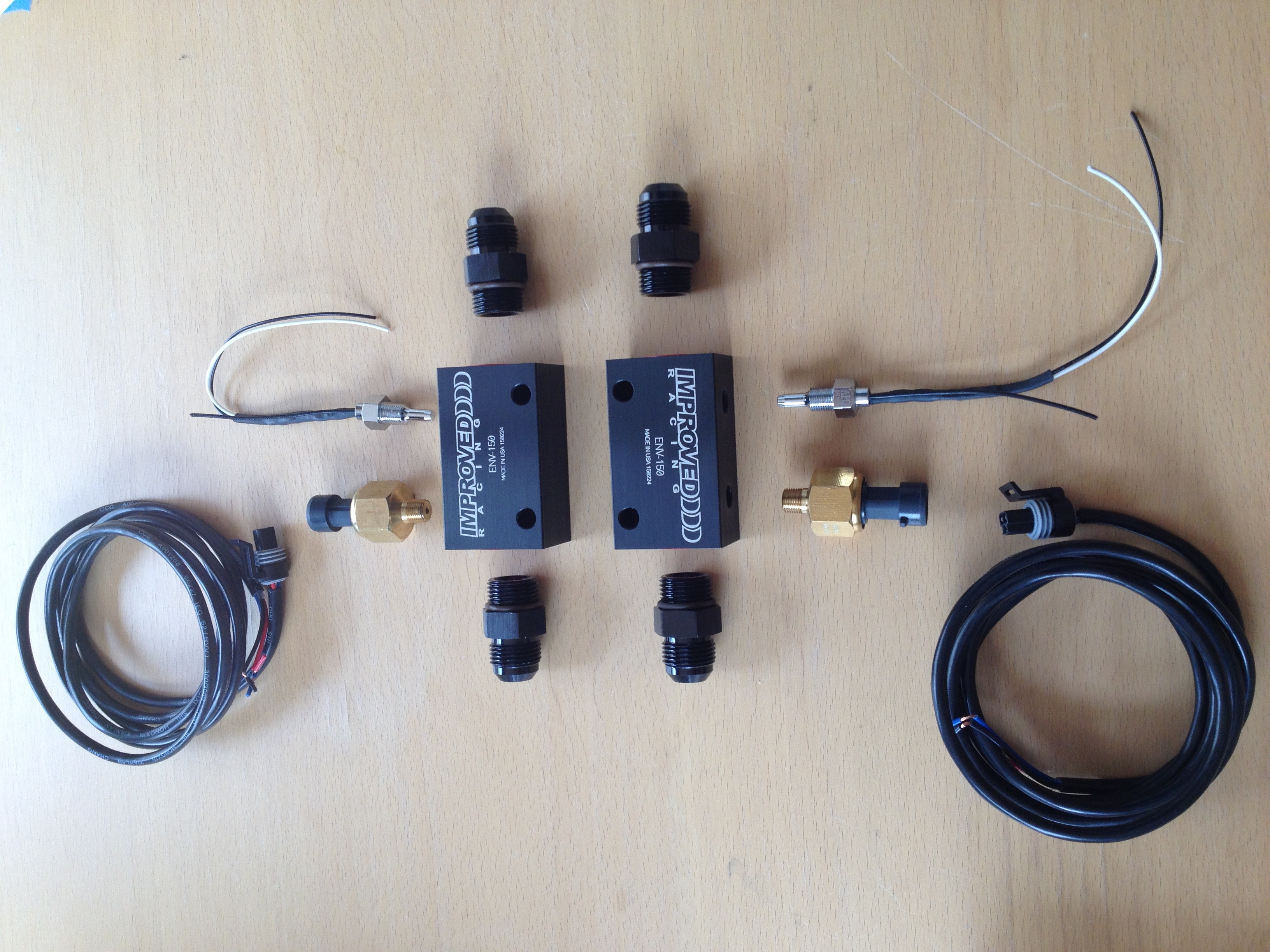

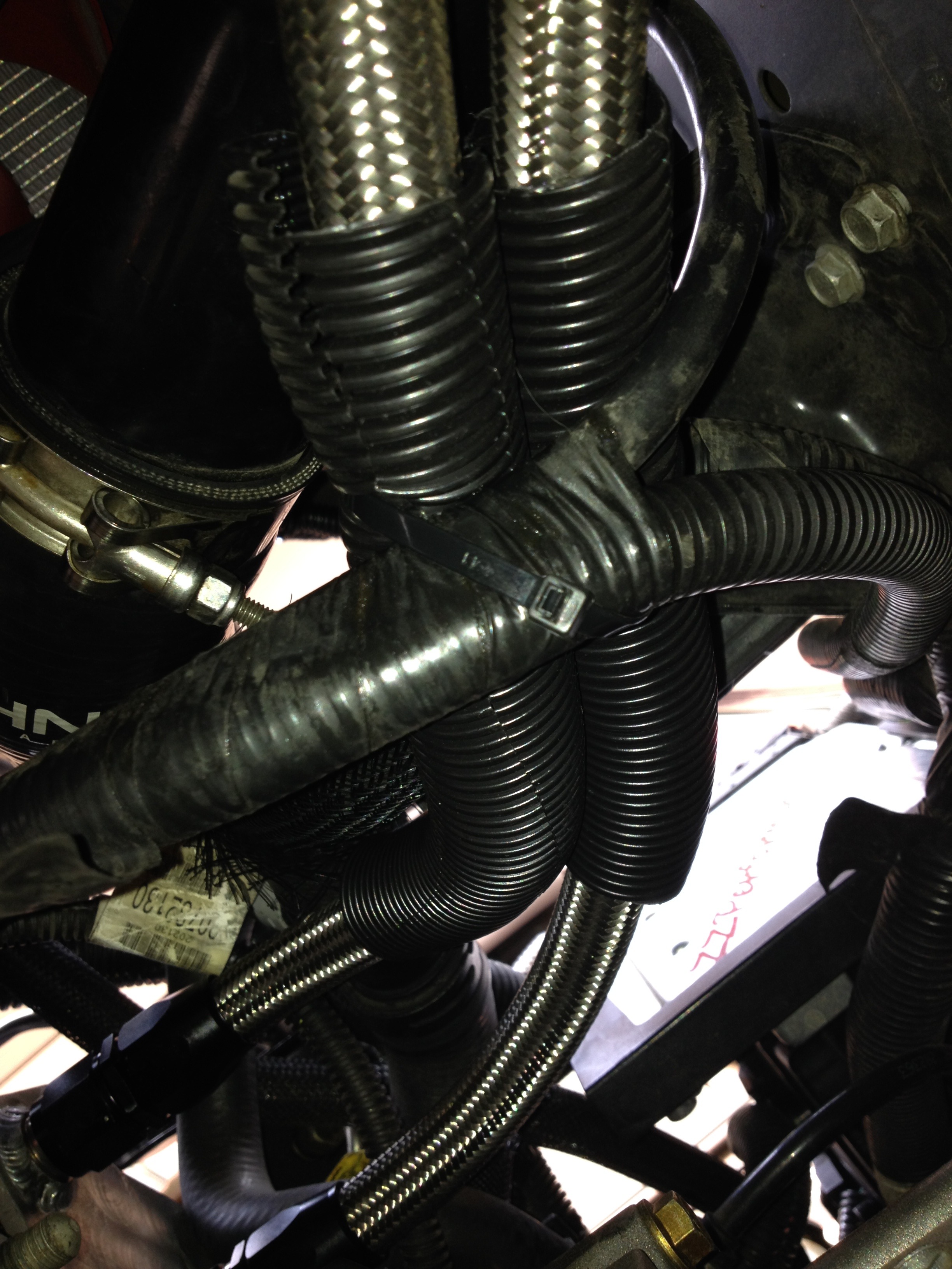

Got some large diameter flex tubing to put on the oil cooler lines where they may rub against something. Also ordered a couple inline oil sensor manifolds so we can measure oil temperature and oil pressure pre and post cooler.

Update: I have 2 sets of oil temperature and oil pressure sensors on its way to be installed in the manifolds pictured above.
Plan is to put in some runs at the track to measure the effectiveness of the oil cooler. If it does not do what it needs to, the next step would be to mount one size bigger cooler, which is already chilling in my garage

Got all the parts in to measure oil temperature and pressure pre and post oil cooler.
Now to install it and wire it up, and go log it at the track
