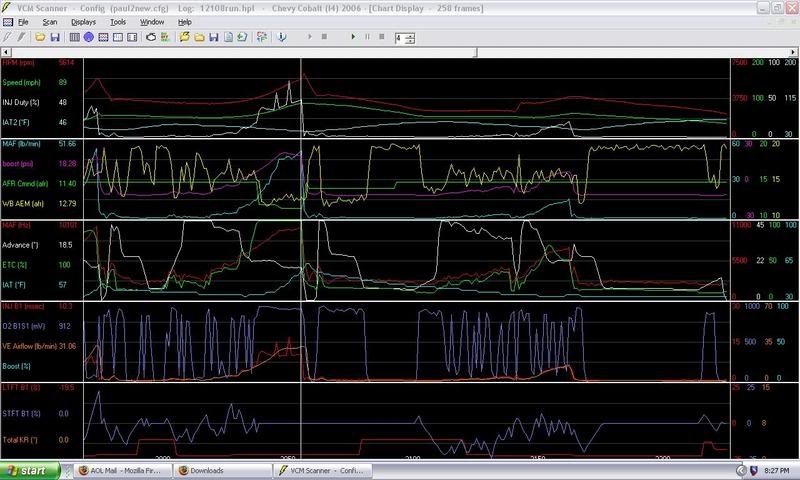

yeah that's what I picked up too, exedy ftw lol. I just need to do something asap with the fuel situation. I'm hitting crazy IDC's and my car is just all over the place with fueling, no matter what I change in the tune, or anything it always does the same thing at 22 psi, so I'm running 19 right now, but since the clutch is slipping I really can't get any accurate numbers, also that could be why my car does what it does, but we will soon find out once the new clutch is in.

revelations hit me. your wacky idc is an issue between maf and pe.

yup, 2.5" piping is f'in up my maf output freq, hence why the high numbers, there;s a lot of turbulance in there, you can actually hear it under boost. But will all be fixed in the next few days, car is getting gutted and pretty much totally redone.

i was also shown the light in pe tweaking. the car doesn't like straight lines in trying to maintain a steady afr
look at your afr actual in reference to your commanded

yeah I know, the curve is usually a little spikey, this log run is from my first pulls with the new turbo in and pretty much untuned. I haven't had time to try and dial it in lately, and since everything is getting completely redone, I'm not gonna bother, plus I won't really be driving it much once I pick up the jeep. but I do want to get it ready to run at the track march 1st, so I'm going to need to put a lot of miles on it and a lot of dyno time.

How can u figure its the maf and pe...there is no hz logged for the maf...only lb/min which isnt calculated until after it receives the hz reading and goes thru the maf calibration table.
And what is this straight line pe **** u talk about...pauls car has the same problems as mine...spill it or ban.

the HZ actually stays pretty good, but I had to play with the maf output vs freq to get the car to somewhat run right, hence the high maf lb min reading compared to the VE reading. Won't have to worry about it soon though.

I meant u cant see maf turbulence unless u have the hz up...if the curves are smooth there is no turbulence
look at the afr actual vs cmnd.
the maf stays set at a pre-determined setting. then the pe is changed according to the air flow so to speak. forced induction isn't a straight line.

The commanded vs actual only shows the failing of the injectors to fire for the proper time and their result on the af...which makes it go lean. also pe isnt based on airflow..its based on rpm

air flow does play a role in how pe is added in said percentage. a 2.7 car is flowing "more air" than a 2.8 car. so, a person adds fuel in the pe side to go with this. or maf settings, either one.
everyone has different tuning styles. air flow is not linear
