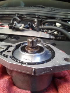

Originally Posted by ItalianJoe1
Yeah clock it properly and you should be good. Two bolts to loosen up the housing, turn the hex to the right position, and pop it back in.
<a href=http://s670.photobucket.com/albums/vv64/rcorona8/?action=view&current=2012-07-17204927.jpg target=_blank><img src=http://i670.photobucket.com/albums/vv64/rcorona8/2012-07-17204927.jpg border=0 alt=></a>
Like this? After I installed it, I manage to stick my index finger and touch the notch to see if it was still in position and it was...

look at this picture.....line the notch on the crank pully up with the mark on the front cover.....that should be tdc cylinder 4 on the compression stroke. see, picture.
then line the notches on the camshaft sensor up and install, see picture.
