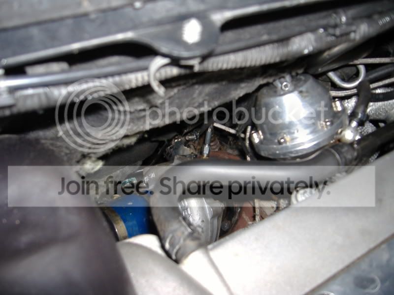

there's is where i put my fitting for my oil feeding

cant really tell where tht is from the pic but u dont need all tht mess of adapters, there is one from summit that fits.
MOST plugs on the cobalt will have restricted flow, u need to find the ones that dont. i tried to find a diagram or something but couldnt. i kno someone on here has one tho.

I have mine on the blue circle and don't run a restrictor. Had it this way all summer.

there's the same that I took, check on the pics
what kind of turbo you run? I have a t4

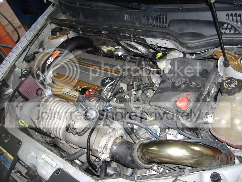

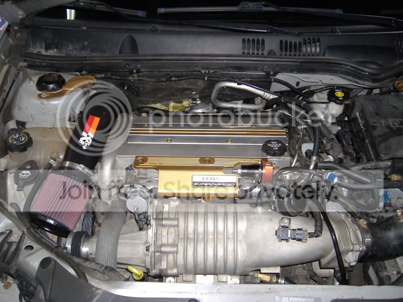

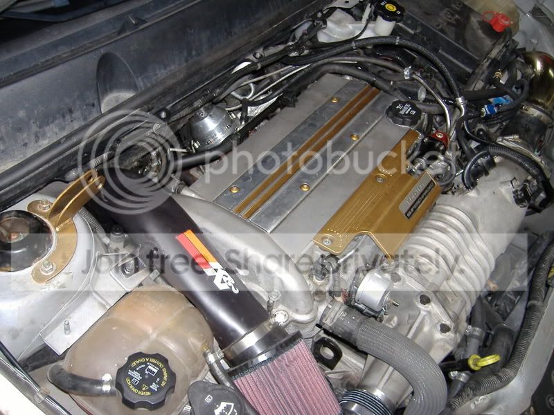

You might want to move the breather line that goes from the valve cover to the pipe just before the supercharger. It should be in the intake before the turbo. Since the place where you have it is now pressurized, by the turbo, you are pressurizing the crankcase every time you are under boost, which might be the cause of your oil consumption. At least it looks like it is still in the stock location by the pictures you have posted. Just my theory
I didn't think about this option, damn....

looks pretty sick man. Congrats. Get it on a dyno and get to a track once you get the problems ironed out. I agree about the oil filter on the valve cover. You definitely need to replace that line with a filter and cap the intercooler pipe. Sick 'balt though man!
yeah that is most likely what is going on... just run a breather off that line on the valve cover
