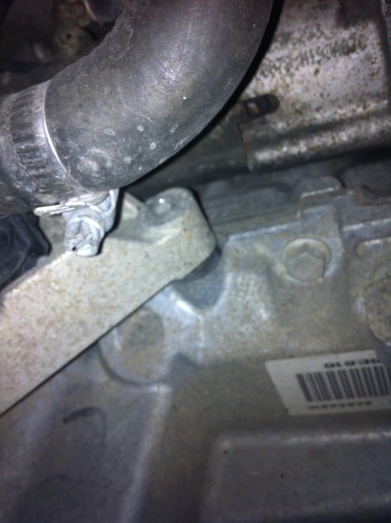

So spent the day chasing knock.
First I fix the mount for the ic pump as it was missing a bolt at the bottom so thought it might be causing some false knock which it was see pic one. Took her for a spin and the knock was better down from 9 KR to 7-6 KR.

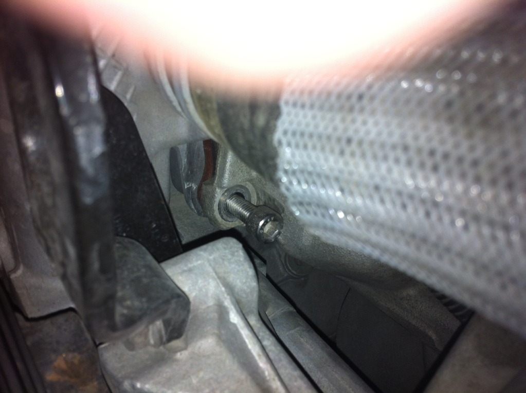

Then I was looking around and found a bolt for the intake manifold had backed out completly see pic 2. SOB. So I took a chance and just tightened that bolt, went for a spin still knocking but now between 5-6 kr.
So went home and took off the S/C and checked all the other IM bolts all were not very tight but not as bad as the first one. So tightend them all up and put the bitch back together and went for a spin now it only knocks wuth abot 3 kr i did have a spike of 5.9 but I hit a bump so that could be that.
