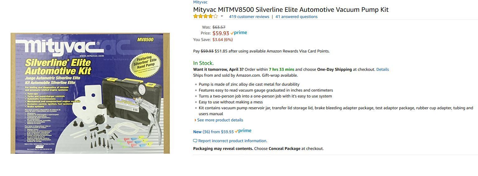

I canceled the order on the power bleeder because I didn't look close enough at what it was. Everyone in here was talking about vacuum bleeding and that power bleeder is the only product anyone shared. I orderd
Hopefully with both of these products I should be able to pull a vacuum on this damn thing.

If you can i'd cancel the Lisle one. You can just get a tub stopper from Home Depot and a bleeder nipple from Autozone and make one that works.

I canceled the power bleeder but ordered the two items I took a screenshot of. It appears to me that needing to bleed clutch lines with a vacuum isn't typical as all vacuum bleeders are advertised for power steering pumps that I could find. I figure with these two items combined I should be able to vacuum bleed anything I would ever need to so to hopefully get more use out of these tools instead of just this once.

i have a motive pressure pot bleeder, i love the thing, it makes bleeding brakes and most clutch systems so simple. however it is the wrong tool for the clutch system in the cobalts, and a number of other modern cars that have the bleed screw in the middle of the clutch feed line.
the motive vacuum pump and bleed kit are exactly what you want. it will allow you to pull a vacuum on the master cylinder, that retracts the slave cylinder and pushes the air into the line, and itll slowly work its way back to the top. these things also allow you to pull a vacuum on a bleed screw and suck the fluid through the system, so its also handy for brakes. just a word of warning, if you ever do that make sure the little cup doesnt get to full and allow brake fluid into the vacuum pump, itll destroy it.
one other thing, after you put a vacuum on the master cylinder, before you drive the car pump the brakes back up. being a shared reservoir it will suck the pistons back in the calipers.
