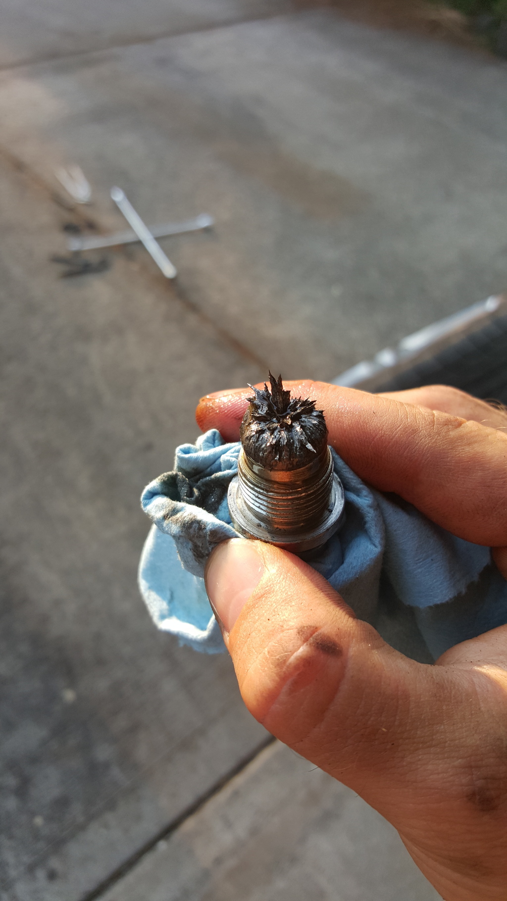

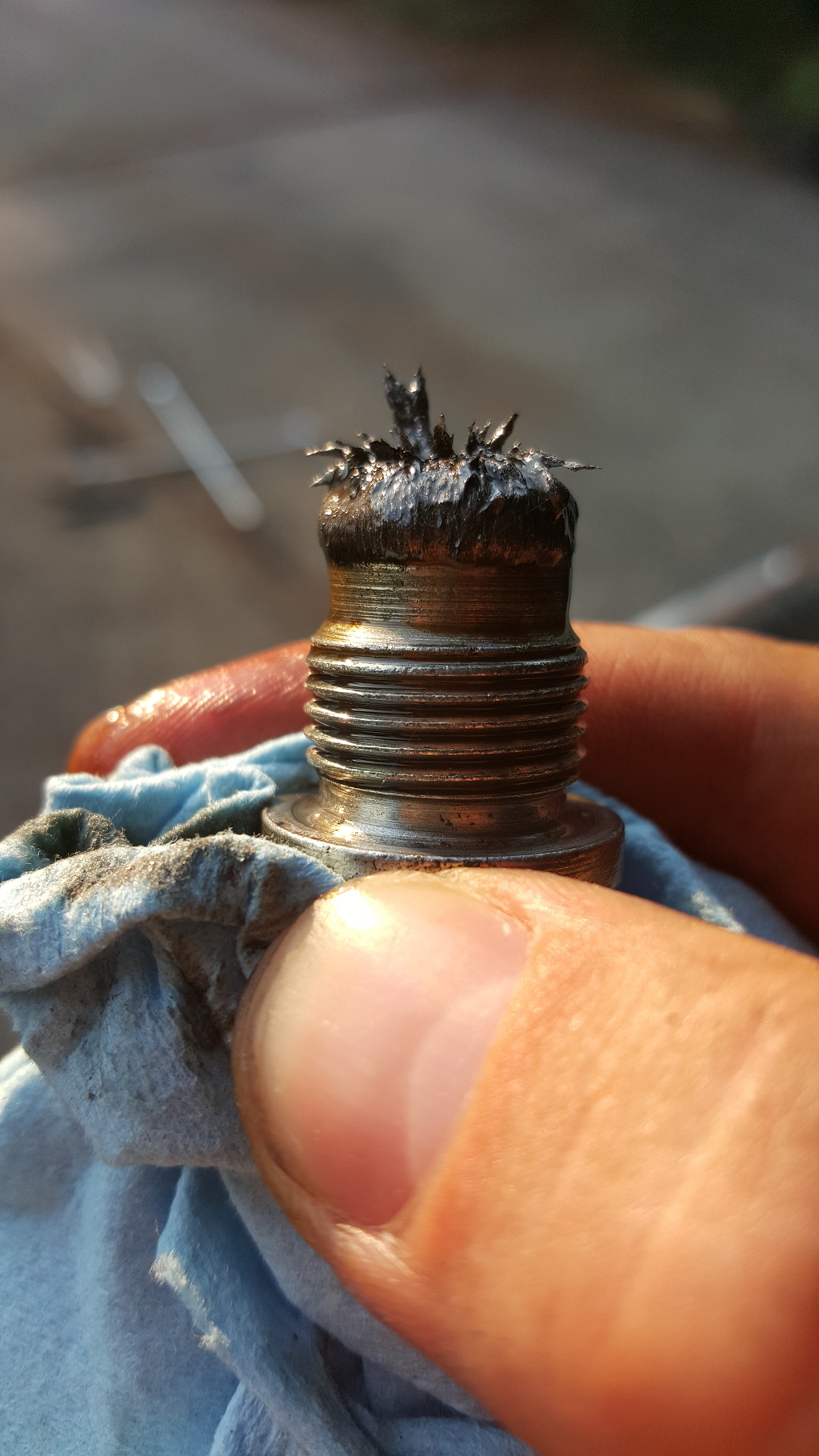

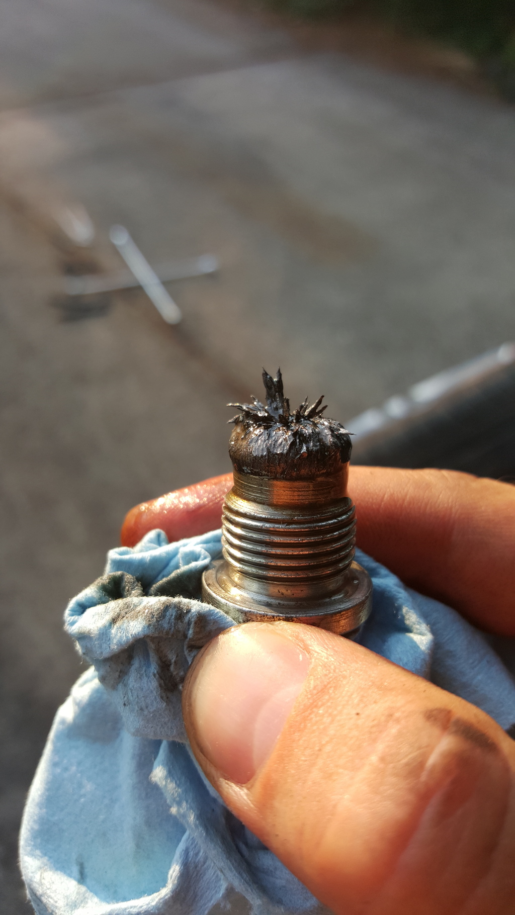

This is one year, about 12k miles of wear with Valvoline 75W-90 GL-5 gear oil. If you run GL-5 fluid, this will happen to you.

Actually thats not too crazy, you have gears wearing on each other made of magnetic iron. What you don't see is the brass that is being eaten by the GL/5 since brass is non-magnetic it won't show up on that plug

I was assumed some of that was the brass, that's makes it even scarier.

It's honestly normal if the shavings are fine, if you have large pieces (1/8" or 3mm) then be concerned. If you look at how the gears are designed you'll see there will be some metal wear due to the surface interaction. I think Blackstone does a transmission oil analysis which should tell you Cu and Zn (for those that don't know those elements make the brass alloy) which would be the best indication.

It's the copper from analysis. Ecaulk posted a link in a thread I have and it says GL-5 comes up with twice the amount of copper(I believe it's copper) but pretty much the point is that GL-5 will wear out your synchros twice as fast.
