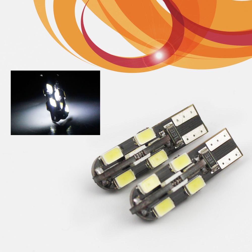

On the can bus ( error free) the resitor is built into the LED. As you can see it does not have the tine wires but a solid piece on the connection.
5W High Power Error Free T10 LED Bulbs for Car Backup Reverse Lights 912 921 920 | eBay
2 x Canbus No Error T10 168 194 2825 W5W 12 LED 5630 SMD Bulb Light White 480LM | eBay
