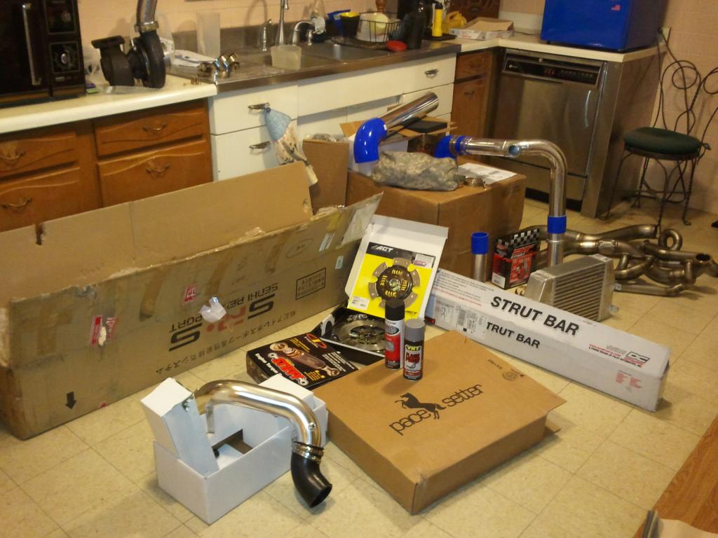

Well, almost all the parts are in, ordering three more items tomorrow. (how to properly utilize a college students kitchen)
:ignore the stuff in the background, if that projects done in time, it'll be at KC2K13:

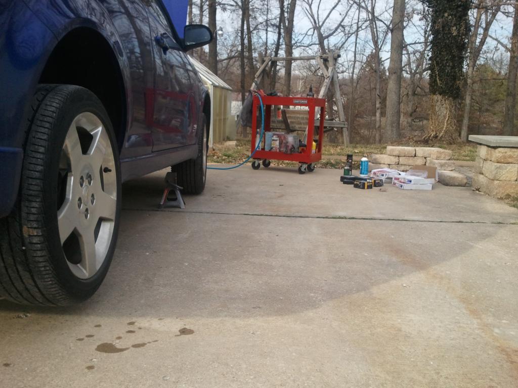

150 miles since CAI install. Reset ECM, and cleaned the MAF upon modification. Cars running good considering it needs a clutch! As well no CEL's thrown at this time.
Shortly after getting it.
Next day, I started getting all the service work done.
Will post more pix later. Kept the old intake system, even after the CAI mod. Old exhaust is going to scrap pile. Still need to do the header.

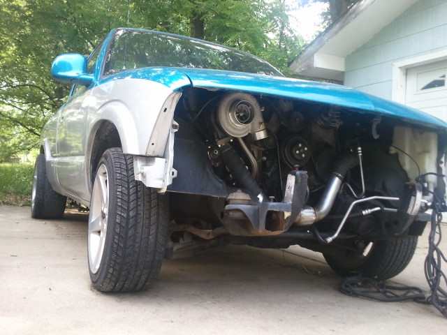

"Rotated Mounts" not sure what you're speaking about?! I have poly mount inserts I'll be doing. I'm guessing this is what you're referring to?
I was just doing these mods to make the daily driver a bit more fun! I'm giving the Lancer to my mom, her car's crapping out on her.
The mods I'm doing to the Cobalt are just to get a little more pep out of it, an make it more fun. I don't want to get to much more involved with it because I have a more intensive job at the moment I'm about to finish.
94 S10, modified 4.3/PeformaBuilt Stage 2 4L60E/8.5" rear end w/ 3.73's/full break upgrade/Methanol/custom shorty stainless headers w/ remote mount turbo (BW S300SX 66mm T4 .88AR). Just need to finish hooking up the waste gate controller, then start buttoning up the front end and getting the trans/oil/coolant lines all hooked up.
Need to meet up with my friend and get some header wrap from him to finish that small section of the hot side.
