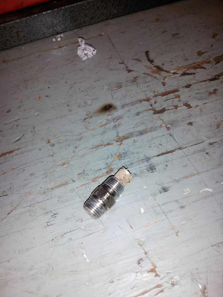

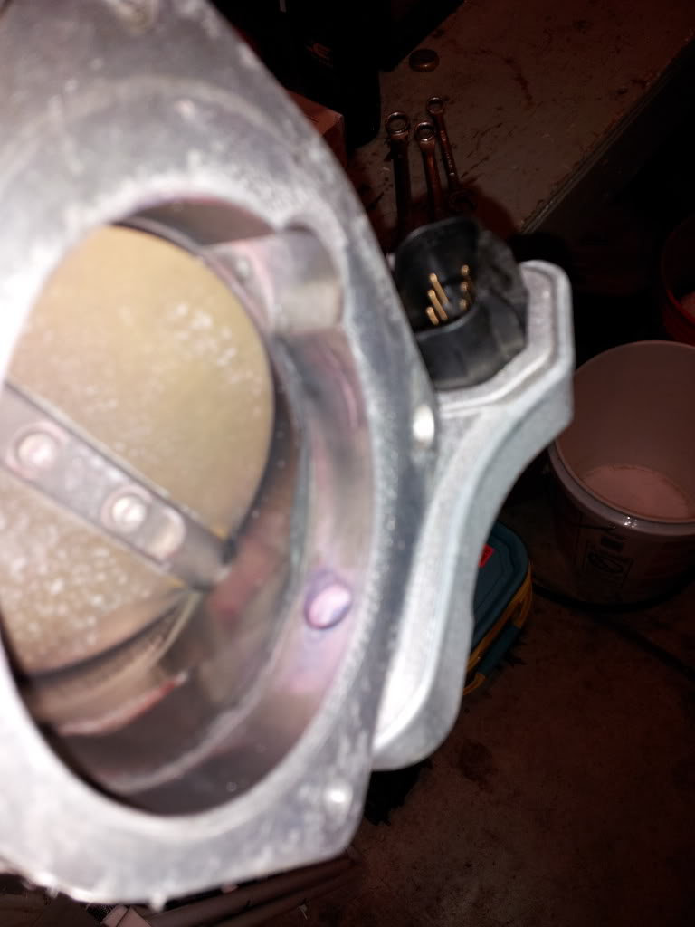

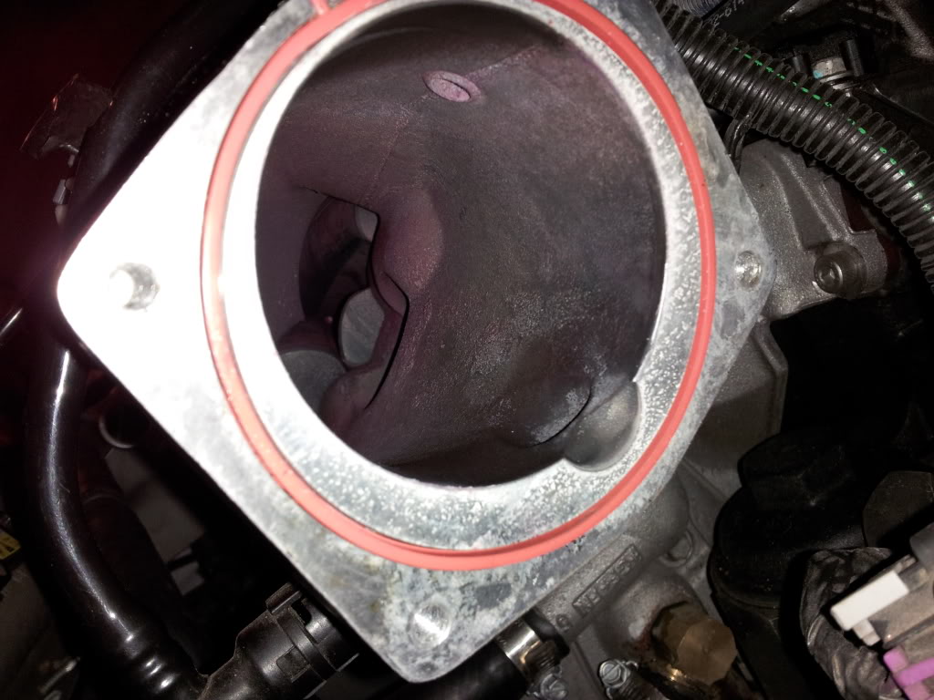

Originally Posted by 100% METH
You can purchase a low level indicator
If your really ****, just pop the cap and check the level. AIS methanol kits come with a trunk mounted 3 gallon tank.
Every oil change, clean the filter in the nozzle.
Very low maintenance
THIS!
i hadn't checked my nozzle the other day since i installed the kit back in january. it was all gunked up
a little light cleaning with a rag and some throttle body cleaner pretty much cleared it out.
overall i'm loving the meth setup. granted i spend $10 a week for the meth the cooling benefits and power are 'worth it'. if i could get e85 though id rather go that route.
all pink about it
