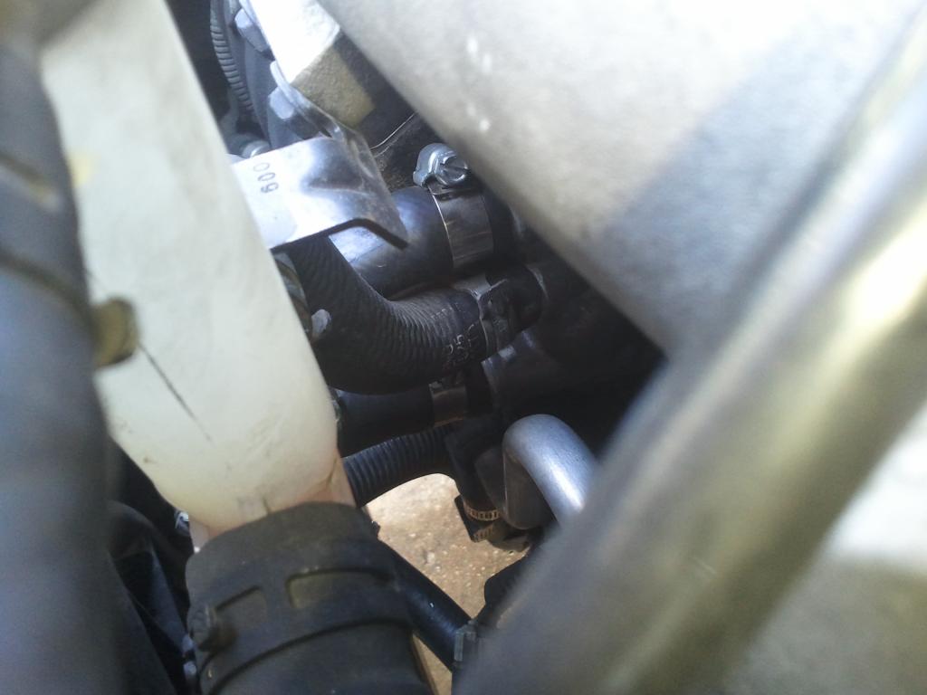

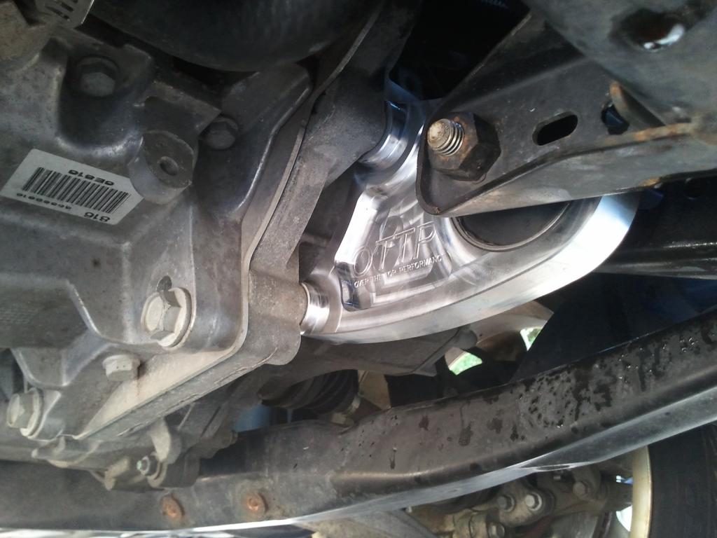

Got some work done. Still waiting on OTTP for more parts to arrive.

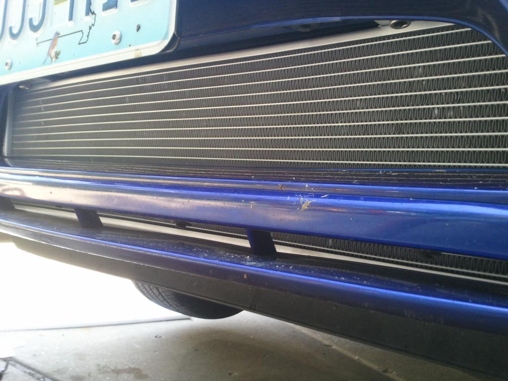

OTTP Heat Exchanger.
OTTP Front Rotated Poly Mount (Solid Bushing).

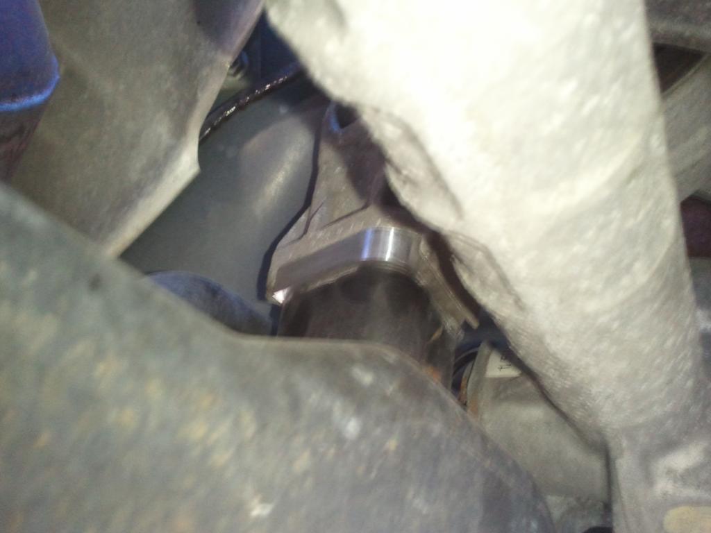

OTTP Rear Trans Alignment Shim (or whatever you call it).

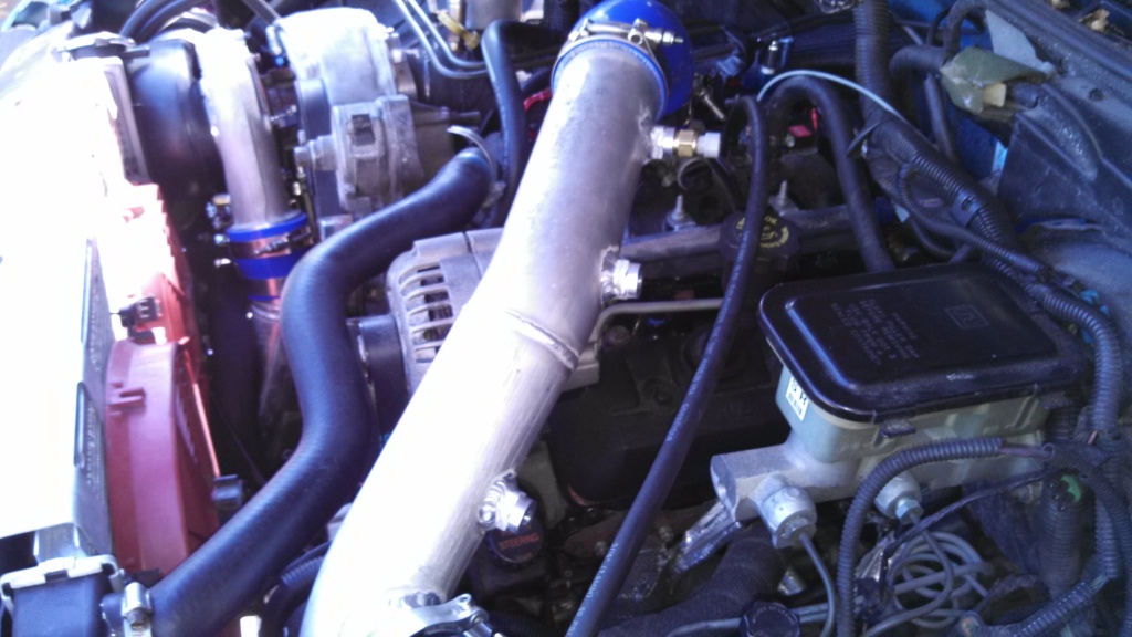

ZZP Dual Pass Intercooler Plate (as you can see, still trying to get all the air out of the system as the reservoir is low).

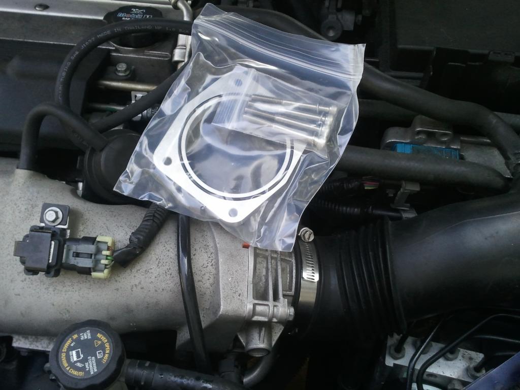

OTTP Plate w/ 1/8" NPT tap. For future mod (methanol 50/50 mix setup w/ progressive MAF controller left over from S10 project).

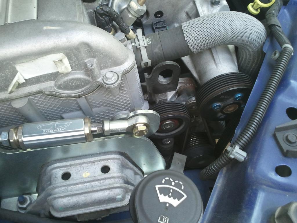

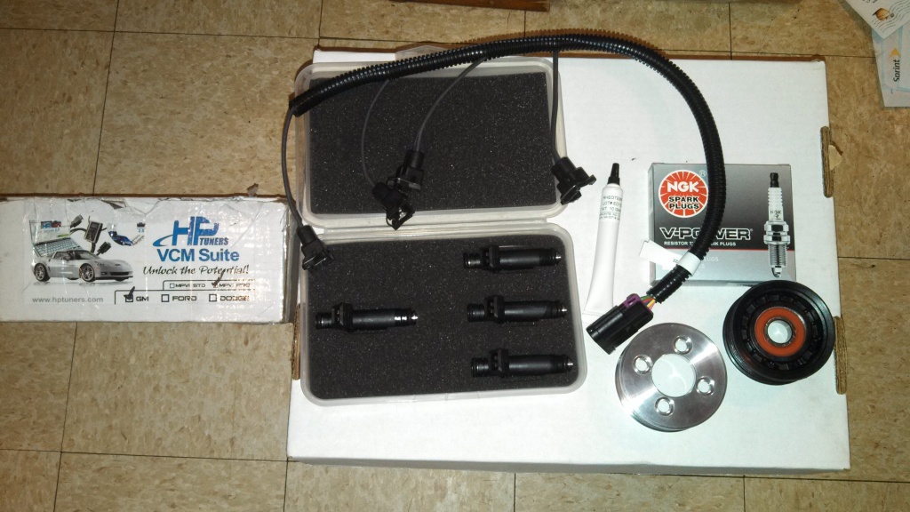

Ingalls Torque Dampener and GMS2 setup (waiting on 2.9" pulley, wont install till I get HPTuners for the Cobalt/S10).

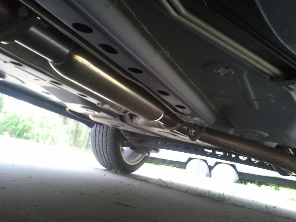

SRS 2 1/2" exhaust I installed earlier this spring. Waiting on OTTP for the down pipe to put the ceramic coated Pacesetter header on.

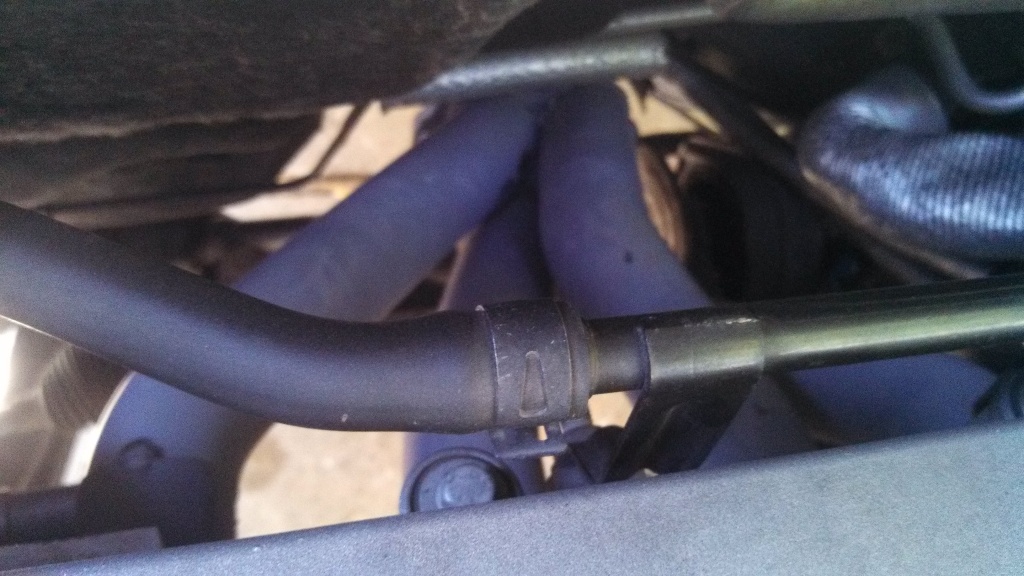

Ceramic coated the Pacesetter and had it baked. It's holding pretty well thus far. For under $200 it's not a bad buy at all (price including header/shipping/ceramic paint/paint stripper/other materials/baking process at local shop).

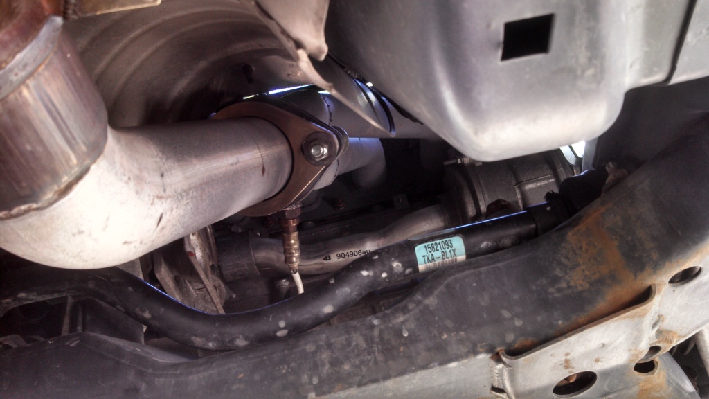

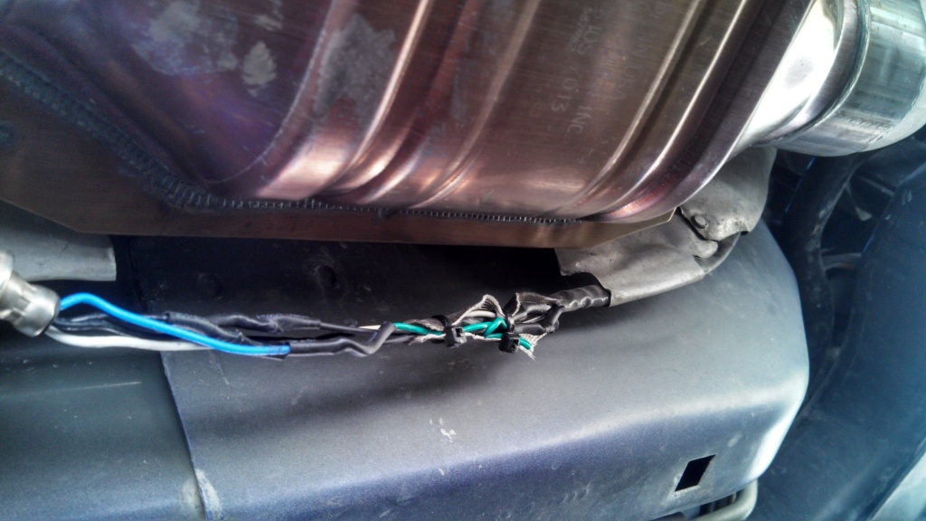

OTTP Down pipe, direct bolt in BUT you're going to have to mod your down stream O2 sensor.
The obvious is that he O2 sensor wiring isn't long enough to reach back this far. So I cut each wire and added some spare wire I had laying around along with shrink tubing to make sure it's a clean install.
Now I'm having other issues, I need to replace the thermostat and see if that's the issue. But I'm not seeing proper coolant temps in the winter months. I killed the fans and it's still running to cold. I'm seeing maybe 153 degree temps while driving to work. It might see 167 at a stop light if I'm sitting long enough. The outside temp this morning was 67 degree's. My check engine light is on for P0128 - Engine coolant temp below proper operating temperature or something along those lines.

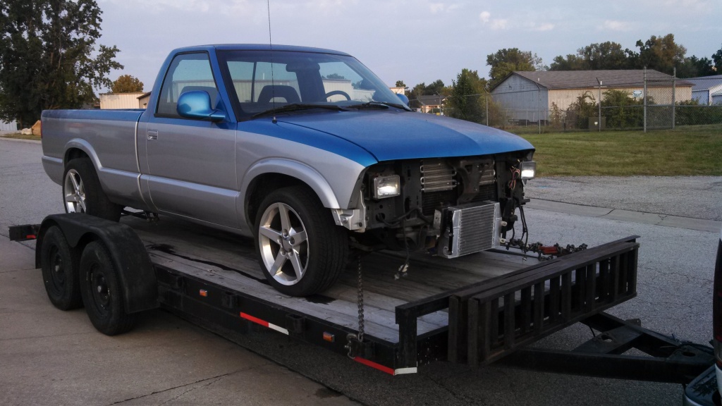

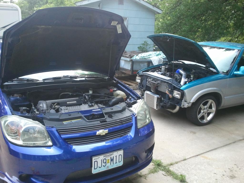

Lastly, my 3 year long save/build is almost done! I've had this thing down since August 12' and it's off for wiring this week. But here's my actual toy.
Finished up a few things and got it dropped off yesterday at the shop. Can't wait to see what this put's down on the dyno!
66mm T4 Borg Warner S300SX, 80# Injectors, Walbro 400LPH Pump, AIS Methanol using 1 nozzle for now + intercooler, with lots, lots more stuff. Can't wait for the fun to begin!

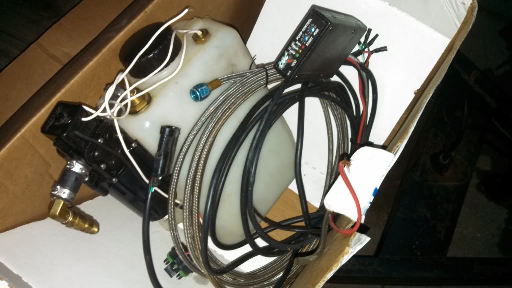

I forgot the methanol kit I picked up for $100 bucks, $10 in fittings, and a left over nozzle, and looking to upgrade the pump. So for a hair over $200 I'll have a methanol kit for the Cobalt.
