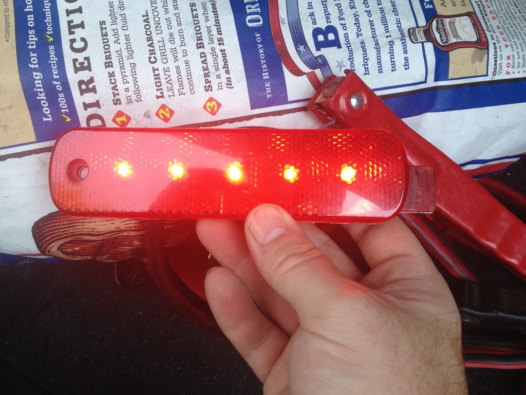

Fixed. It's crooked because I was holding it together by hand.

turned out not too shabby.

Yep! The stock lens is meant to disperse light so... Looked like **** until I ground some domes into the lens where the led would each be.

Great job! I've played with one a few months back but between the lens making anything behind it look like crap, the fact that you can take these ******* apart without a dremel and the fact that they are impossible to find second hand, made me decide to pass on offering them. I'll point anyone that's interested to you

whats the back look like, what holds them into place other than your fingers? lol

I'm working on that. For this first one E-6000 but that's questionable. I was thinking of a little bondo or plastic so I can make them look pretty on the back. This one's pretty ugly even though you'll never see the back once it's installed. I'm probably going to do a how-to when I do the other one. It's really simple if you have a dremel and/or a drill.

UGH yes that was a pain. I got covered in plastic shavings. I'm really tempted to buy a set to use for re-casting now even though it's huge trouble. It'd be simpler. Thanks!

just wondering, to make sure the leds stay in place and don't move around. I could care less if its held by pieces of gum, as long as it works and holds them in place lol
