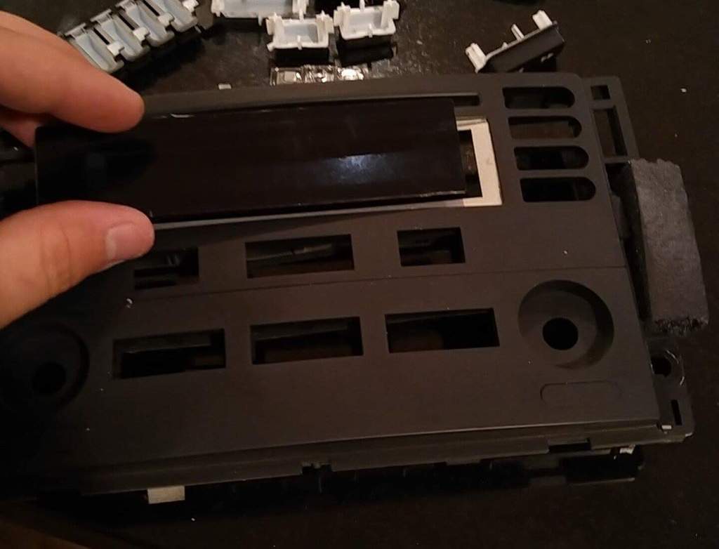

Want your 1st gen radio to light a different color? No? Then disregard this post!
Screen pops out from the front.

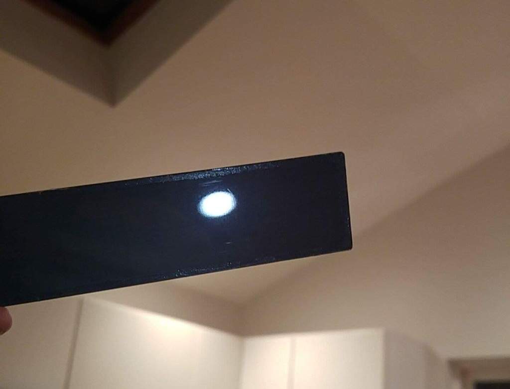

Heavily 'blue/green' tinted plexi..

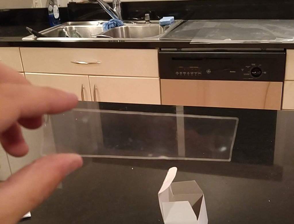

Cut a piece of clear plexi to size...

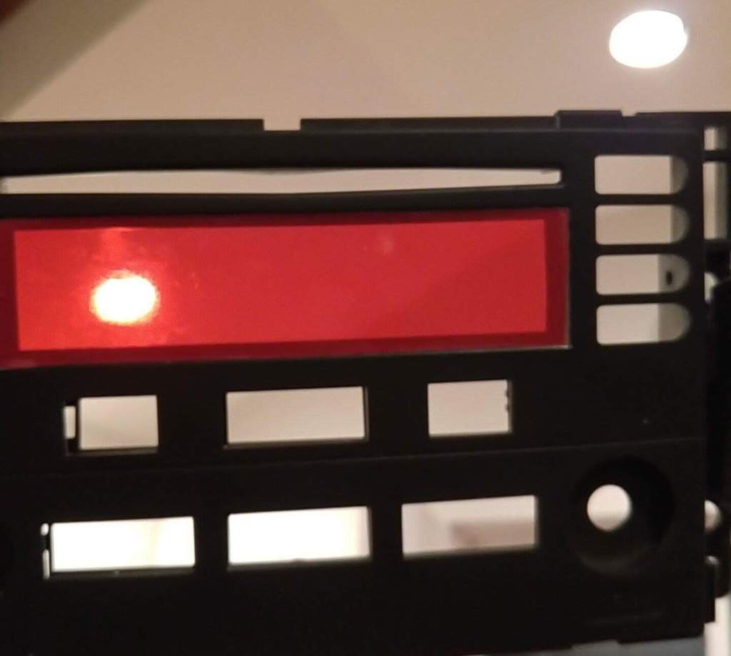

Cover it with two layers of film and pop it in! Due to looks i may tint the piece some

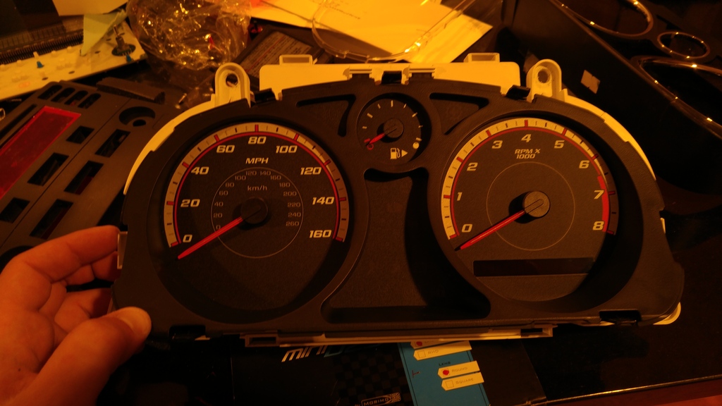

Also replaced my needles with custom red ones and did the same thing noted above to my d.i.c. - wipe alcohol on the back side of the gaugeface to get rid of the tint then lay 2 layers of the film on

Pics of this all in action will happen when the paint drys

What film did you use rice?

I have wanted to do this for years to my DIC but the timing is never right! I want red and they have red or green or blue transparent duralar at Hobby Lobby next to the model car paints. 2-3 layers of that would work wonders!

Snail, just red tint film i got on ebay lol. If anyone wants some pm me an address and i can send some in an envelope haha. I got 3 sq feet obviously dont need that much

^^ so its that easy to make it red?

I want it to look white tho lol

Hey snail just replace the screen with a clear or tinted piece of plexiglass then lol

Ohh rice what you use to get the plexiglass to stay in place?
