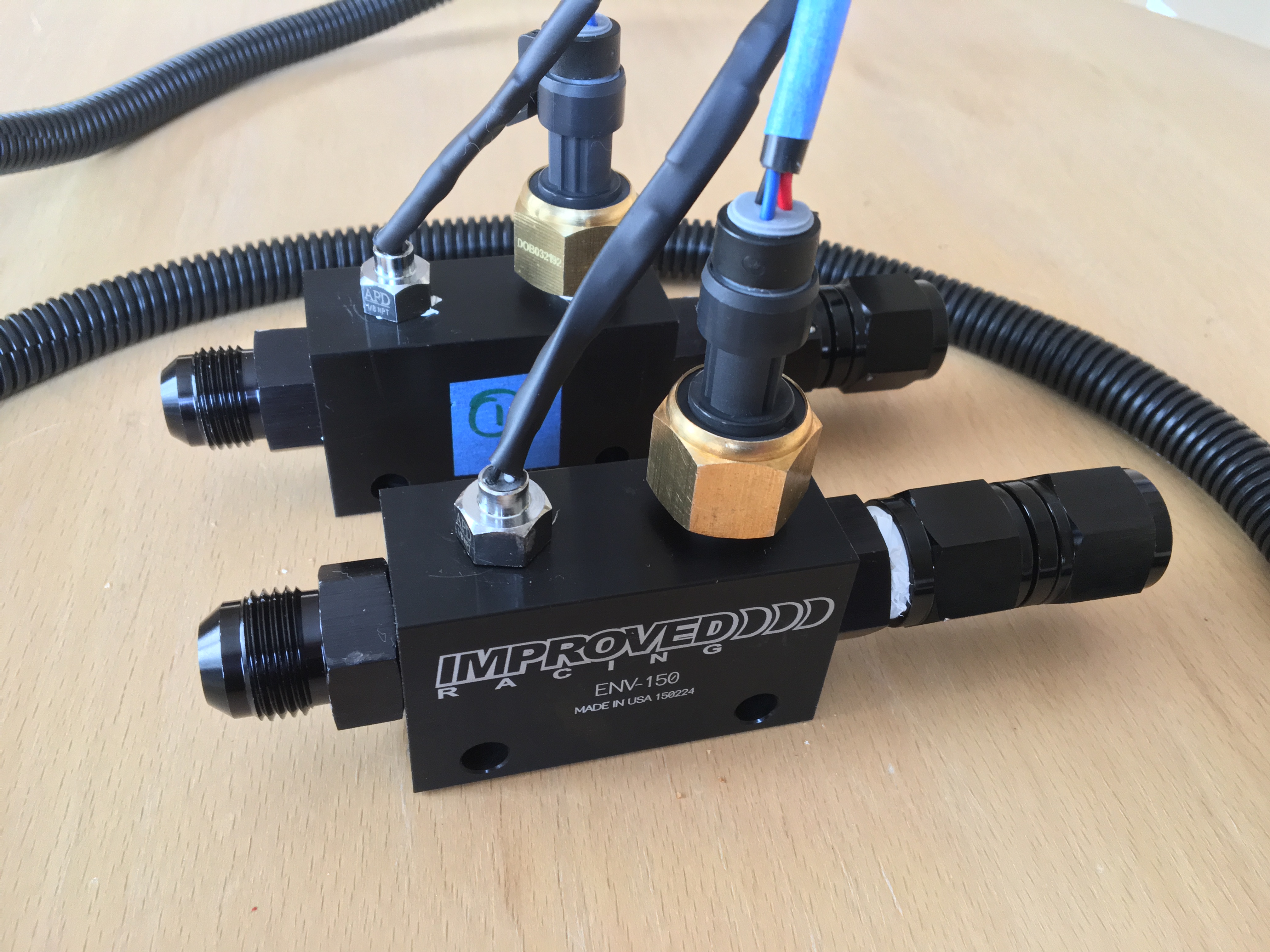

Deleted the coolant hoses that used to connect to the stock oil cooler and capped them off. Installed sensor manifolds to capture oil temp and pressure pre and post front mount oil cooler. Just need to run the wiring and hook them up to my dual interceptors
