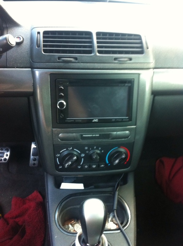

got my double din wired up. gotta cut that rear beam out tomorrow because it doesnt fully fit. its held for now with just 2 bolts. cant put the dash trim back on. but after i cut the beam out it should be good.
going to try wire cutters i dont have a saw or dremel

The metal piece, or the plastic? The plastic should be easy for any sharp edge. The metal, you know, you can just unbolt. You don't need to cut it. I just couldnt fit a wrench in there and didn't want to bother.
looked briefly and i think its the metal piece.
i dont remember seeing a plastic piece. im going to look at it today. all i know is i couldnt put it straight back because the back of the double din was hittin the back metal piece.
after i unbolt the metal piece the double din will be able to go further back and the holes for the install kit will sit flush with the car right

right. but there should be plastic in the way before the metal. If not then this was already cut out so no worries
yeah i already had a single din. Bestbuy did the original install in 2009 on my sony. I bought the upgraded model of that 2009 model in 2011 (same thing just upgraded design and interface)and i changed it myself. I just took that 2011 Sony model out for a JVC KW-AV60BT.I got a GREAT price on ebay BRAND NEW. Too good to believe seeing how much it is on Crutchfield Best Buy AND Sonicelectronix. Lets just say for the double din, JVC iphone/ipod interface cable, install kit AND an adapter that fits my Lifeproof Iphone case( obv not needed if you dont have a Lifeproof case for iphone), I got everything for cheaper than the Double Din alone if one was to buy it at one of those 3 places i listed above. I didnt see this plastic. Best Buy probally got rid of that when they installed my single sony din in 09. i did see the metal that was connected to the everything back there. on the sides and everything. so you just have to unbolt it? or just cut the left side and right side and remove the bolt on the right.

u can remove it however u see fit but if you have a 1/4 ratchet a 7mm socket and some determination then it will unbolt with no cutting required at all.
yeah i have that! well i may not have the small ratchet my friend probally does. because i was using a small ratchet yesterday because thats what my friend had but im sure thats EXACTLY what ineed to remove that back bar.
after its out just line the install kit up and bolt it in right.?

yeah maby your measurements are smaller than mine. im just going to unbolt the metal bar and slide the din back and it should be good to go

turns out i did have the plastic! went to town with wire snips at the corners. broke it in half. than snipped the other side.
gettin to the bolts was cake. used a normal size ratchett but this is a twisty one that turns 365 degrees. worked like a charm.
