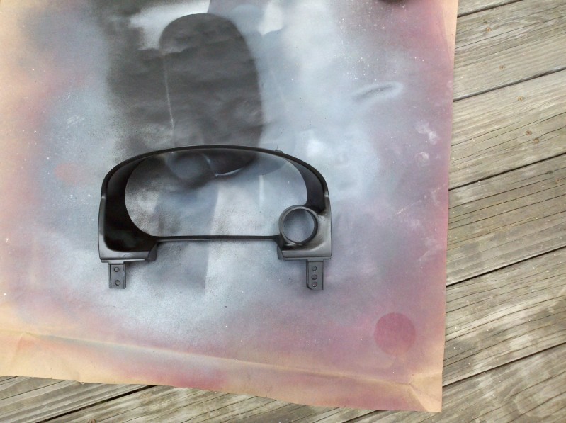

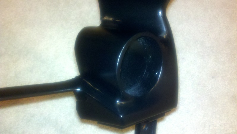

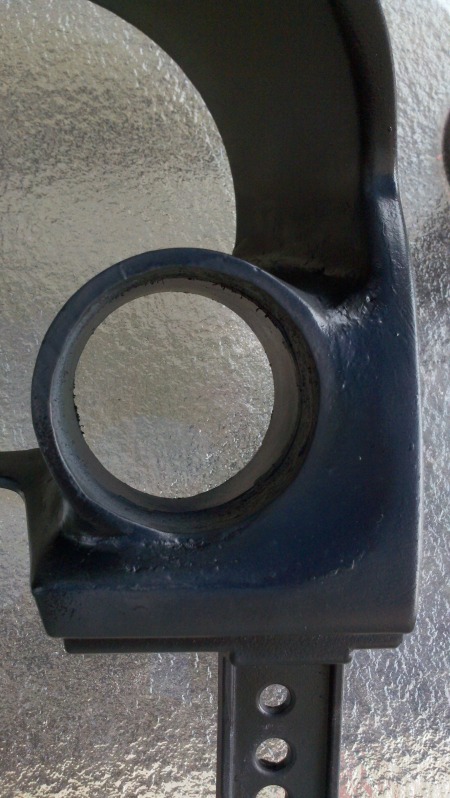

got it done today. looks good from about 2 feet away. when you get up close though theres a few things im not 100% with. Mother of god though im done sanding. my girlfriend was like oh wow i want to start making these. im like have at it....

I mean no offense by this but. Yikes:s

Yeah, sanding is the worst part. I repainted mine twice because everytime I noticed something I missed and had to fix. Seriously, fix it before you put it in otherwise you'll have to look at it. What grit paper did you use?

is it just me, or does that look like its angled outwards
lol i told you it wasnt 100%. was my first one.
Its not outward its straight on when looking at it.
i used 220 to get it down, then 600 to finish. im thinking my issue was in the mixing portion of things. i was trying to mix good and apply to whole piece, i think im going to mix less amounts at a time, and work on one area at a time for the next one.

It probably didn't look that bad when you had sanded it too. People (and I include myself in this) think paint will fill in and hide stuff but it actually shows all the imperfections.

i primered it just to see imperfections 3-4 times. I think half my problem with it was I got to the primer stage and kept thinking all i gotta do is paint and im done and rushed the end. I did spend a **** ton of my day sanding it though.

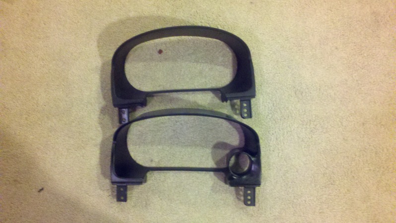

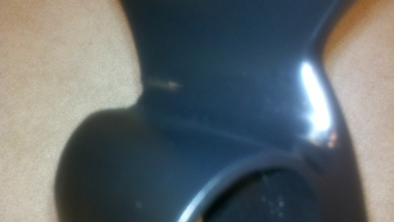

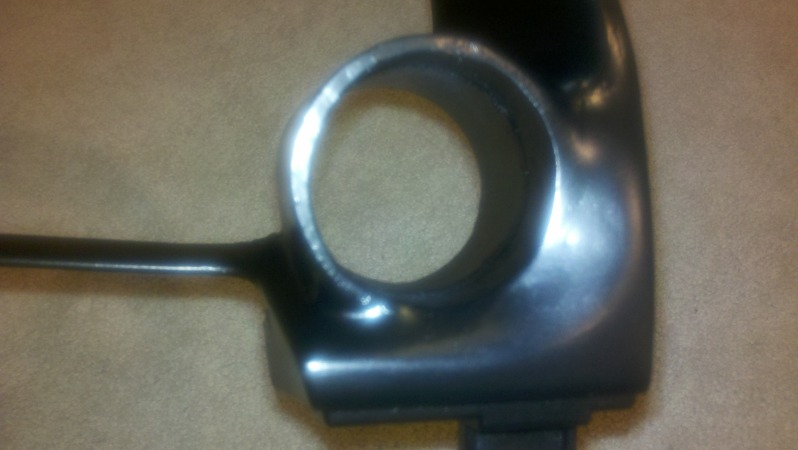

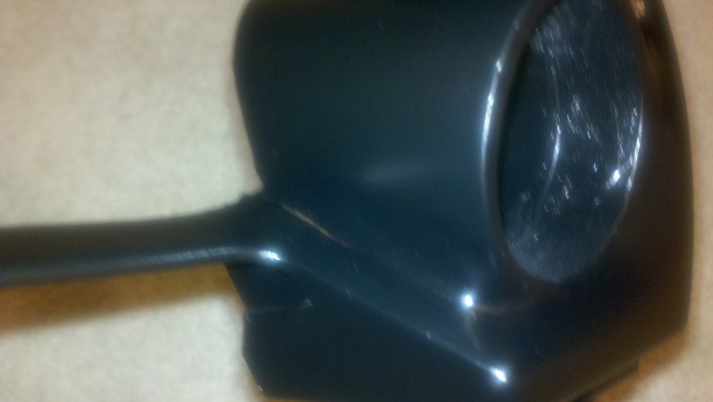

so six hours of sanding since my last pictures I came to this. VERY Happy with it.
Was how it was before I decided to put more time into it, cant really tell from this picture, but it wasnt pretty. But you get an overall idea vs stock
The blank one my girlfriend wants to do now into a dual. She said it looked cool.
