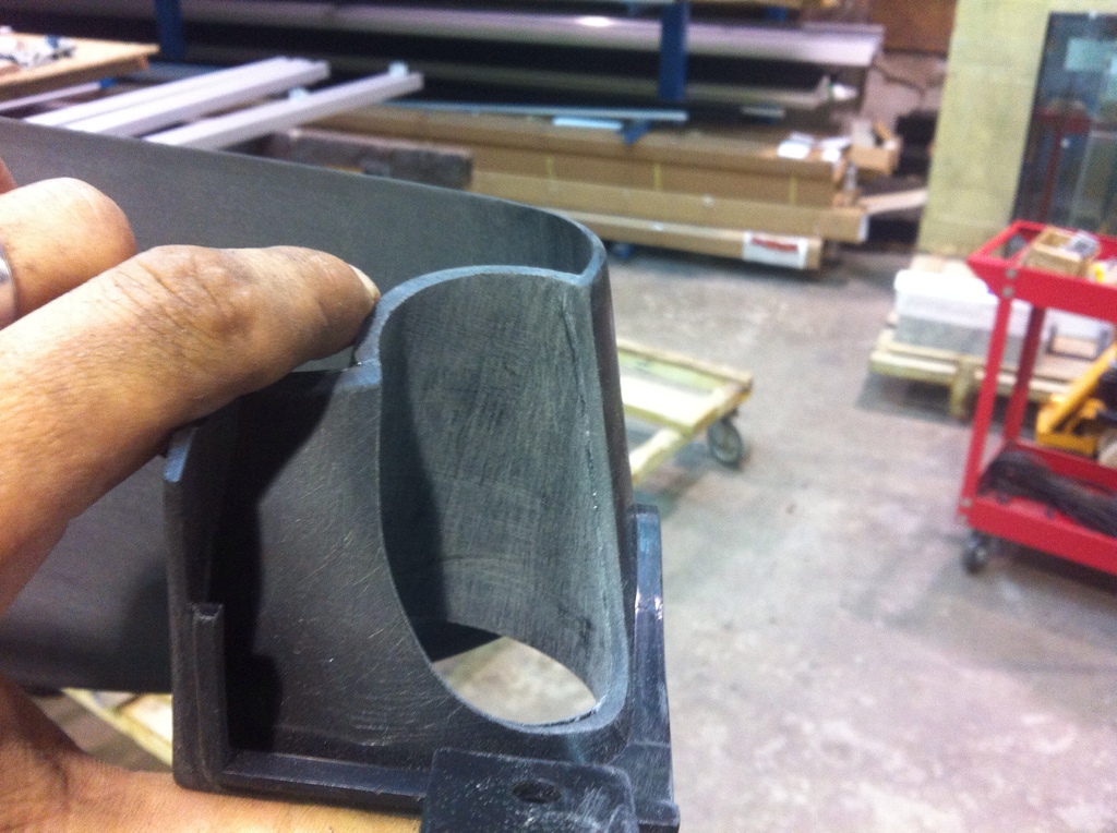

whats your backs look like cut out?

looking good! i need to clean my back side up on the next bezel a little better

I found the Dremel excellent for making a nice inside radius using the sanding drum but only for a rough shape. it takes material away too fast to be 100% the first time. hand sanded the rest no prob.

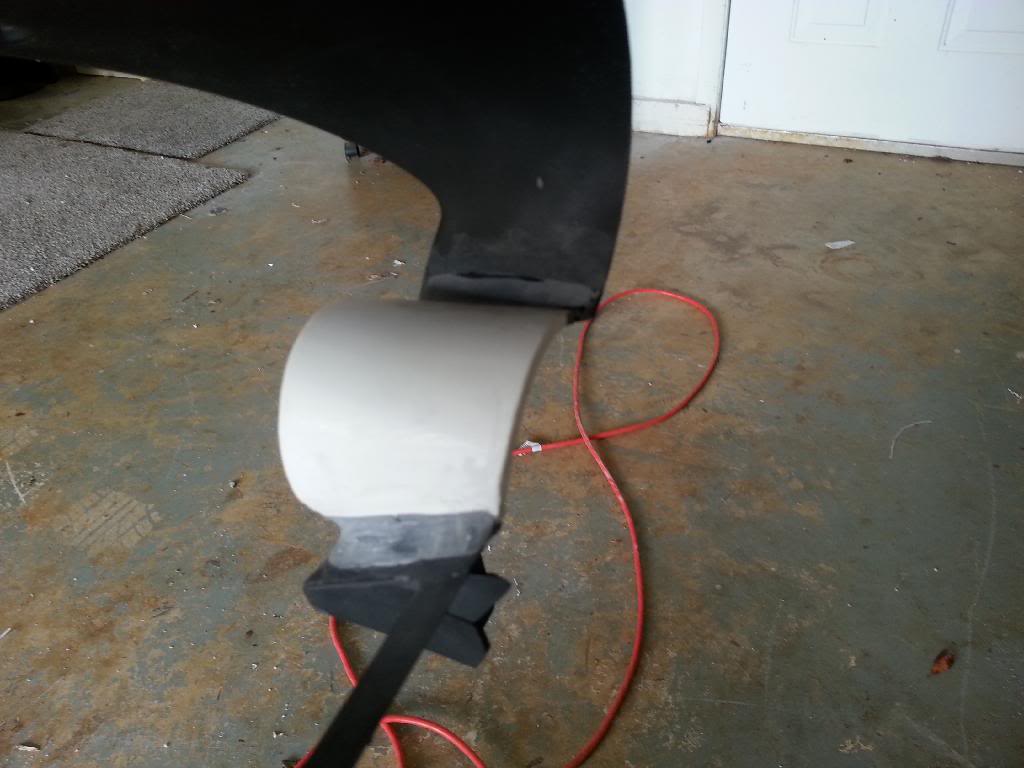

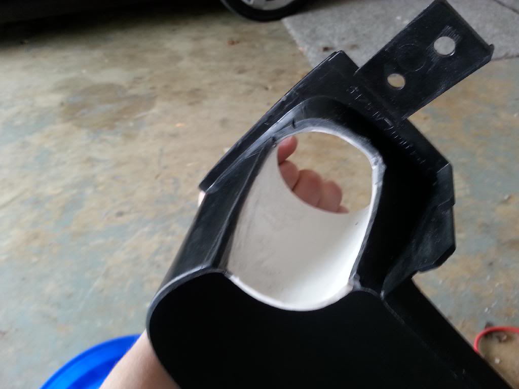

I figured I would contribute to this thread with my latest creation. Thanks to the bezel I bought from sl0wlsj I was able to make a place to mount my wideband.
Pipe held in place with a couple spots of superglue.

JB-Qwik used to hold pipe in place and sanded to rough profile with dremel.
It's not perfect but for my first real fabrication project, it will work.
Thanks to this how-to I learned how to do some new things
