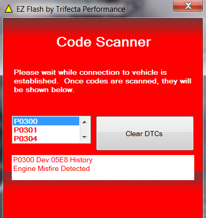

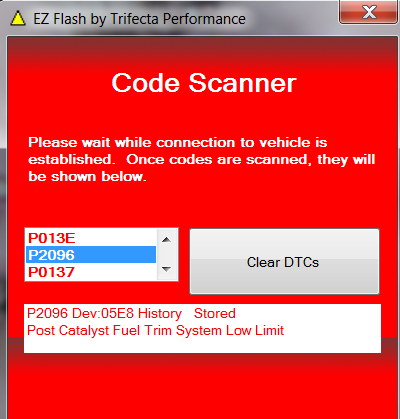

Hey everyone.
Got a few codes that I'm wondering if anyone could give me some clarity on whether I should be worried or not. First of all it's important to note that my car does not have a catalytic converter, and it also has a custom air intake system. The car backfires like crazy when I have the trifecta tune enabled usually around 4,000 rpms.
Thank you for your time!

backfire like crazy? like a machine gun? if that's what its like its most likely injector seal going out or gone.

It depends on if I try to go over 4,000 rpms. If I try to push it over 4,000 rpms, then it backfires a ton and my check engine light will flash for about 10 seconds and then shut off.

Ok try this try going over 4k rpm while staying out of boost, if it doesn't do anything then it's probably ur boost pressure at 4k rpm that is causing cylinder pressure to be high enough to blow past injector seal. I has similar , it was fine till 20 psi, after that it backfired like crazy. Got misfire in cylinder 4, never a light though. Try that.im sure it's ur injector seals. Sounds like it anyway

I tested your first theory on my way home from work today...I got up to about 100 mph in 3rd gear with no backfiring. I slowed down to about 50 and floored it and it started backfiring pretty quick. It seems like when the boost goes up to 20 pounds it starts backfiring pretty quickly. I was also able to replicate this issue in 2nd gear, could easily do like 60 in 2nd gear if I didn't stomp on it

yup that's ur injector seals then. get urself a new intake manifold gasket and injector seal kit from create engine depot and ull need the injector seal tool. I think there is a how to on how to do it. and change those seals. that will solve ur backfiring problem.
