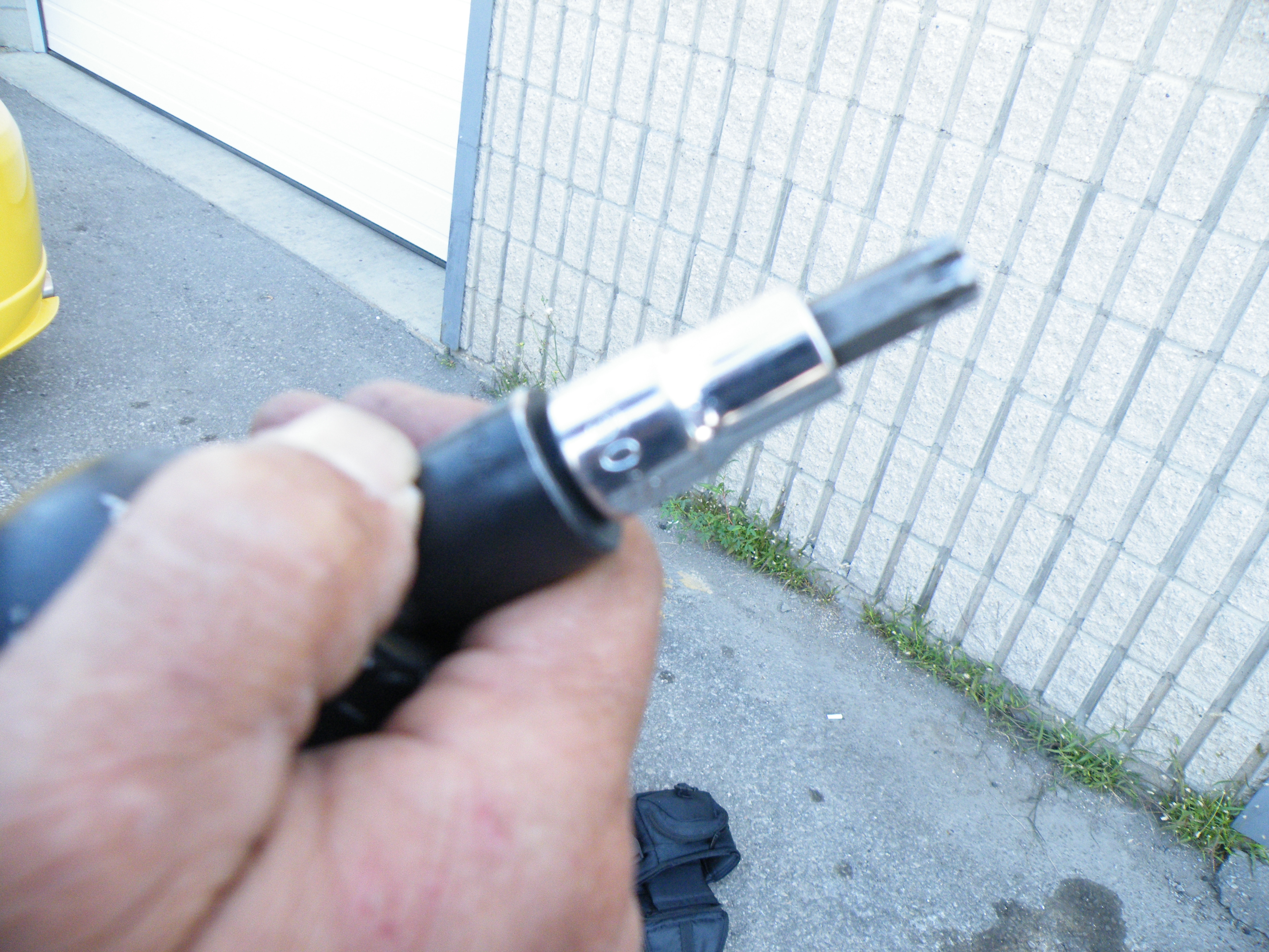

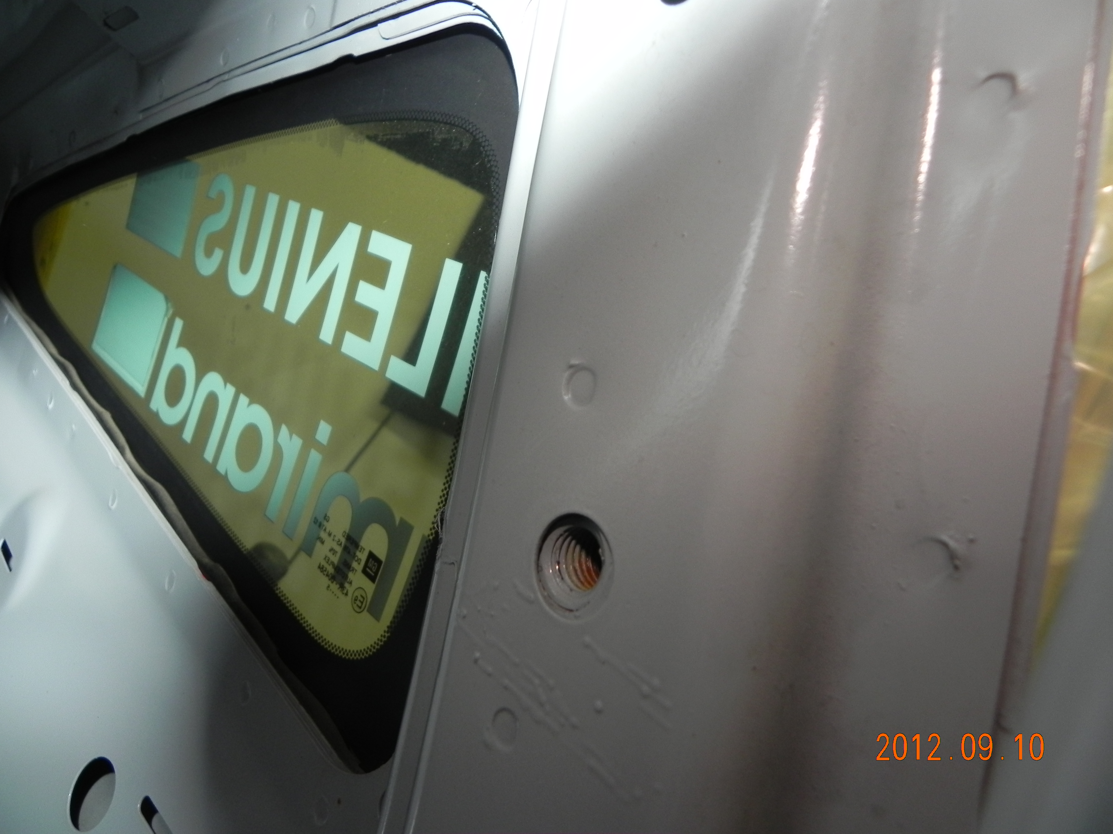

here is the upper anchor that can give folks issues removing the bolt

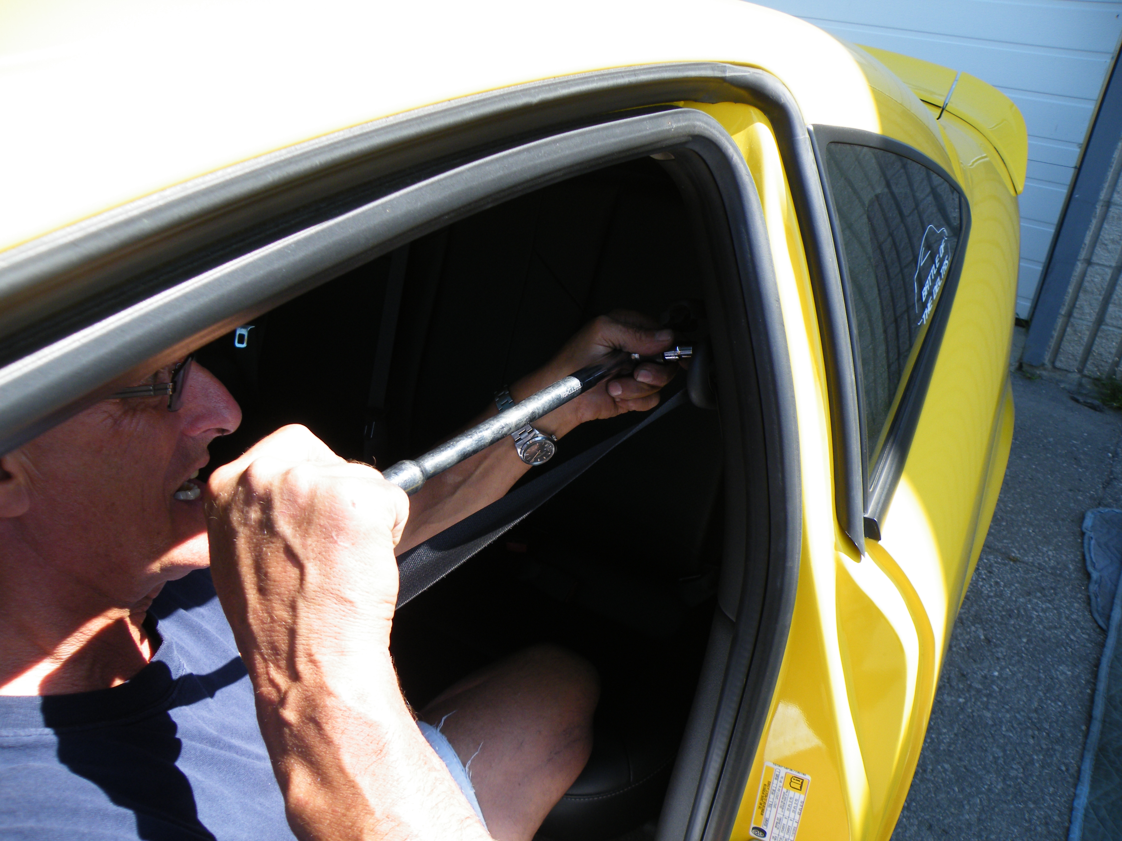

use some butane heat on the head, a torx 47 or 50 and a strong bar to remove. carefully

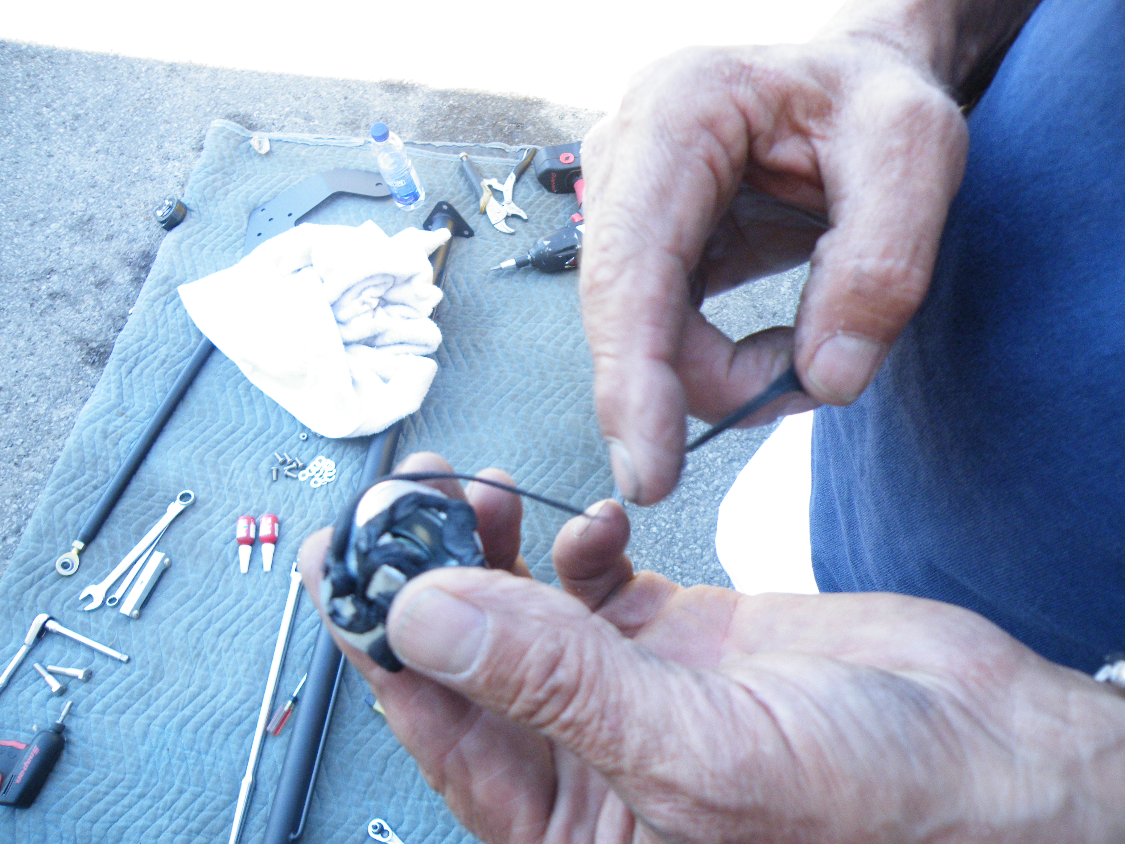

these are the spacers sometimes have to use dum dum to stick in place.

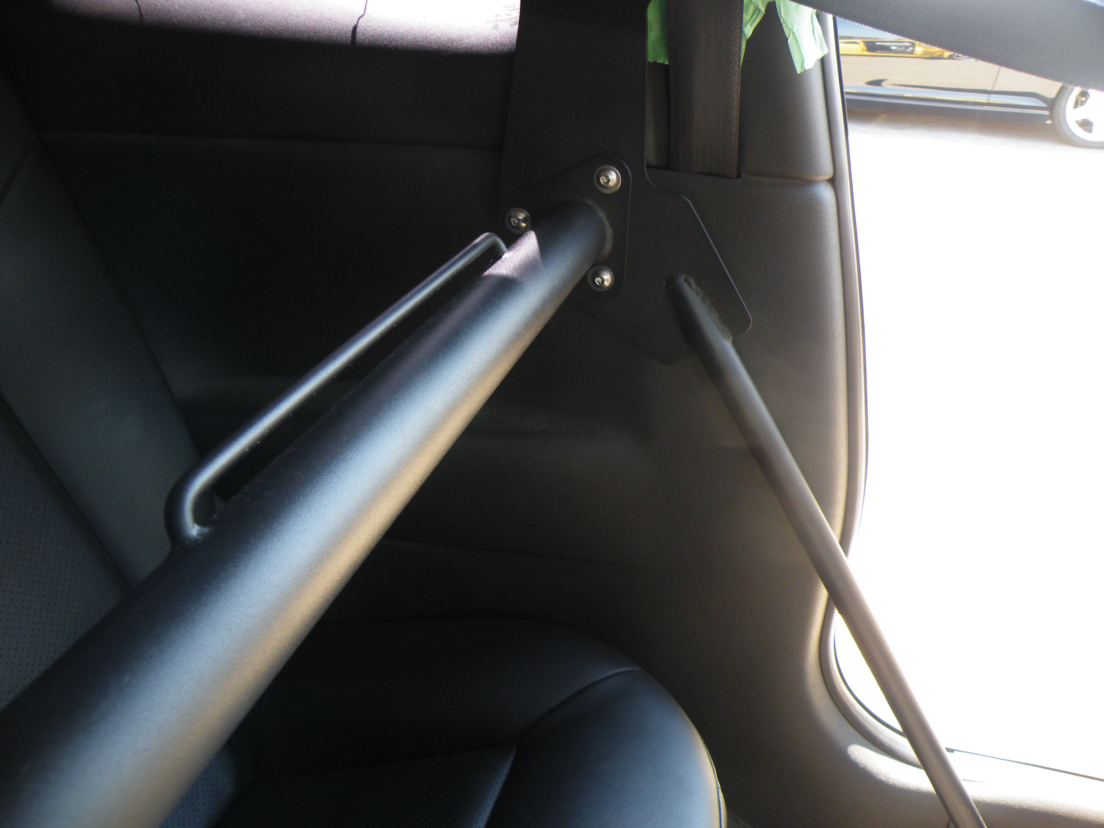

torx 50
