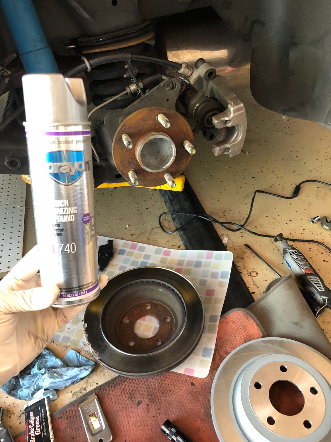

I highly recommend this stuff to prevent the rotors from sticking to the hub, and the wheels from sticking to the rotors.
My driver's side caliper appeared to be seized, spent too much time with too many tools to try and get the piston to go back in. Finally gave up and ordered a replacement caliper.

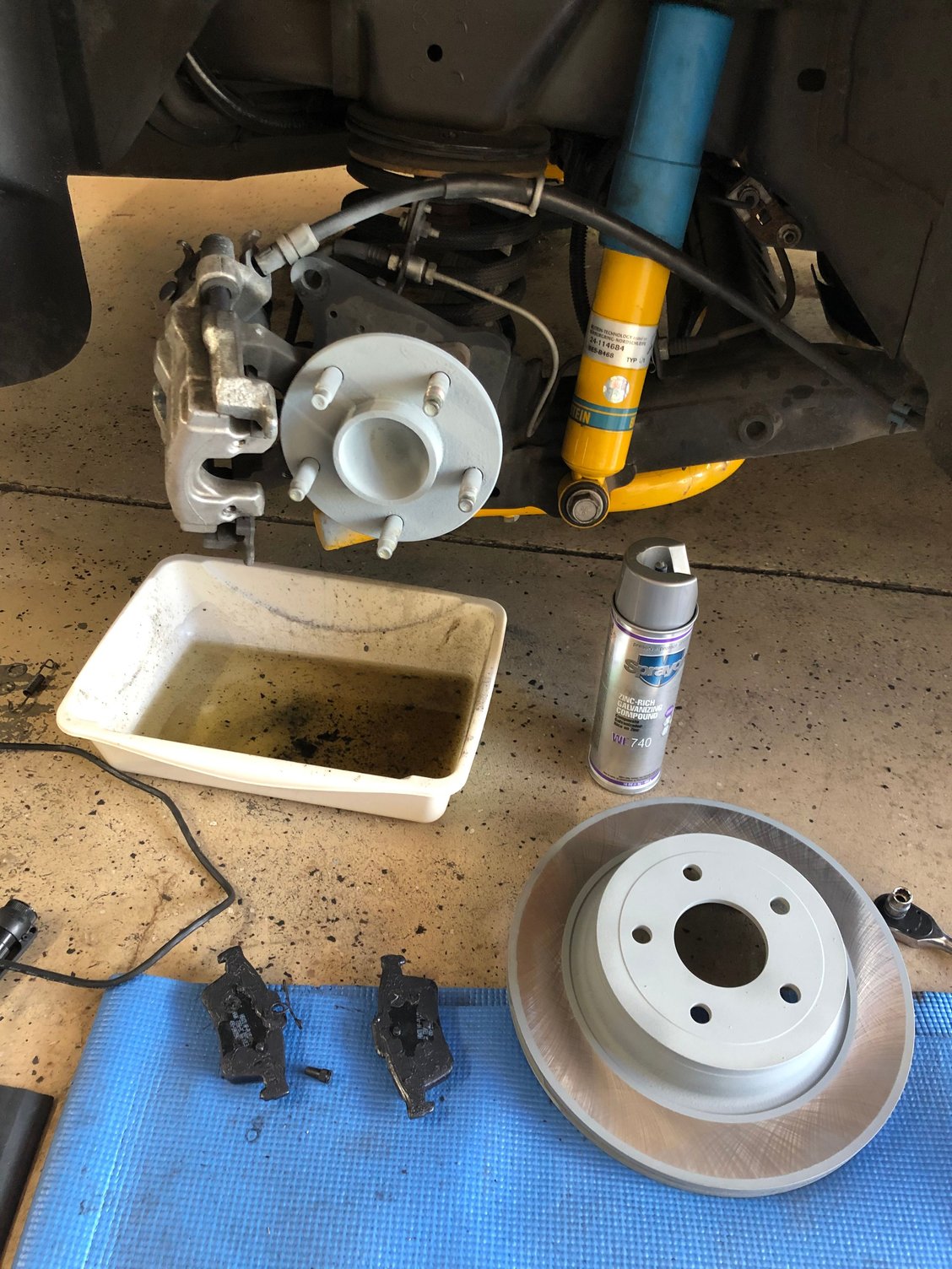

Old and new: DTC70 pad with some good wear on it, and a brand new HP+ pad
As they are designed to do, the DTC70 pads had worn down my rotors so badly, that I had to grind down
the lip on both sides to get the caliper with the old pads to slide out so I could replace them
