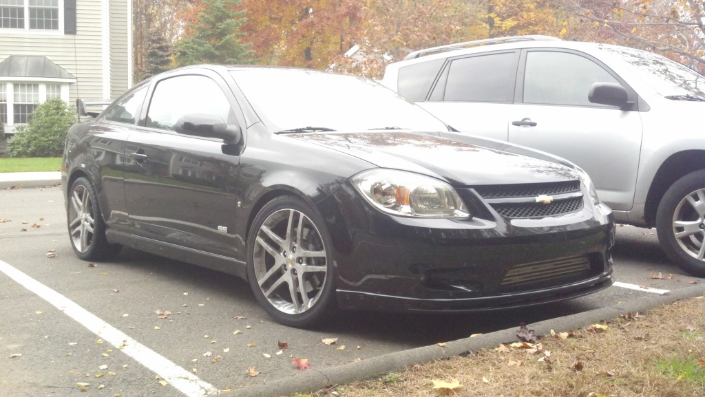

Is it me, or does mine seem to look a little higher than most others even after a couple months of settling? Don't mind my dirty ass wheels btw.... lol

Rear looks a little high

yeah that's what I'm saying! I think the front end is perfect, but I'm not really crazy about the rake it has.

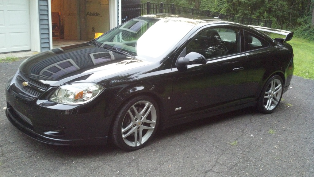

I did them around mid July. I couldn't imagine them not being fully settled by now.

Alot of people say these springs don't settle. Mine are the same height as the day I put them on.
