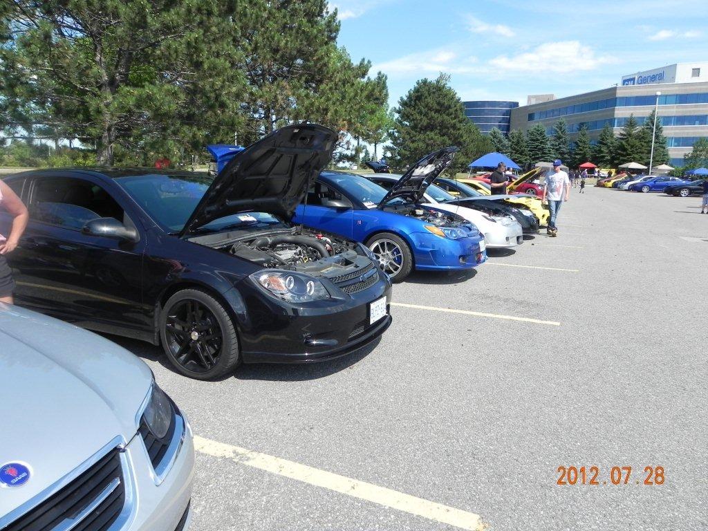

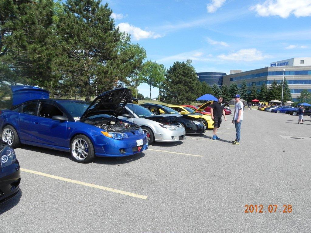

black TC is stock. Blue redline has YYZ
silver redline has Canuck/SSC
ya dont like it, fck it. The ride and handling trumps all. U want moah loah get airbags
Around 310 a set + shipping.... for the next four weeks...
