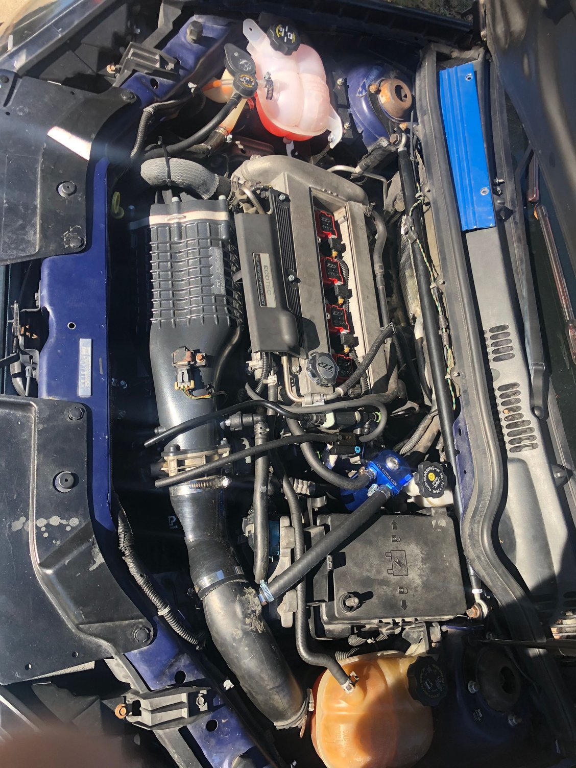

How the motor currently is and what the car looks like for those that haven't seen it yet I know it doesn't matter but I like showing it off.... I got this car completely stock and it was a shot box inside and out.

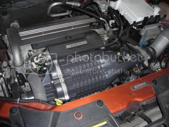

If you shave down that leg on the bottom of the "ECOTEC Supercharged" plastic piece, it'll sit more like it did with the M62. There might be a how-to on here, but it's fairly straight forward.
I was thinking about doing that! But now I 100% am going to, I have a dewalt multi tool that will cut it off perfectly
