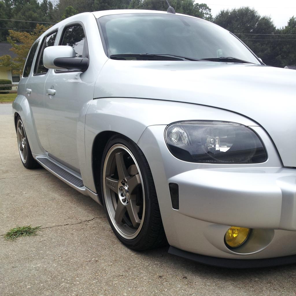

I want to go with a wider wheel without sacrificing my ride height. Does that sound better? Right now I'm slightly tucking my tires in the front.

Run a 18x9.5 with a +30 to +35 offset and stretch some 215/40's like i did and you can still tuck tire, poke, and be "stanced"

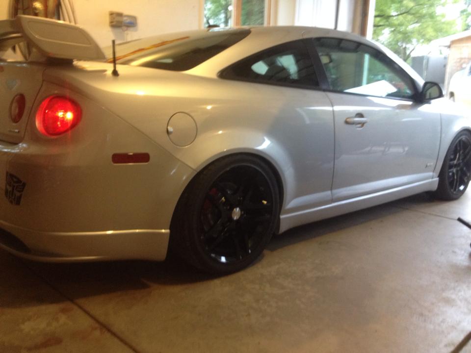

Lovely potato picture. I have not even put 100 miles on it this year with all the work I have put into it! It is at GM getting the recall work done to it right now. Should have it back tomorrow. This picture does no justice. AT ALL. I have a photo shoot coming with mr.gudaguda

Finally got with STR about custom drilling a wheel...they have some blanks right now and can do a set of the 601's in a 5x110. I'm ordering these today...18x8.5 +30 or +35 (he can do either one...need to make that decision before calling). Was going to do a 18x9.5 but I'm really concerned about clearance.

if you're doing a 18x8.5 you should get a +30.. imo. that should be pretty close to flush i would imagine. I don't think you would have any issues on a HHR with a 18x9.5 +35 though

Yeah I'll do the +30...there's someone else running this wheel with an HHR 18x9.5 and there's no way I'd be able to tuck the rears...with enough camber up front I may could get away with it. I'd rather play it safe with the 18x8.5 +30
