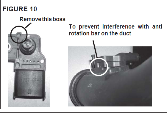

Anyone have a before and after pic of the MAP sensor showing the amount of material to be removed where it touches the pipe?

I don't have any pics, but it's very little material. I just removed it with my pocket knife. Basically, you're just removing it so that it doesn't hit the stock coldside pipe boss. In the pic on the right, you can see it sitting on top of the boss and it making the sensor not sit flush on the pipe. If you have an aftermarket coldside pipe, you don't have to remove anything.
the kit spells this out.
the one that caught me off guard was needing to enlarge the hole for the 2nd MAP ~ I was in a crunch for time too!

I may have ground a little too much on the sensor though... Not sure, I guess we'll see how it goes after the tune. I got to where I could see a real small piece of metal. I think I took it too far.
I installed it all from the top, but I think the sensor in the cold pipe would be easier to get to if the car was jacked up.
Here is a pic of the sensor...
