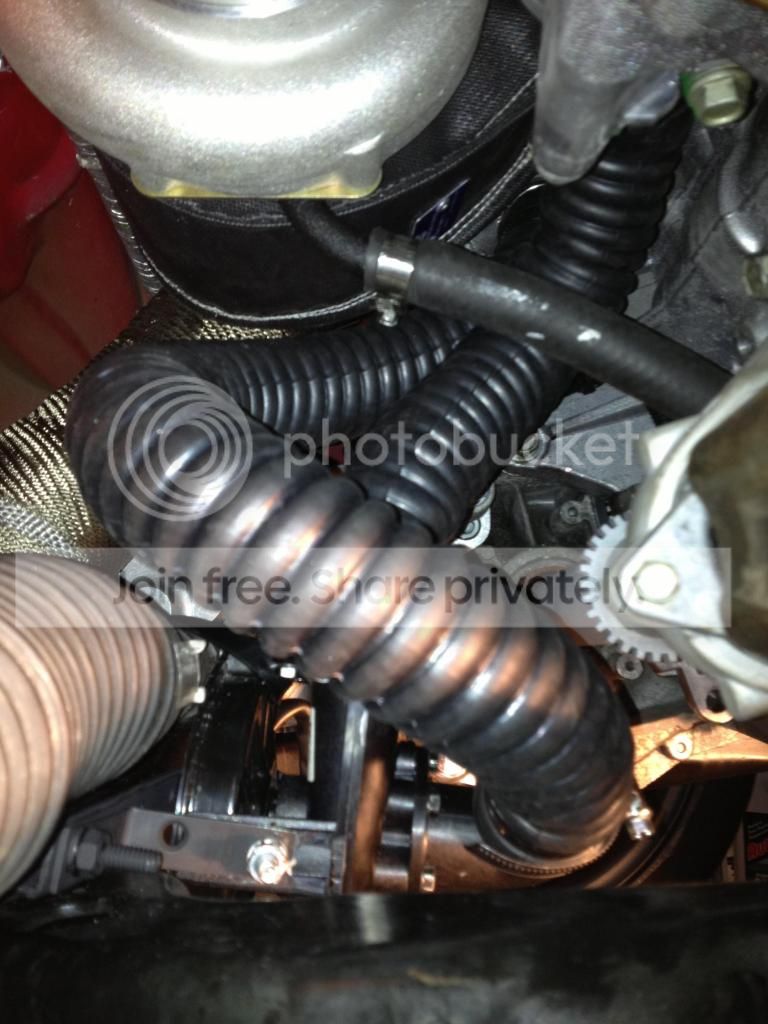

alright, had to re do the water pump, the way I had it was causing the pump to push coolant back up in the coolant tank. So here is the way it is now. I have a little left to do but looking to get it on the road tomorrow. Have to make sure there wont be any leaks and what not. And am going to make a new bracket to hold the water pump so it looks a little better, on to the pics.

I forgot what our pm's consisted of honestly lol. Looks like you just split the coolant pipe. Was that your A plan or B plan?

That's plan x prolly lol. But I talked with t jolley about his he did. And I was missing the concept of the ecotecs coolant system. The coolant constantly cycles throughout the motor and then once the coolant hits 180 the stat opens and pulls coolant through the motor. Where I had the pump at it was just pushing and not circulating anywhere but the coolant tank. even with the controller and the thermostat out, since I had the pump in the wrong spot it still wouldn't work. So now I don't even need the controller again and put the stat back in. Tomorrow will be the day.
Old Aug 14, 2013 | 12:09 AM
  #167
cmiller8006's Avatar
Joined: 05-29-08
Posts: 6,079
Essentially the davies craig pump is acting exactly like the stock pump now.

Ah I got ya. With mine it just never let the engine get up to temperature. That's why we put the controller in there. It wouldn't heat up past about 153*.
Old Aug 14, 2013 | 01:07 AM
  #170
Joined: 05-29-08
Posts: 6,079
That's why I just put the stock thermostat back in. And I can get my 270 bucks back from the controller.
