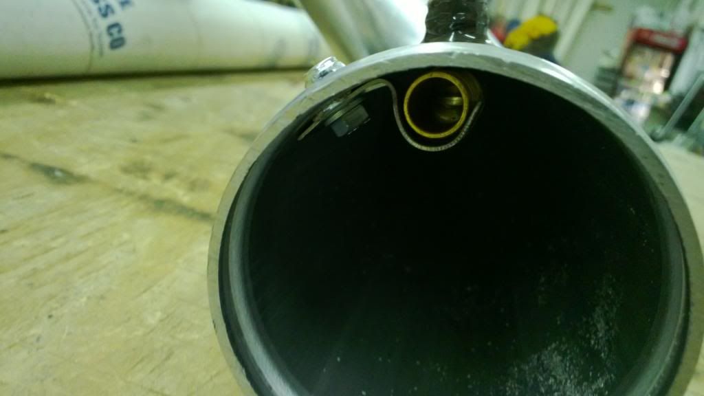

So I made my own intake out of the charge piping I got and a Spectre filter...
[IMG][/IMG]
[IMG][/IMG]
With PCV port built in
Now I have a small question...I used a 1/2" fitting, will that be large enough? The stock line doesn't look any bigger than that, unless I'm mistaking. Secondly, does it matter if the catch can I get is baffled or not?

Put a garden hose on it if you like; flow is dictated by the smallest orriface.
As far as baffles, as long as oil spray/vapor can't freely pass on through it ill do its job. Oil is heavier than air... As long as airflow is changing direction in there somewhere the oil will want to fall.

I am using brass 3/8 fittings at the VC and turbo intake. I tapped my VC and intake with a properly sized tap then used plumbing sealing tape on both threads. Works great for my 22 psi setup so far. I will say that I am not satisfied with the venting yet however. I am afraid its affecting the oil coming out of my turbo, causing pressure issues with turbo seals.
You should be fine as long as you are getting good compression on your pistons, otherwise a lot of blow-by will build up in the case.

Oh yeah of course, that's what I was thinking, the oil will fall one way or another so long as the fittings on the can are on opposite sides. Haha so long as it's 1/2" I don't really mind :P
And I don't think I've been having any issues with blowby so far, knock on wood haha. My car wasn't modded one bit before I purchased it, it's in surprisingly good shape mechanically considering how many owners it went through and how many miles it has. Yeah my fitting is 1/2", I hope it'll be sufficient, I'm going to be running a catch can too so that should help.

My catch can has a tube that is slightly longer than the outgoing tube. Works like a charm. Sorry need to clean the engine bay, its a DD. This is my 20 dollar setup. 15 for the catch can with hoses and clamps (ebay) and about 5 dollars for the fittings. I already had the tap for a different project.

Haha that's exactly what I had in mind man, will 1/2" line fit over the stock PCV fitting though? And lol yeah you should see my engine bay...I can't wait to clean and paint parts of it once I do the turbo swap, just a week and a half left to get through... :P
