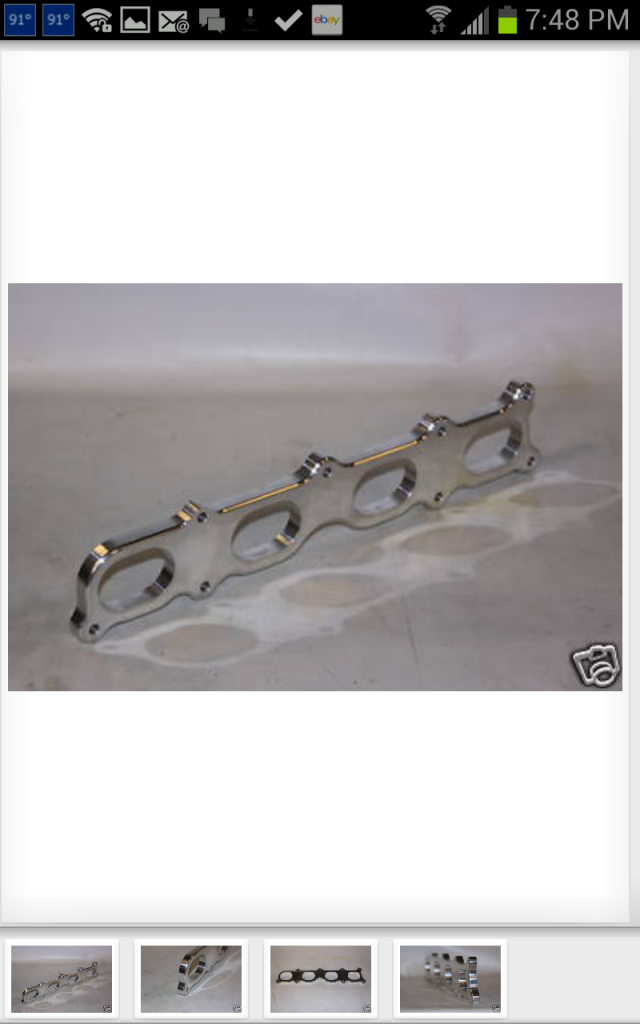

Simple fix put a new flange on it done deal u can buy one with O ring grooves machined in the face. So that thing can flex and twist all it wants.
Here u go
