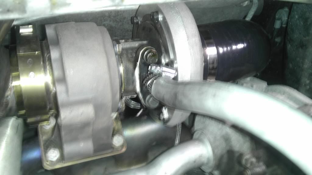

Originally Posted by mexi_loco
what are you going to do about your pcv system?
Im new to turbos. Could you explain? Is that the extra oil from the turbo leaking?
https://www.cobaltss.net/forums/forc...-turbo-257828/
read this and educate yourself. Not a "turbo" issue. More of a shitty lsj issue that you should be aware of.
Im not getting any smoke, just a little leakage from what looks like the oil return line, all the connections are tight and everything else is dry accept by the return line.

Originally Posted by BlkWdoSS
pics of where its leaking from, its possible that your drain is too low in the pan and causing it to back up into the line. Is it a soft line or a hard line? Is it leaking from the seal at the turbo? Possible that the torque isnt correct or that the seal is bad?
l8r,
PD
Thats where its leaking... I put copper RTV on both sides of the gasket and I let it was sitting for about two days before it was started. Its just coming from the bolt where the oil is about to drip. Im not getting anything on the ground, no oil spots. Still have none. But its on the frame. I have not looked since tuesday though.

Originally Posted by 05Slowline
probably didn't put any sealing solutions on either side of the turbo lol
i put loctite on the top feed fitting and permatex on the bottom return and not a problem..initially didn't put permatex on the bottom and it had a real slow leak..
I put copper rtv on both sides of the turbo and the header. Its not coming from a seal, but looks like its coming from the bolt its dripping off of. Everything is tight, including that bolt. Even though i never touched those bolts that hold the oil return line fitting on the turbo(assuming the turbo was already ready to be bolted on).
Old Oct 6, 2011 | 08:00 AM
you'll see it eventually.
