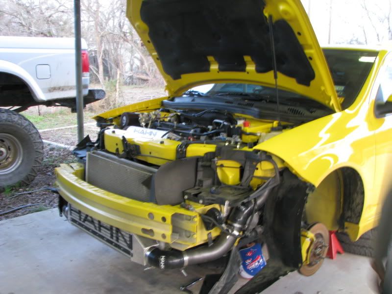

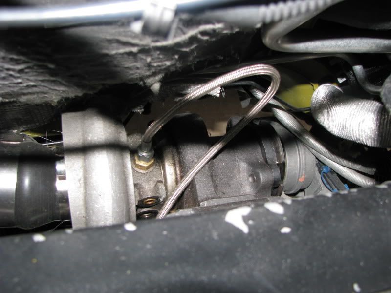

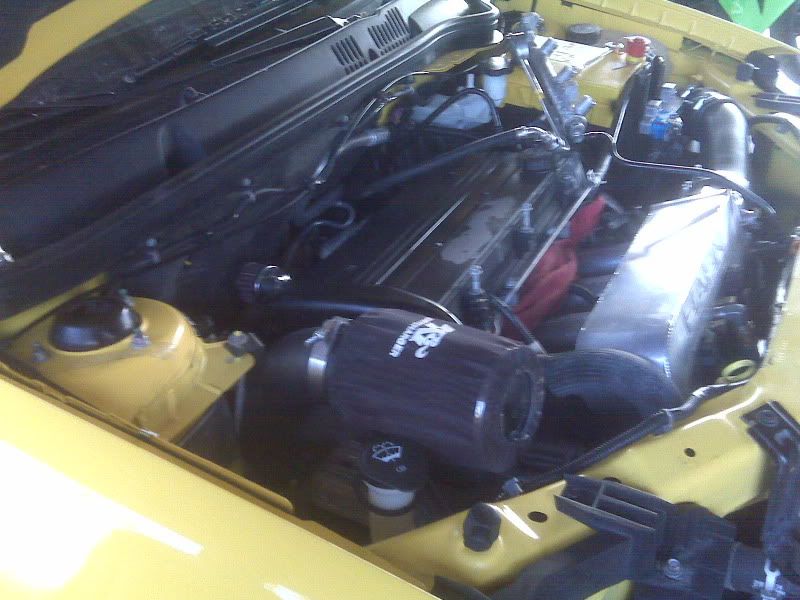

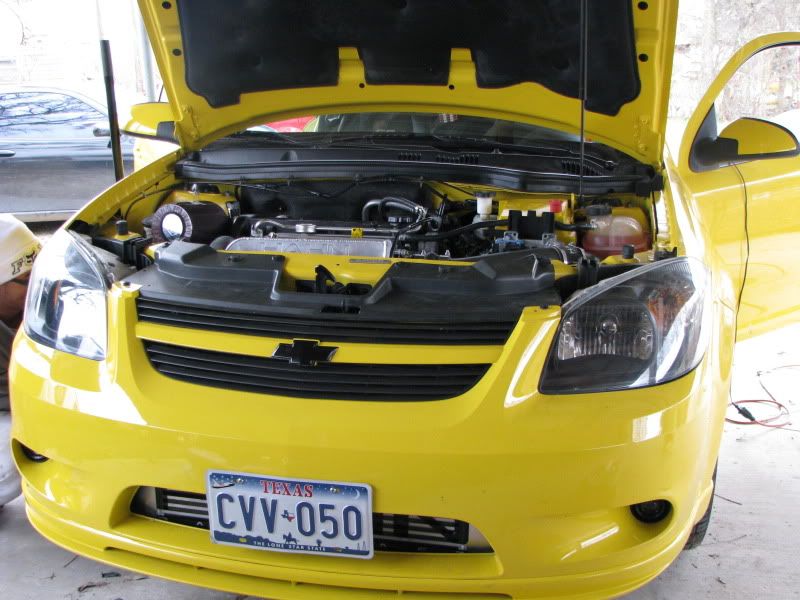

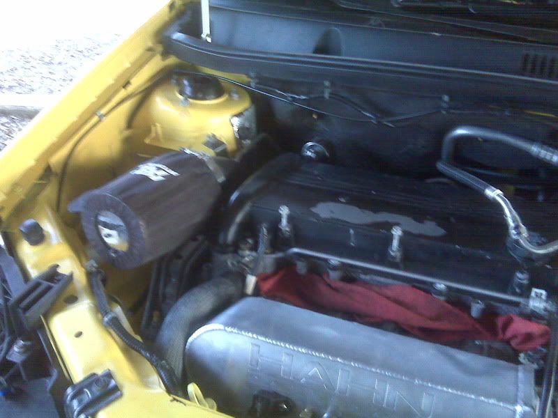

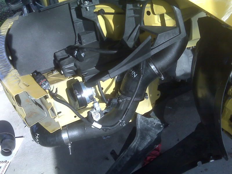

that would be enough for now. until i get a new clutch so hopefully paul can get that done today or tomorrow. i got hpt well the club does and i have it with me but idk how to use it all like that lol
Originally Posted by SSMOKEM
Good to hear it's up and running @ 15psi. Running hella rich, I'm sure you will get straight. I'm still waiting to hear if my turbo has been shipped...
thx man and yeh no pipes going off lol. just want to step on it but cant cuz its so rich lol
few pics. cuz haza aka interview...... keeps asking lol

yeh got car home now. gonna order exhaust nxt weeek. i think while i wait on exhaust ill take valve cover off and send to powdercoat gloss black. cuz i had painted it as u can see it got all fucked up lol. then ill start cleaning the car again. it used to look as yellow and clean as urs until it sat for 2 months at my friends house
when i first fired it up. started on the first try .after 2 months of nada lol

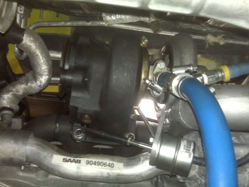

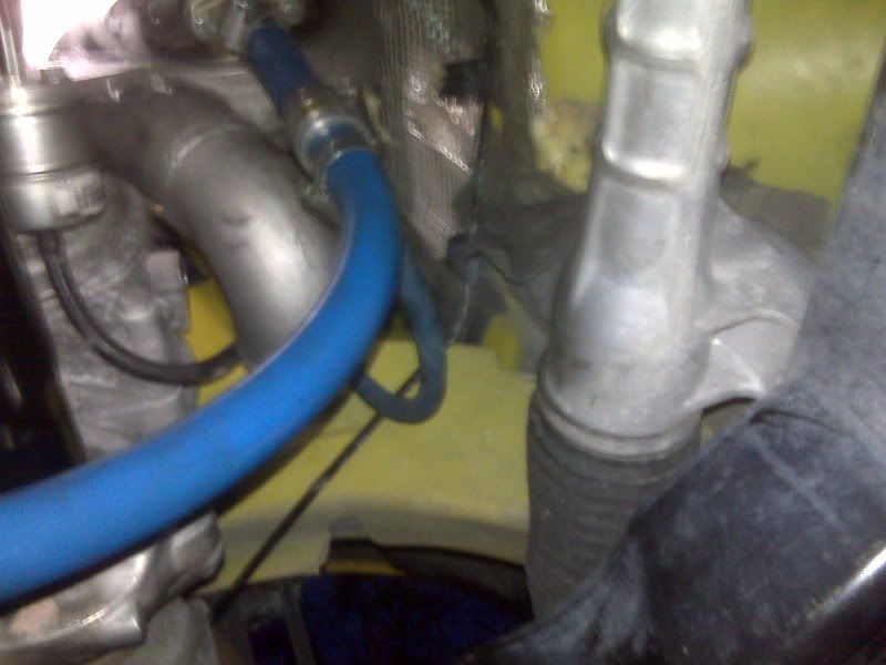

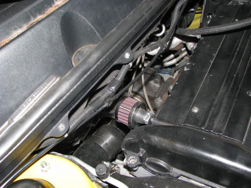

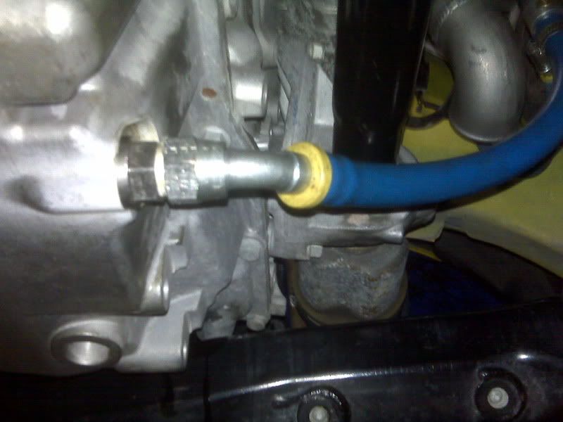

Good to hear its running. The only thing I dont like is the oil drain system.
Old Jan 6, 2010 | 08:58 PM
  #259
rico's Avatar
Joined: 12-09-07
Posts: 8,962
From: San Antonio, TX
yeh got it done sunday like I told ya before and agreed. ill be getting the back of block tapped like the lnf comes or oil pan soon. once i get exhaust and all im taking car to the shop to get all new lines and eveything done the traditional way

just get a -10 bung welded to the pan.
Old Jan 6, 2010 | 09:10 PM
  #261
rico's Avatar
Joined: 12-09-07
Posts: 8,962
yeh but i dont think ill need that one breather line the kit brings and goes to the water pump drive cover or will i? i ask because this is the first turbo/turbo kit i even mess with in my life . well im not that old either dont take it the wrong way only 20
No breather required when it's done properly.

funny how the "no tap" system needs you to "tap" the water pump cover.....
x2...that thing is only there bc of the way hahn did their drain system, **** you can prob sell that damn set up to soemone who doesnt want to tap their tap or girdle on the block :p
Old Jan 6, 2010 | 09:56 PM
  #267
slowswap's Avatar
Joined: 09-25-08
Posts: 5,384
From: Depew, NY
If you can tap the block like the LNF, it's the better way to go. Tapping the oil pan will still have the drain below the oil level. Or at least in my buddies case it was.
