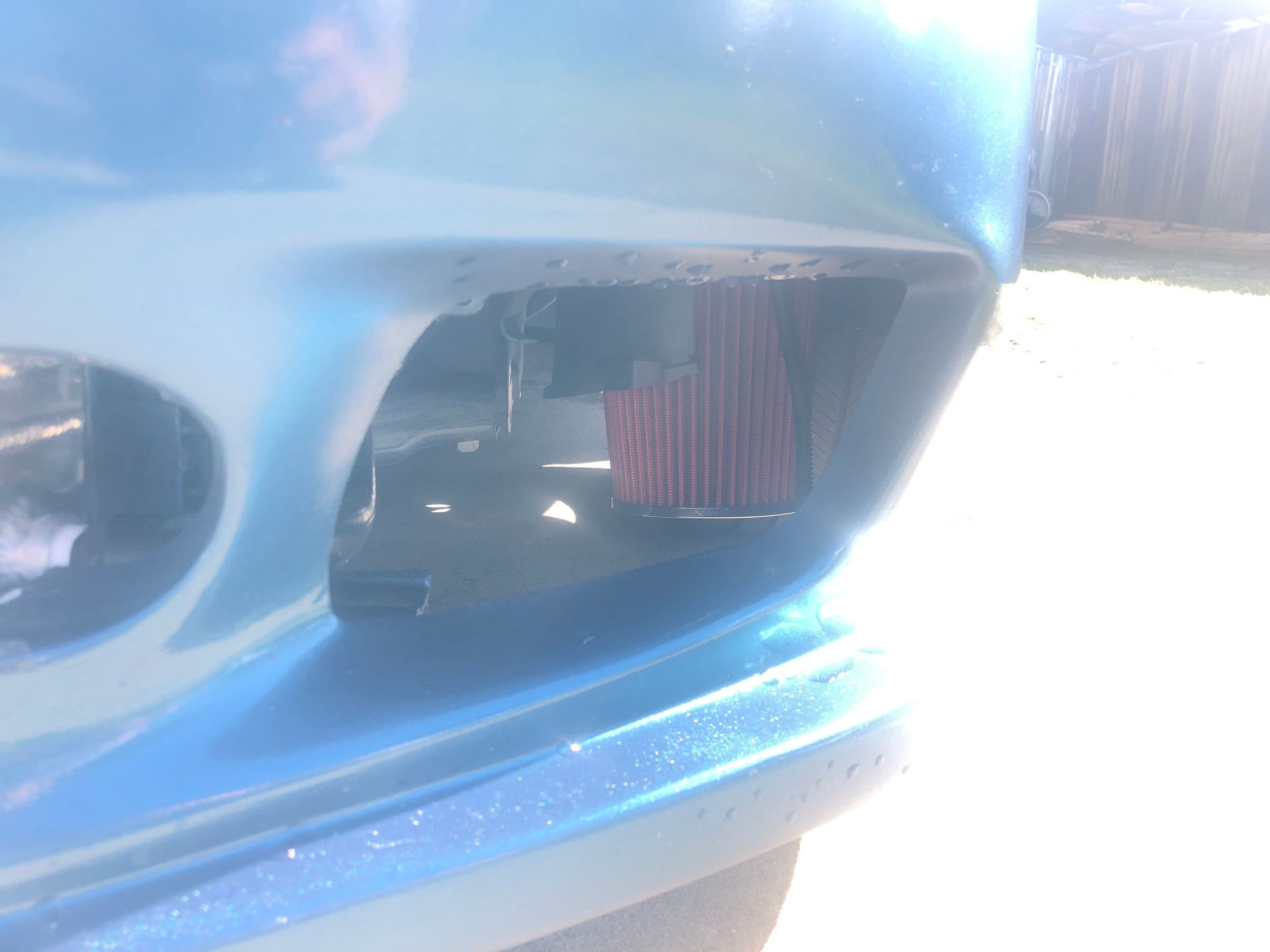

So been going back and forth with ZZP for a few weeks now logging and tuning this thing.... i have a high idle right now that I can't hunt down, I've replaced all gasket and even put in brand new fuel injector cups thinking that's where the vacuum leak might be but I just can't hunt it down.... anyone have any ideas? I also went back to the stock intake with the bottom hacked off and I've got much lower IATs because of it. Very happy with the way the car is running, feels very strong....

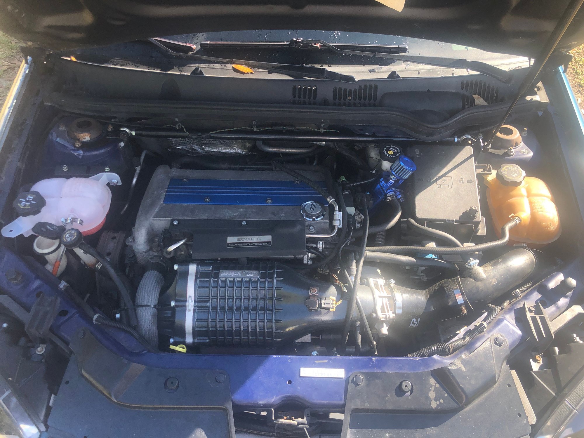

High idle is likely because you have a VTA catch can that's hooked up to the intake tube post-MAF. Remove the filter and plug that hole - catch cans shouldn't VTA, especially when they're properly connected to the intake tract.

my high idle was from my dual bypass endplate not having the rubber gasket where it connects to the supercharger, I added it and it went away immediately I feel so stupid lol, but I also sealed up the catch can like you said. Running much better now.
