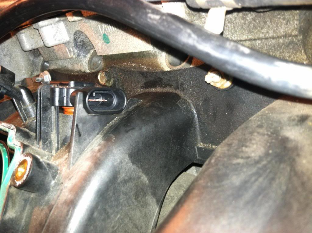

ive seen on here b4 that people were having problems with the 2bar map from zzp popping off when in WOT..is this y lol ? like i cannot get it all the way down for the life of me

When I first got my ZZP kit installed on my 2.4 my MAP Sensor kept popping out initially after I went WOT. It managed to work its way in and stay in somehow now.

weird..i guess ill see what happins when shes running

Try a couple of runs at WOT and check to see if it popped out. It was really weird. One day it just stopped popping out. It never caused me any problems though.

why didnt you use the stock sensor?

Stock sensor only reads air at atmispheric pressure .. This reads boost..

I was told Vince could still make it work

I run stop map sensor

What are your symptoms when the MAP pops out? Do you get wacky AFR's only related to cruising around?

Nah my map hasnt poped out it judt sits really weird like that.. Its snug it just wont go all the way in
