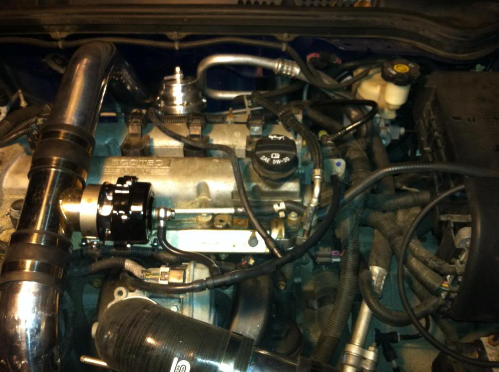

Old Nov 30, 2012 | 04:37 AM
  #225
NICOMAN's Avatar
Joined: 09-05-11
Posts: 252
From: long island
heres the piping i put together ..had to do alot of cutting and what not but it was fun ..and please take a look at how i ran my vacuum lines..i honestly just did what i thought maid sense mechanically ..oh and boost gauge ..t off b4 the bov?
