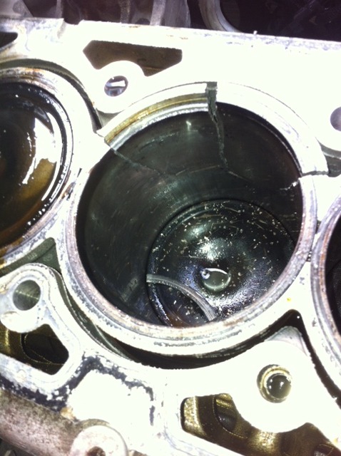

Well as a lot of you know on October 6th I blew my motor. I popped it a week before I was supposed to hit the rollers but ran a 12.8@112 with a 2.0 60ft at the track. If you want to know my mods just click on my car under my username. I've been thowing around a lot if I should upgrade my sleeves or not but after talking to a few heavy hitters on here, one being ZZP I'm just going to stick with the stock sleeves. I need to keep this build on a budget if it's going to be turn key for spring. Zrated89 got in contact with me and has a block that's perfect condition and ready for pistons. I'm going to take it off his hands. So here's whats in store:
- Diamond pistons 9.5:1 stock bore
- Neutral balance shafts
- 82lb valve springs
- Ported head by euthanasia
- ZZP stage 2 cams
- ARP head studs
- Cometic head gasket
- Fresh rod bearings
- More meth?
- Pulley down?
I got my Visa warmed up and ready for Black Friday lol. Hopefully I can pick up some of the stuff I need for my build at a good price. I'll update as I go. But let's start this thread off with a bang! Literally haha.

i saw ur mods curious on what u think made ur sleeve crack?
tune or lack of meth?
Old Nov 16, 2012 | 12:27 AM
Bluelightning's Avatar
Got Bewst?
Joined: 03-16-10
Posts: 10,948
Likes: 33
From: Winnipeg, Manitoba
Heavy detonation lol

mmake sure the piston to wall clearance is spot on or you will be back to square one
