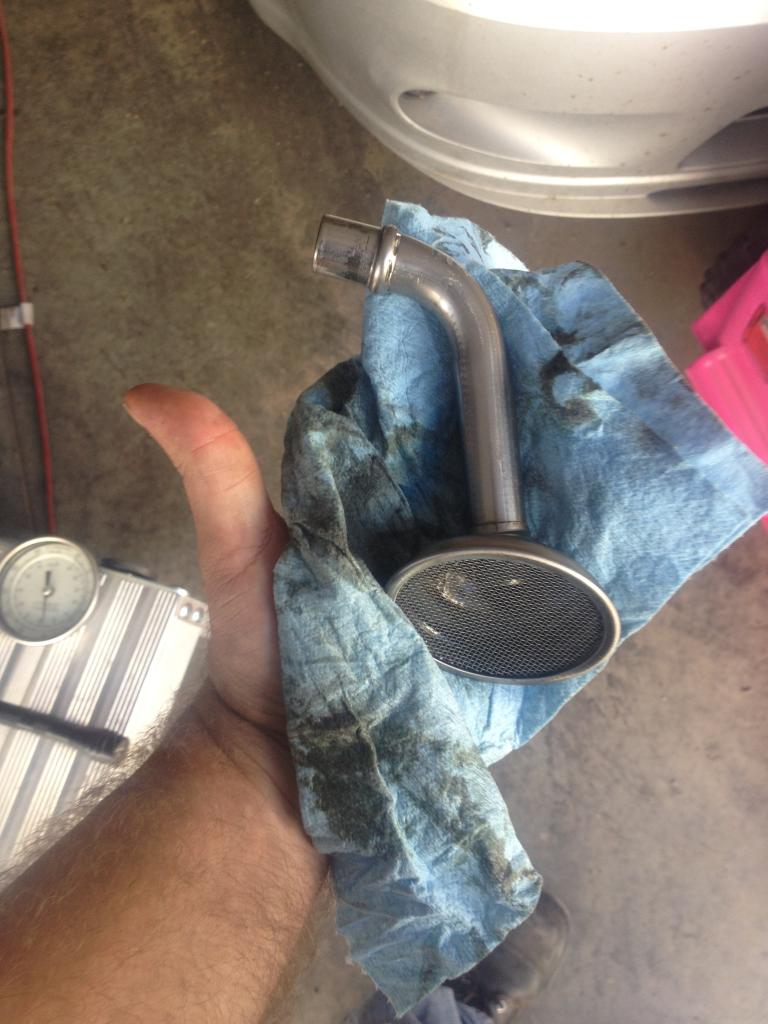

Apparently the gas isn't a switch anymore. It's now a adjustable dimmer.Name:  EAB4C0B2-2292-40C6-8D86-6F5897DE901C_zpsfkadqx70.jpg
Guess who was lounging around in the bottom of the oil pan not doing what they were supposed to be doing??

that part is a slacker and should be fired.

So this should be a good learning experience. Gotta pull the oil pump to install the screen and pick up. They are a press/hammer fit so I would suspect that the stock pump and tube got put in when my motor was rebuilt 3 years ago. I'd say it either came loose on install or was installed back in to the pump. So looks like I may be installing a new pump if the tube doesn't go back into the hole and fit tight

Get it set right bring it by I'll weld it that's what racers do

That's what everyone and even the melling video I watched said to do. I just outta get some 2x4's an I'll be set to get that rodeo under way
