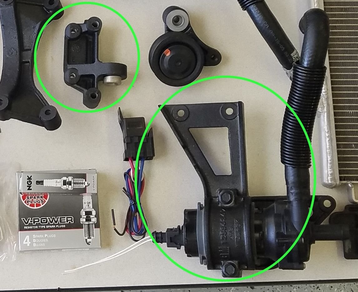

when you run the spacer how does the bottom of the intake manifold bolt onto that bracket??? do they provide a piece to put in there?
That big bolt that goes through the manifold and to the ic pump bracket?
yea, wouldn't that not bolt up because it should be a few inches further out?

I don’t have that bolt. None of our cars keep that bolt lol

hm back in the day when i wasn't getting so old i would've just said f it with that bolt but that whole intake manifold w/ sc is pretty heavy i mean they put it there for a reason
i guess it doesn't make a big diff if you guys havent' had a problem without it

there are 3 spacers that space the 2 bolts on that bracket and the and the pump bracket to oil pan bolt
so when you guy it all from zzp they give you those spacers?

yes

it comes with the phen spacer, 2 gaskets, longer bolts, and 3 spacers for the lower brackets. basically thick washers

I don't even have the bottom bracket as ZZP doesn't provide it with their SC kit and they claim you don't need it. Places more stress on the top manifold to head bolts but must not be enough to cause it to leak or anything.

WHIch bracket?
The bottom bracket that bolts to the block and the bottom of the intake manifold. I think it may also be part of the IC pump holder but not sure.

Oh ya it is. I have that.

I don't see that in the ZZP kit. I found it easier to just get what you need all at once from Jerry and for less $$
