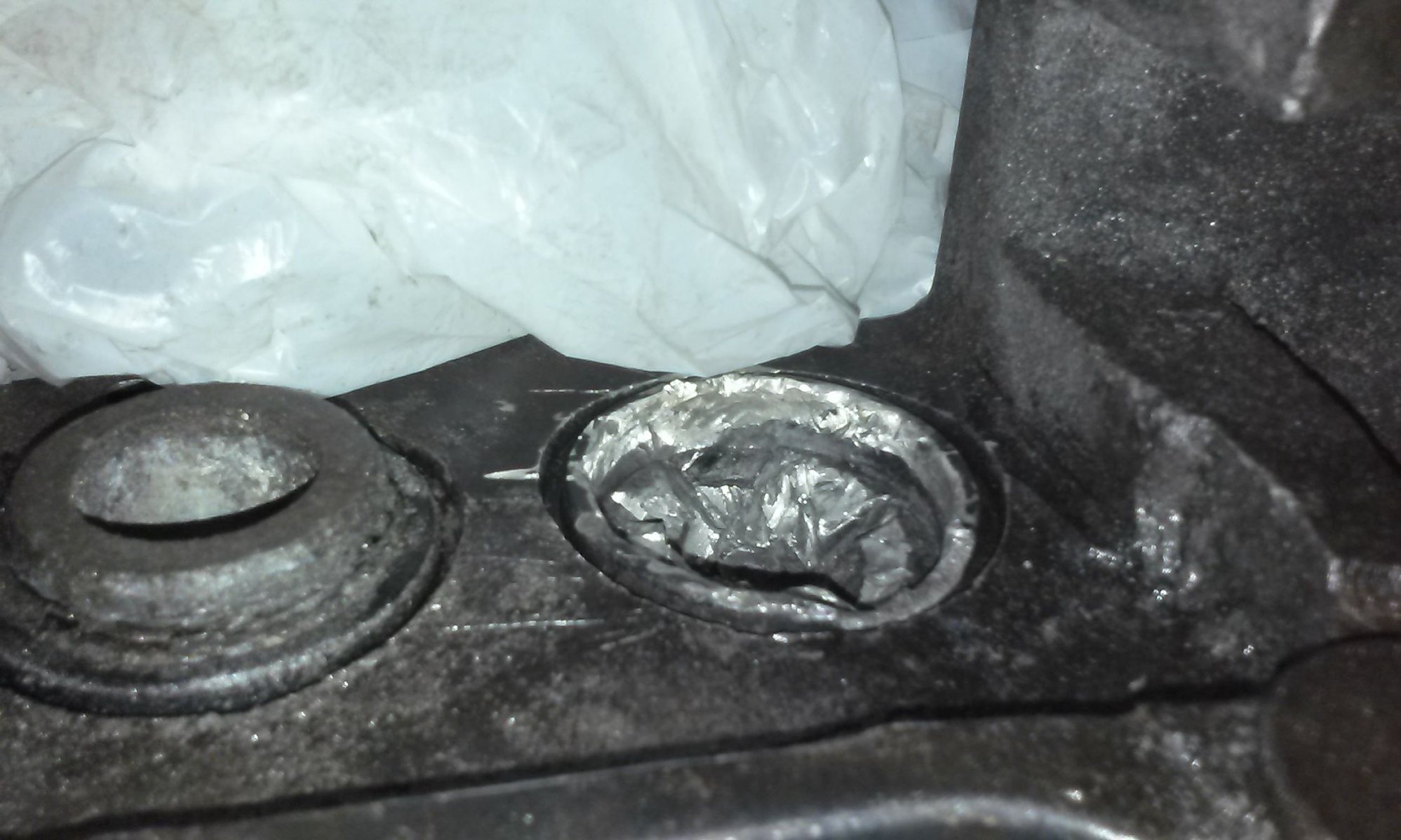

Cracked my block
What.. how?

What.. how?
Its easy really, twincharge a stock le5.
Yeah, yeah, that will do it. Time to build it to handle it. Then you can also run nitrous.

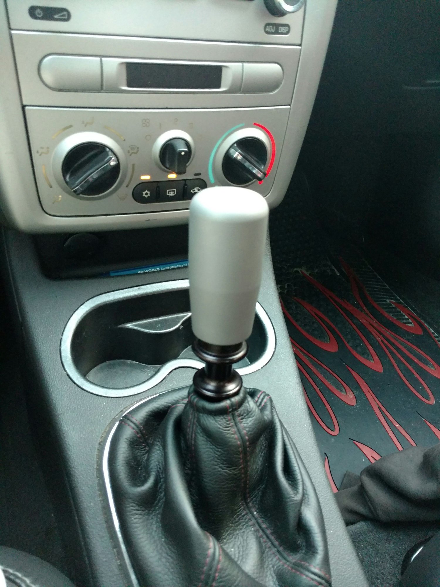

I got my custom shift knob back today from LFU Engineering modified to fit the Cobalt. I originally had them make it for my Z31 but since it is down until further notice I decided I wanted it on the Cobalt. It is made from billet 6AL4V Titanium, it was a $150 piece of stock. None of that "titanium" garbage other knob makers use lol. It is also weighted since titanium is ridiculously light. After weighting weighs 1lb 7oz. Feels so much nicer than the B&M knob. I'm still deciding on whether I want to laser etch it or not.

I have to ask, if you added weight why did you use Ti? Looks?

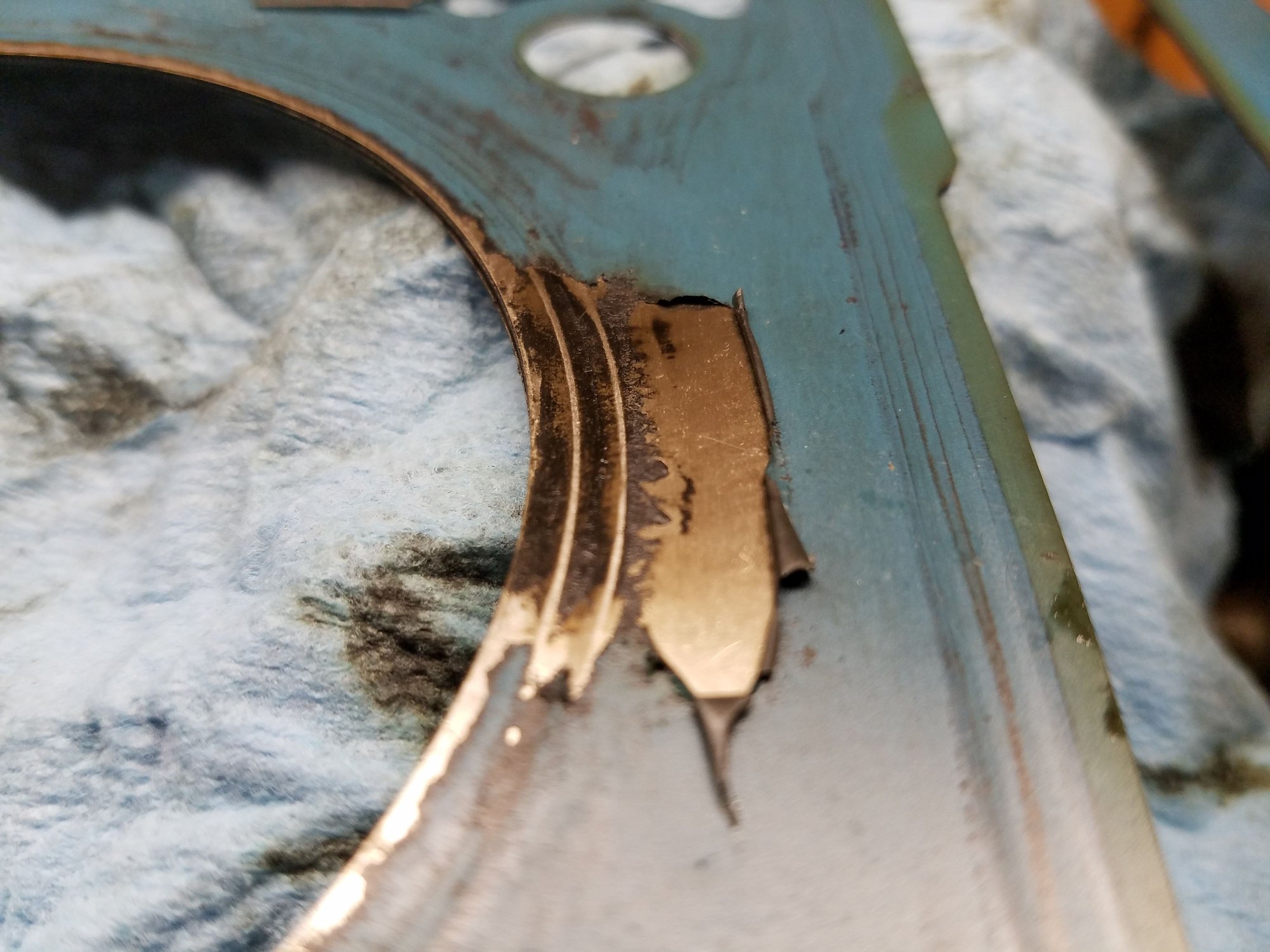

Discovered why I had low compression in cylinder 1.
The next head gasket a install will be an LSJ OEM.

I love feel and look of the metal. And really because I could, as far as I know I'm the only Z/Cobalt owner with a billet Ti knob lol. Also it's thermal conductivity. Titanium does not like to absorb heat, or shed it once it gets hot. In the summer here in Florida aluminum and stainless knobs get ridiculously hot. The titanium stays quite a bit cooler.

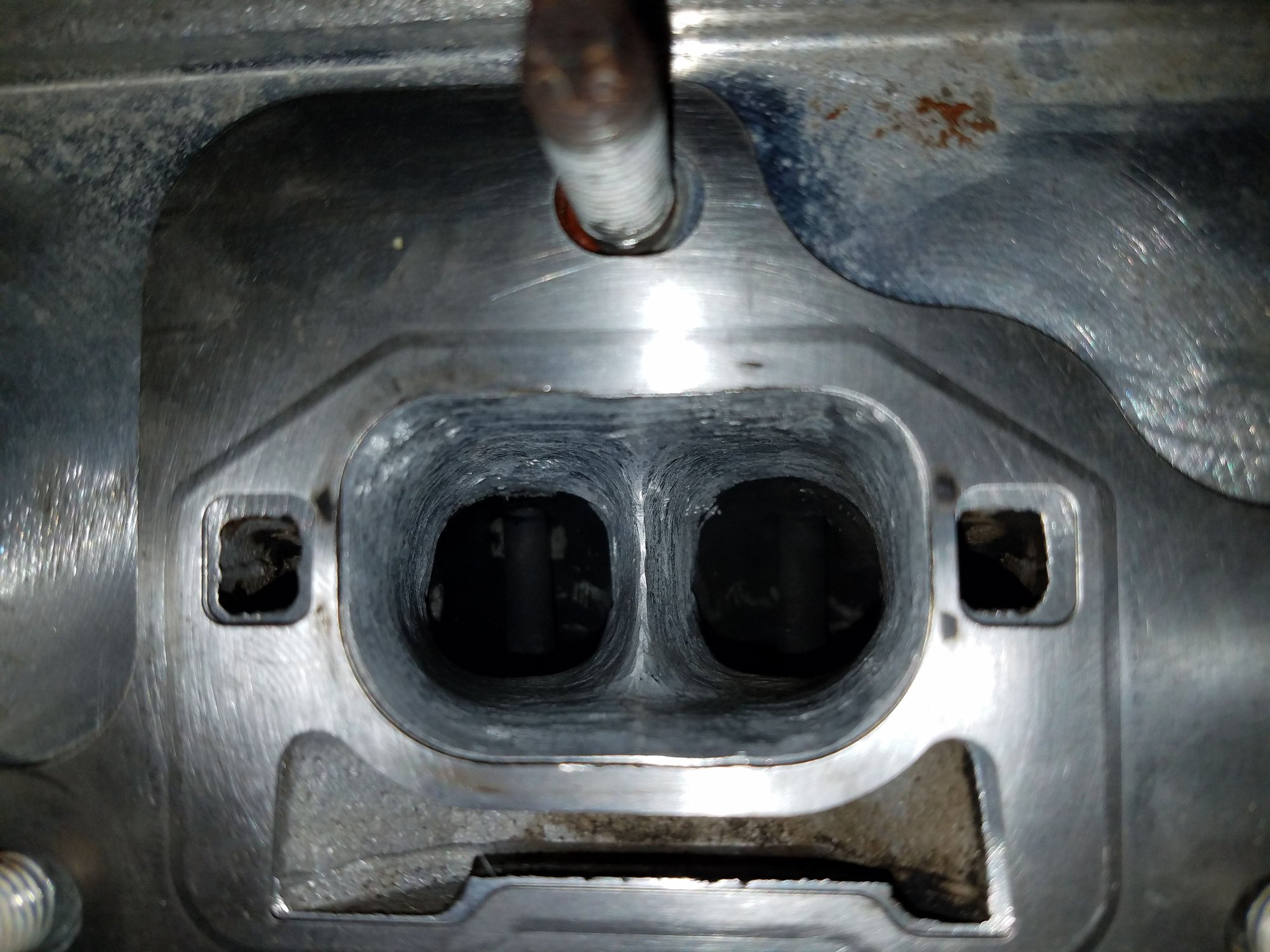

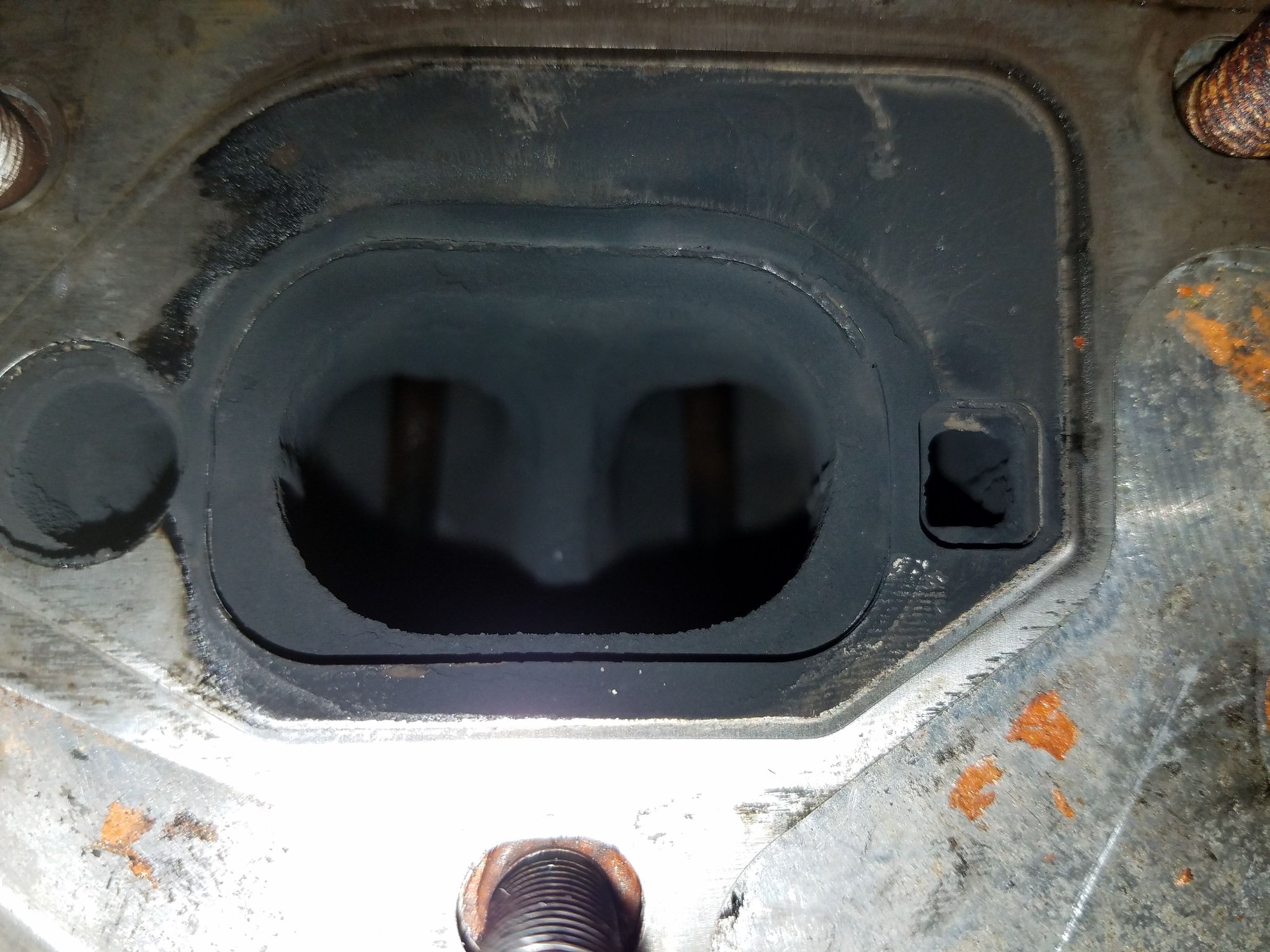

Got my head back from the machine shop today. Happy they were able to open up the exhaust ports so much. This should be a significant improvement. I am excited to get it all back together.
Before I had the exhaust ports machined out they are highly restrictive on the L61.
After port job. I think I may go in with a Dremel with a sanding attachment and clean up the mill marks a bit. Either way it should be able to breath a LOT better and let the engine run a little healthier.

what manufacturer was that HG?

fel-pro

He's the one I was recalling see no Fel-Pro for cobalts

Yep, theres a reason we call them fail-pro in the Subaru world. Was just wondering what gasket failed

Yeah I have had my head surface checked out and it is fine. I also torqued the head studs according to the method listed in the performance build book. That really leaves me with nothing to blame but the gasket.
I am using an LSJ gasket this time around.

same thing we call them in the z31 world. Stock head gaskets and Victor Reinz will do 600+whp, felpro's blow with anything more than 14psi of boost no matter the power

Are they polishing the ports? Sorry for the stupid question but you never know.....
Congrats on the port job.
