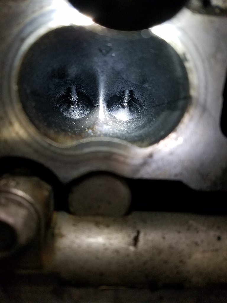

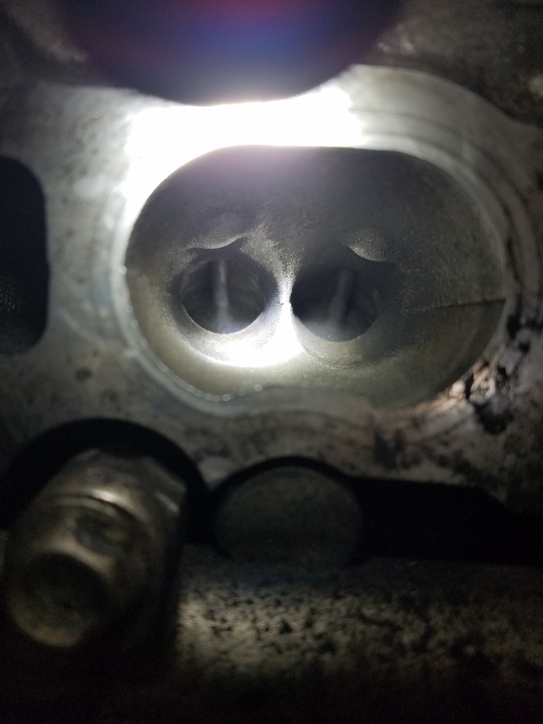

Finally cleaned my valves. Runs a lot smoother now. Just used throttle body cleaner and various picks and brushes. Took maybe 30 mins per set of valves. Didnt do an amazing job but definitely an improvement.

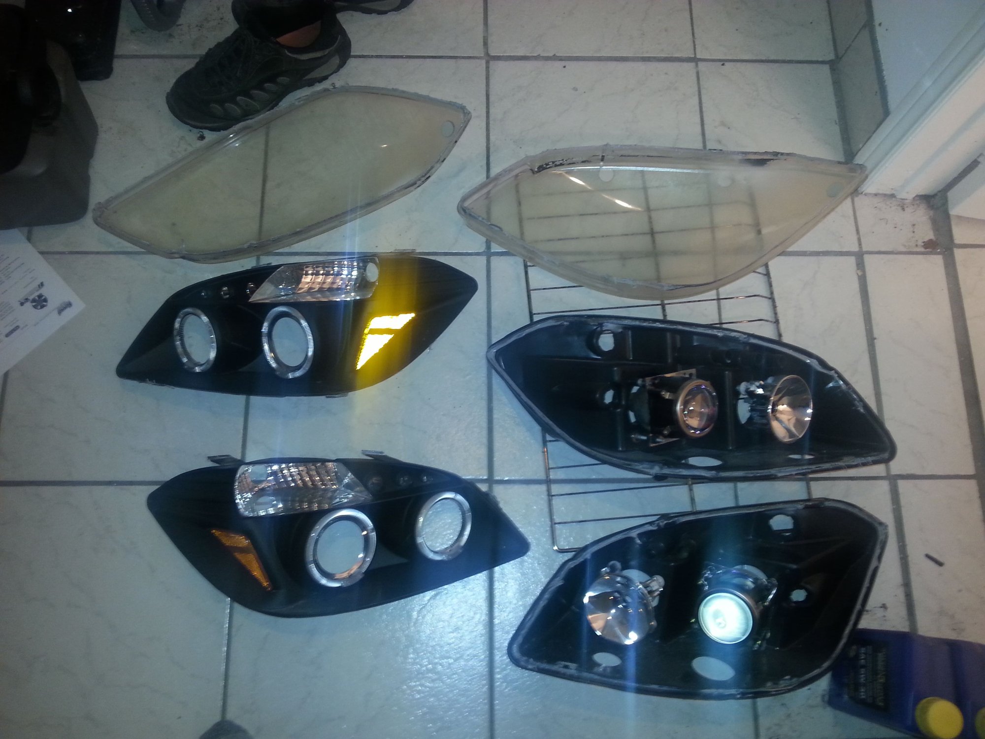

I got a new hood, traded my OEM style CF hood for this one. Traded with another member, don't know his screen name though. He found me on kijiji, I have an add up looking for some parts so I can send them for powder coat without having the car down for a week.

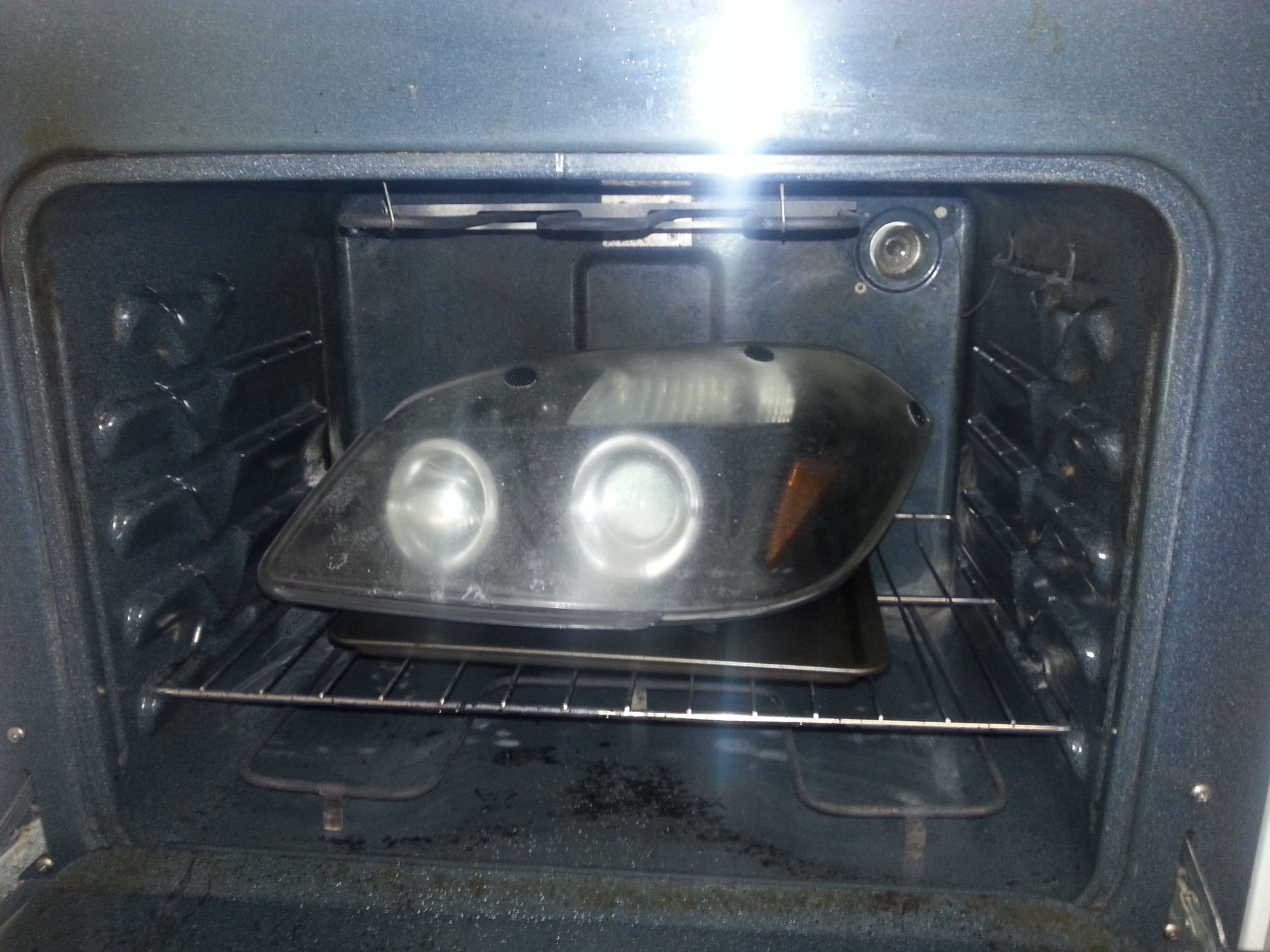

Then I took off my headlights to tear them apart and rebuild them.
I'm going to order all new LEDs for them and have the inserts done to match the color I'm getting the car wrapped in June. Satin Pearl White

Since you are doing all that work, you should have just retrofit some stockers. Those projectors arent worth the time.

I'm not a fan of the stock lights lay out. I'd rather put new projectors in these headlights. I hadn't thought of it though. Honestly hadn't noticed any issues with these projectors. Before the lens fogged up they were nice and bright and have a pretty clean cut off. (I do have HIDs in them)
I've had a look through some of the retro threads. I'm not putting anywhere near that work into these. I'm not cutting and drilling and pasting, I'm just replacing LEDs and getting the inside wrapped. I may drill a hole or two in the bottom of the projectors to put some LEDs in there too.
The most work I'll have into these are polishing the lenses, but if I picked up a set of stockers at the wreckers (like whats in the car now) to retro, I'd have to polish those lenses anyway. These are the lights I bought the car with.

FYI retrofitting Gen 1 projectors is a bitch. but worth it

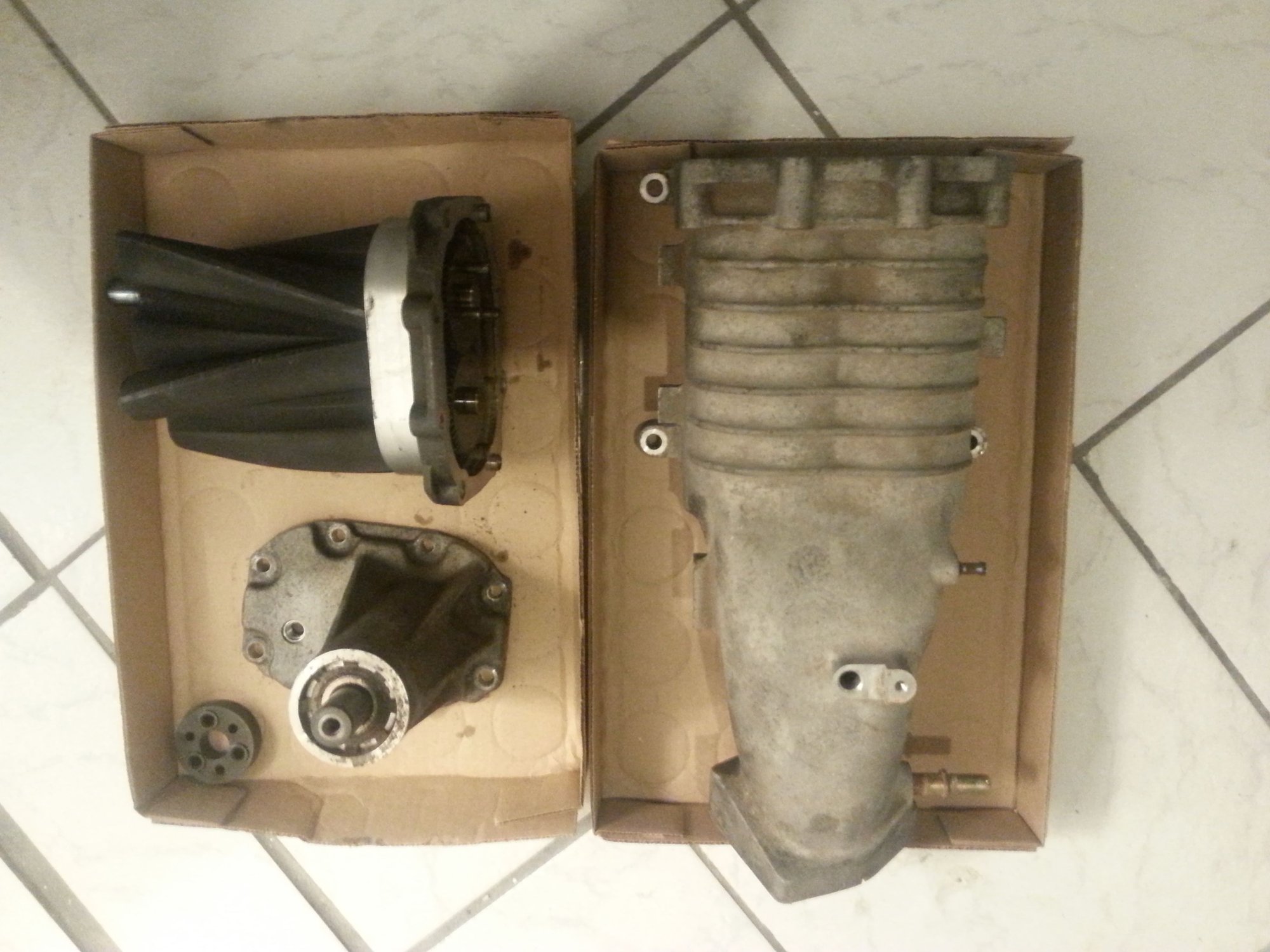

Laminovas and a fuel rail all cleaned up.
SC nearly all blown apart. Just have to get to a press to pull the shaft and bearings out of the snout
A couple minor scratches, but they are in better shape than the ones on the car now.
Needle bearing grease looks pretty new. I'm going to clean them of the grease and leave them in there. Hopefully the powder coating process doesn't hurt them. Worst case scenario I have to replace them later
Are those 2 circles timing marks? should they line up? If its fine the way it is then I'll likely just paint the plate a contrasting color to the powder coat, rather than take the rotors off.
Now I just have to wait for my powder coat guy to get back from vacation later this month.

Looks good man! Hats off to you for deciding to tackle the job. It's not a hard task, just time consuming.
