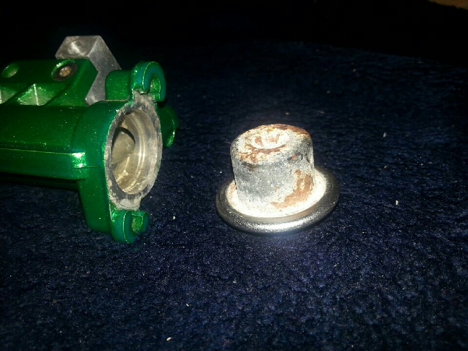

You mean in this part? I could tell there was something inside here, so it didn't get powdercoated. The one currently on the car is in better shape, so I'll be using it instead.

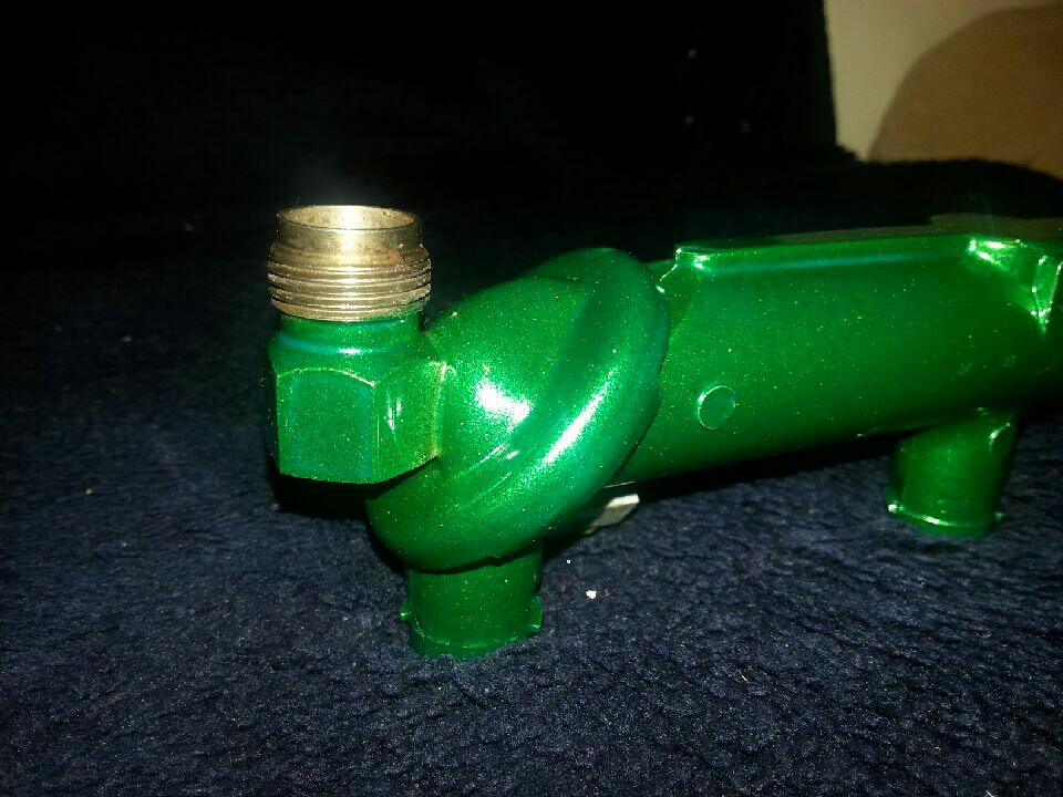

Or in this part? This end I couldn't get a good read on what is in there. All I could make out was a baffle, I'm guessing to stop the first injector to get a blast of fuel.

The top one is the fuel pressure regulator cartridge. That definitely has to be removed.
The bottom pic (unless they removed it and didn't change the tooling of the bulge) had a rubber diaphragm there that served as the pulsator.
