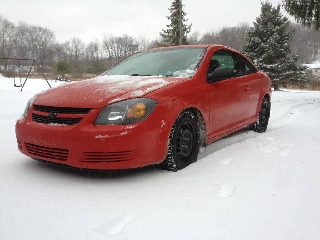

I have an 09 base model like yours. When I bought my first set of H&Rs it sat raked as hell like you're describing. Then I ordered the ones Metallic mentioned and the back dropped a lot. Still have to do the fronts.
The measurements online are misleading because they are based off of the stock heights of SS and base cars, which differ in stock form.
Trust me when I say the 50735-2 numbered springs will bring the ass end down.
First set of H&RS
Rears from the second set installed. Still have to put in the fronts.
