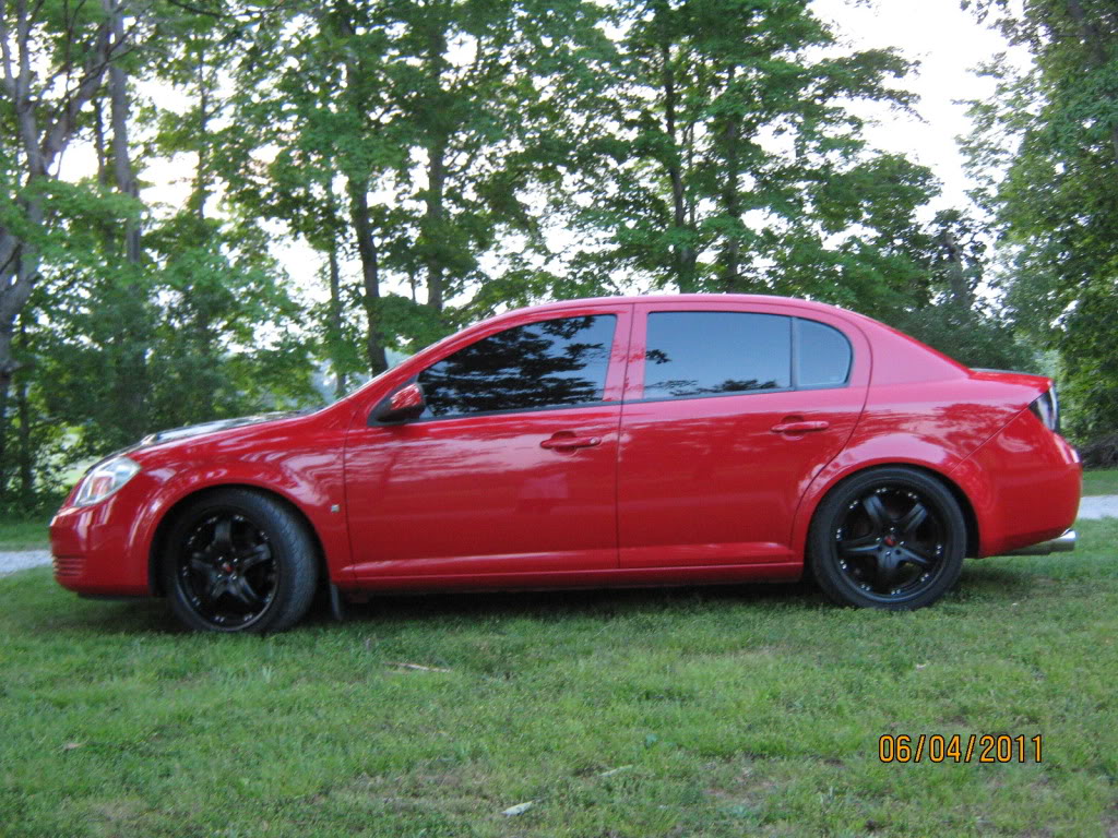

Had mine on for about 3 years and no problems
