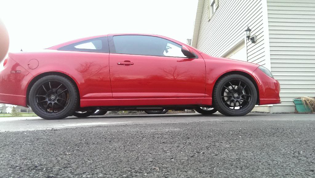

That's not true he could spend the money on YYZ springs will have great handling but only be this low.
