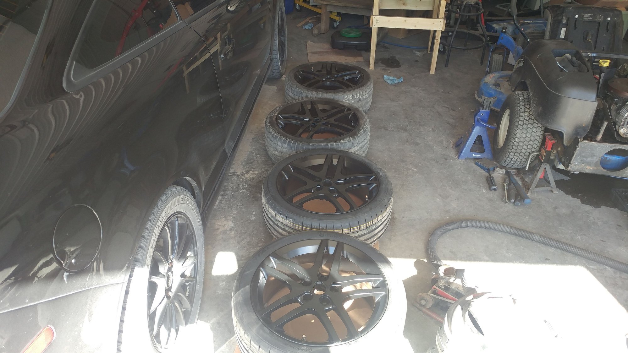

Too finish her off

How much for the jack stands? Are you parting out the lawnmower? Need a seat.
Glad to see you are back to liquefying tires. What are you gonna do with 2nd gear? Upgrade tires?
