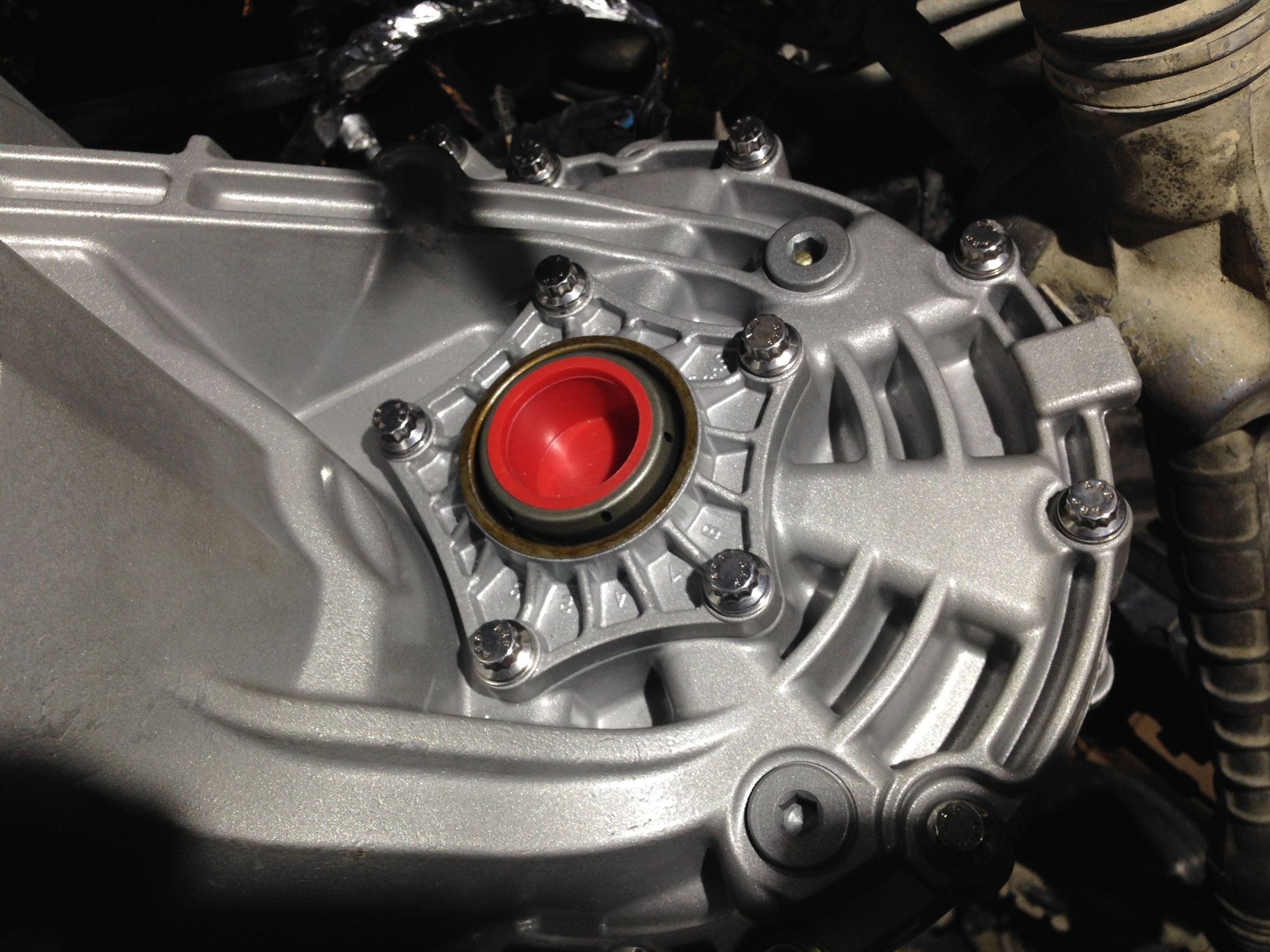

Old Apr 1, 2018 | 09:08 PM
  #698
tomj77's Avatar
Joined: 07-14-08
Posts: 12,039
Likes: 156
From: canada
  #699
tomj77's Avatar
Joined: 07-14-08
Posts: 12,039
Likes: 156
From: canada
New exedy hyper single installed
Old Apr 1, 2018 | 09:09 PM
  #700
tomj77's Avatar
Joined: 07-14-08
Posts: 12,039
Likes: 156
From: canada
Trans installed
