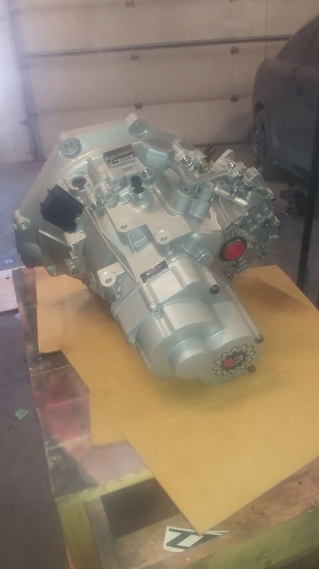

Old Mar 17, 2018 | 02:12 PM
  #665
tomj77's Avatar
Joined: 07-14-08
Posts: 12,039
Likes: 156
From: canada
Old Mar 17, 2018 | 02:32 PM
  #666
63 Nova SS's Avatar
Joined: 06-12-12
Posts: 5,466
Likes: 316
6 speed quaffe, I envy you. Looks nice

now I have to solve the issue of my clutch disk doesn't want to slide onto the input shaft. guess whatever treating they did made it slightly out of spec for the clutch disks. ****.....
Old Mar 18, 2018 | 09:14 AM
  #669
LNFwagonSS's Avatar
Joined: 06-05-12
Posts: 700
Likes: 24
From: Omaha
That is the fault of poor quality control of the exedy discs used in zzp SB clutches. Does it even on new stock f35 input. The tolerance on those Quaife parts are within spec i assure you.

That is a thing of beauty! I would love to have a Quaife 6 speed one day, if they are still around. I just discovered yesterday I'm going to need to do rocker panel repair and it's just really hard for me to justify a trans that would cost more then what my car is worth. But the peace of mind for the strength is very tempting. And having a usable 1st gear as well as the improved overdrive due to not having to use 4.45 gears would be a dream. Uses less power then the F40 too. Great, I'm talking myself into it again even now. Do you or Jason know of anyone else using this gearset now? I've seen them forever but havent heard of anyone else that used one.
Old Mar 18, 2018 | 11:45 AM
  #672
63 Nova SS's Avatar
Joined: 06-12-12
Posts: 5,466
Likes: 316
I believe Jason will and Mr Powell also. There were only a few kits left last time I looked. May not be any at this point.
Old Mar 18, 2018 | 02:02 PM
  #673
LNFwagonSS's Avatar
Joined: 06-05-12
Posts: 700
Likes: 24
From: Omaha
Yea the kits are officially gone/spoken for. I have a pile if them here in my shop. There were 9 kits left when i built my first one for Powell in August. There were 30 kits manufactured back in 2005. To put that in perspective, it took 12 years to sell the 21 of those kits. Took me 6-7 months to influence the sale of 9 kits. These kits are were so under rated. Quaife didnt just throw an extra gear in there and call it good. They redesigned the whole gear set in a way to prevent premature wear, promote better oil distribution and oil retention in places that desperately needed it. 2nd gear has more support on the output because it floats on a sleeved needle bearing now rather than a bushing that wears out. And then the end cap has a gigantic cylindrical roller bearing on the output side as well as another roller bearing on the input side to keep the shafts together up top. Then the cap is dowel fastened to the case which takes a ridiculous amount of precision to reproduce within tolerance for each kit to make the cap an effective structural peice of the case in respect to shaft location retention. Hats off to Quaife for this brialliant redesign. As far as the future of aftermarket gear kits, well,
