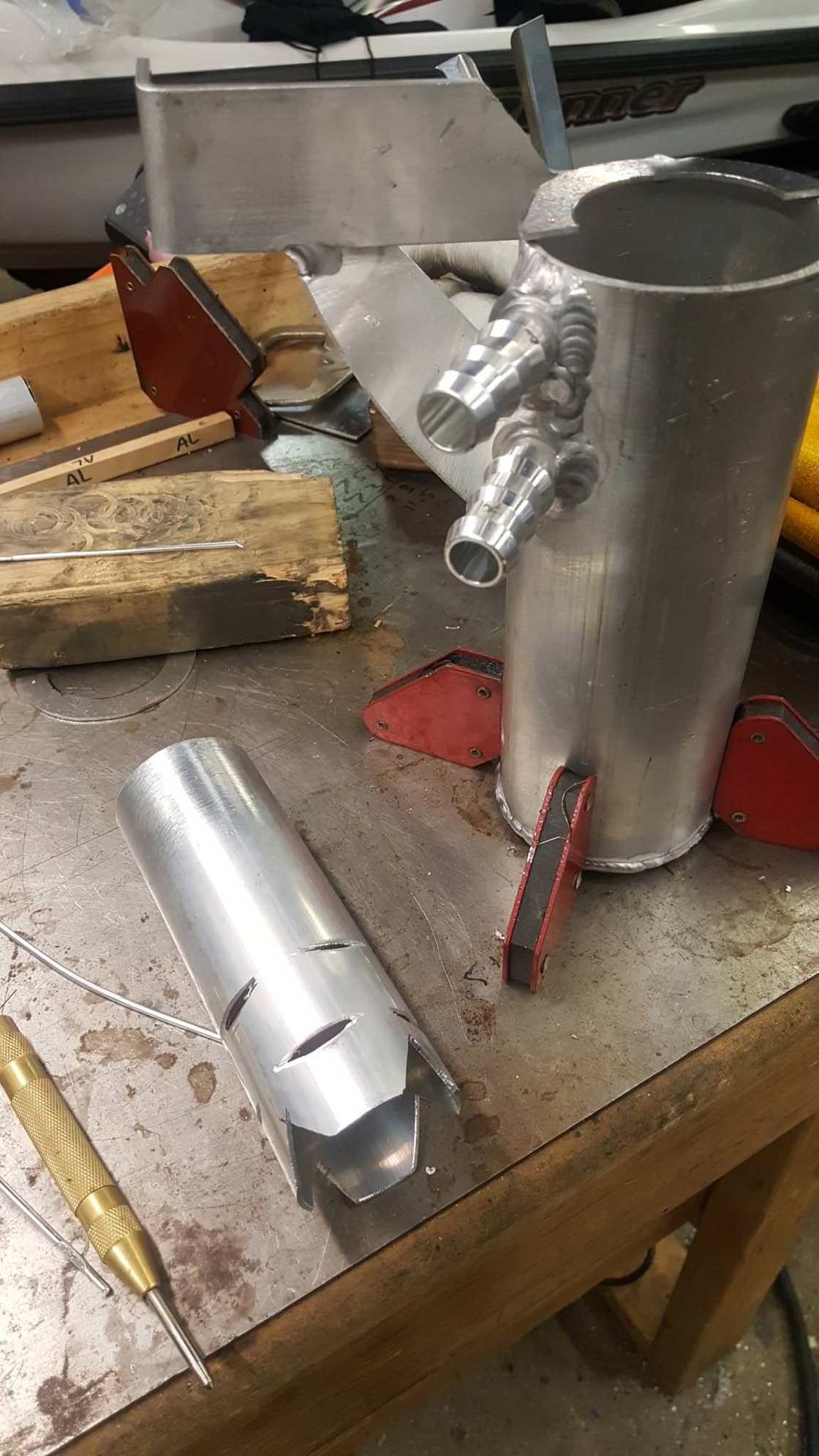

A little catch can system update. Well its done but I still gotta do some testing under boost. I installed a boost gauge to crank case via the port on my old oil sperator dipstick oil drain back, and at idle instead of getting positive pressure I now get -1 vac. It holds stead and does not fluctuate. So solved that issue.
Are you using the factory PCV setup, I am just wondering how you can maintain crankcase vacuum. Or is this just at idle? My LE5 build has major blowby, haven't determined if that was the builders fault though (ehem). I custom built a large can, it catches excessive amounts of crap (I removed the factory baffling though), so I had to add a pre-baffle to help drain the crap back into the engine to be cooked again. I also welded a 5/8" barb to the valve cover in addition to using the factory port.
More pictures here: Twincharged Solstice = Turbocharger + Supercharger
nope. I made a custom 2 can setup with external pcv valve . works like stock but is external and routed though catch can. It should be in previous pages of the thread. I have yet to twst under driving and boost. Next month when i register car for summer
