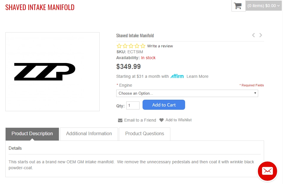

Lookie what i finded lol. Sounds strikingly similar to mine :P Although I'm sure I'm not the only person to have done that to the intake manifold.
